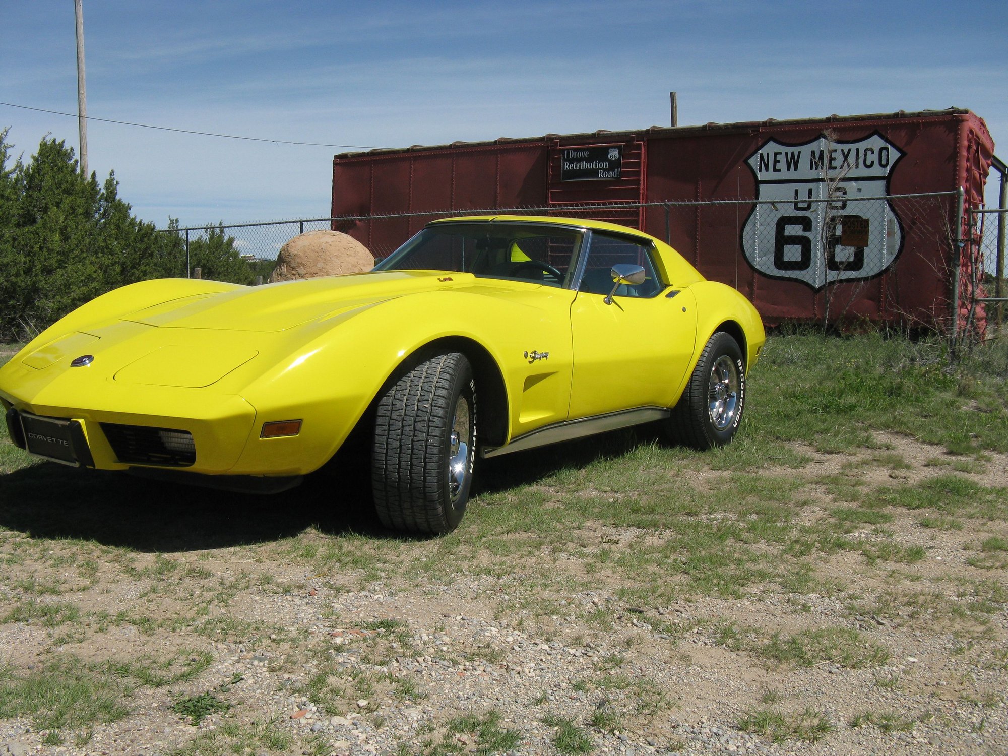

2024 C1 of the Year Finalist - Modified
I just purchased new BFG's...255/60 15. The ones on the car are 20 years old, Dangerous! These fit nice, no rub anywhere and are beefy looking.
