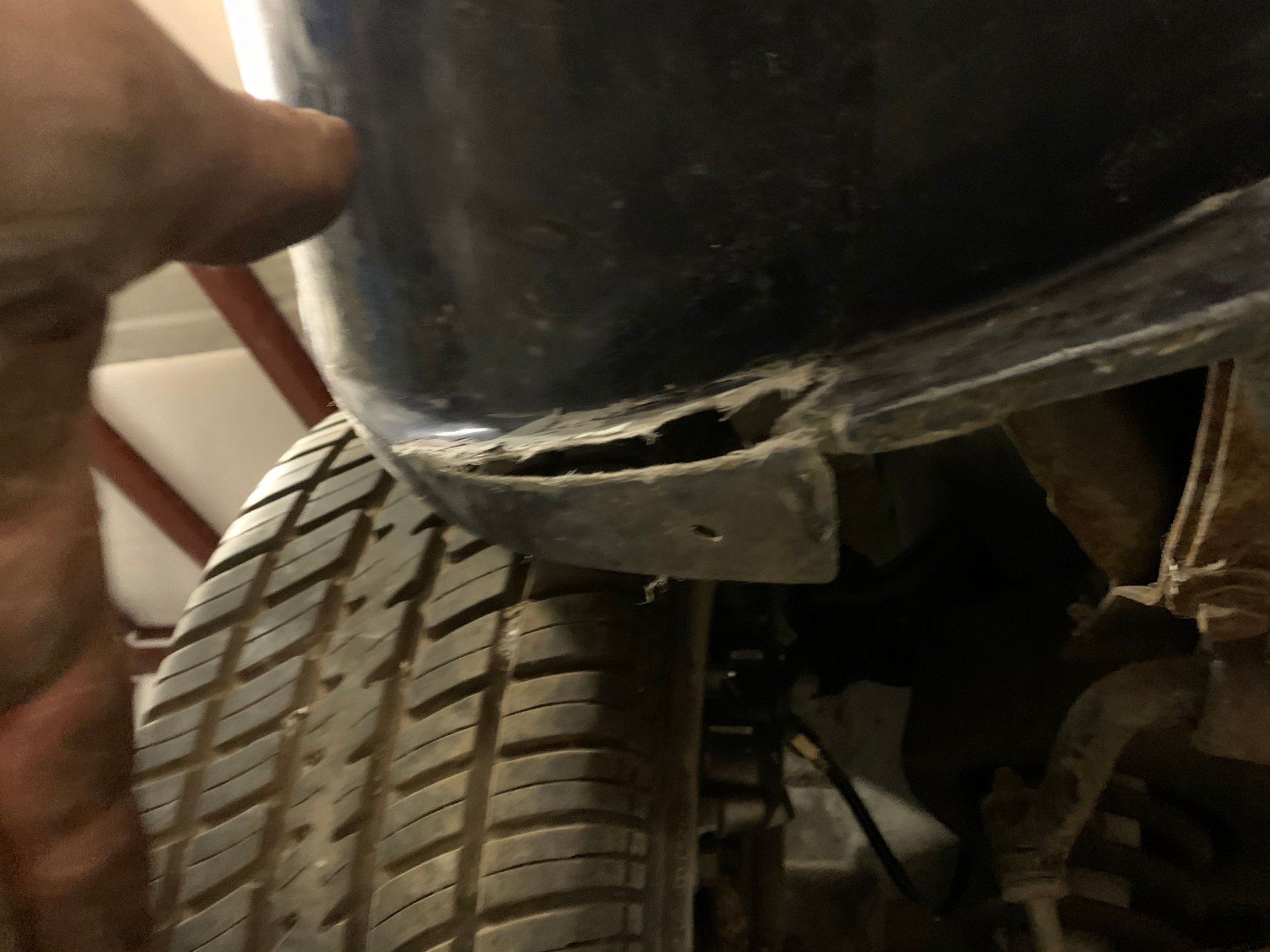

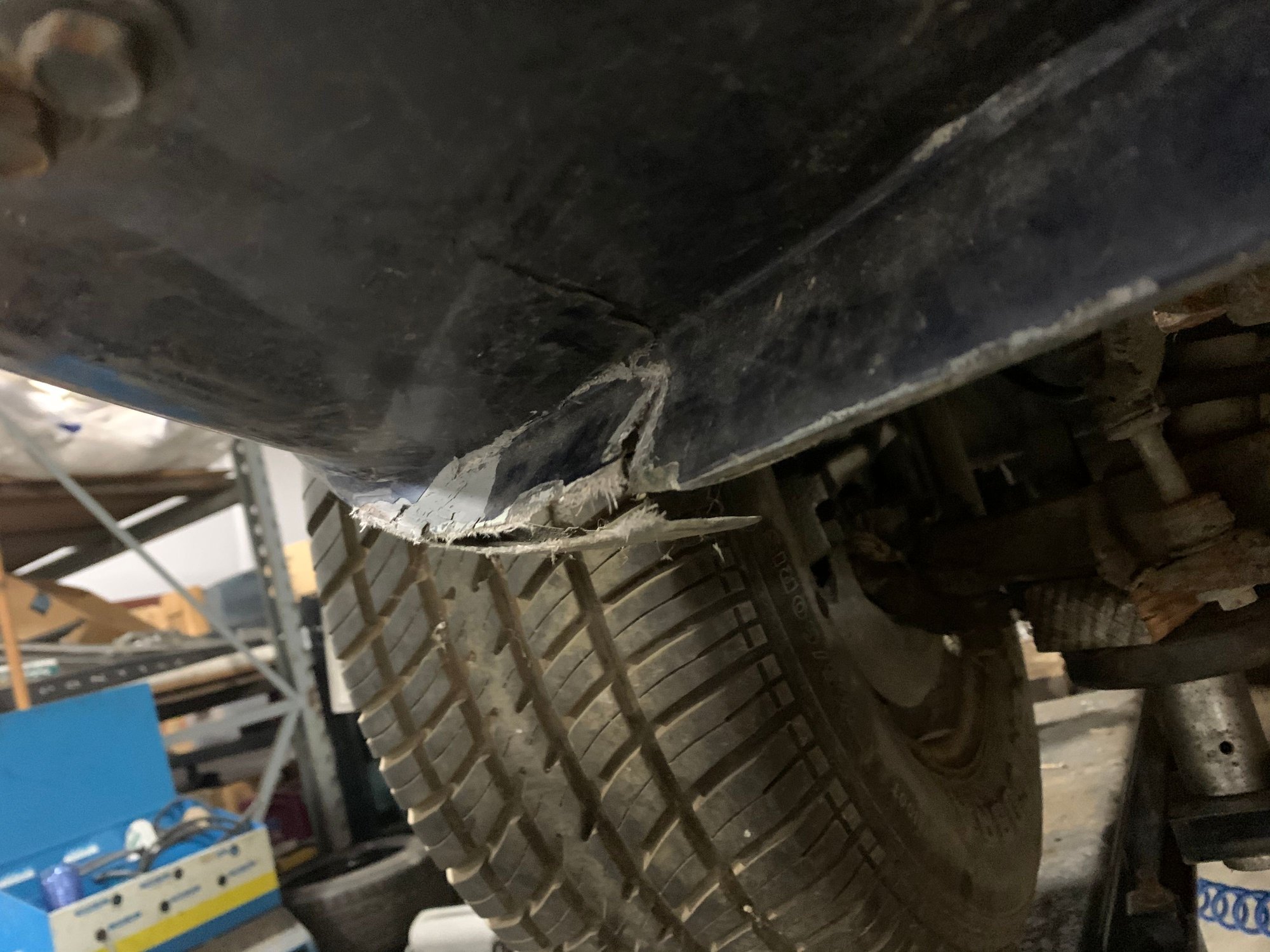

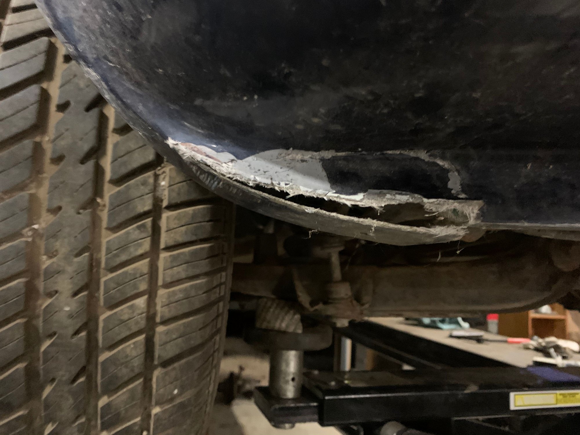

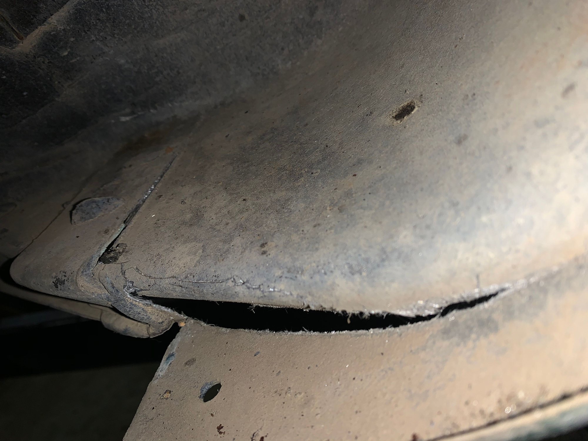

Just looking for tips and ideas on how to fix this. Can it be repaired or will I have to cut out a the section and patch it.

Sure. There are 3 ways to skin every cat. I'll give you my suggestions, I'm sure others will pipe in.
1) Pull the 'wound' back in position as close as best you can get it. Use masking tape to hold the pieces together as tight and close together as possible. In other words, 'close the wound' ...and put masking tape along the bottom edge.
2) Mix up some clear 2-component epoxy (just the hardware store stuff) and daub it from the inside on the joint with a small stick or brush. Get as much in the 'wound' ...if you will, as you can. The purpose of this step isn't to make a final fix, it's to *hold* it all together so you can grind on it and perform the later repairs I'm going to suggest below. The masking tape will hold the gap closed and also prevent the epoxy from running out. Wipe clean the inside lip to remove excess epoxy (to save clean-up on the inside). Let the epoxy sit until the epoxy is fully cured before pulling off the masking tape.
3) Remove the masking tape. Take a grinder or even a grinding wheel on a drill, and gently "v" out the wound and places where the fiberglass is or was cracked or damaged. I suggest using a course wheel over the 'wounded' area to give the new repair a surface to effectively 'bite' and hold onto. Carefully remove the paint down to fiberglass in the damaged area.
4) Blow off the fiberglass dust very well with compressed air (you can't do repairs over dust!). If you don't have compressed air, use canned air. You want to have a completely clean surface. If the surface isn't rough-textured, run some 36 grit sandpaper over the V'd out areas .... and blow the dust off again.
5) Cut some random oriented strand fiberglass matt. Cut a few narrower sections that will fit into the V'd out area you ground down and some wider pieces too. You'll need several pieces as you will want to layer the pieces on top of each other from narrow to wider.
6) Mix up some more 2-part clear epoxy (slow setting) and apply it to the ground-out areas, then layer on your fiberglass pieces. Keep layering them on adding fiberglass as you need. The 'ideal' is to PRESS the fiberglass down into the epoxy as tight as you can get it. It should be 'clear' as the epoxy fills in the fiberglass matt. A tight multi-layer of fiberglass matt pieces is what gives you the most strength. It should be plenty strong afterwards.
7) Let it harden and then tool the repaired area with griders and/or sandpaper as needed. Perform normal bodywork repair. Prime and repaint.
The other (quicker and slightly weaker) alternative if you want to do a somewhat less 'professional' repair is to rough the surface up (after you've epoxied the joint shut), .....is to apply some pre-mixed fiberglass gel (with hair). There isn't a whole lot of stress down in that area and as long as you're working on fiberglass (not SMC) it should hold fine and be a lot quicker. Just be aware that if your substrate is SMC, you MUST use epoxy (not fiberglass gel). But the best and strongest repair would be what I outlined above.

Clean it well (front back and separation), glass it on the backside for support; then use some polyester body filler (or whatever you prefer that works with fiberglass) to finish the surface. Prime and paint.
