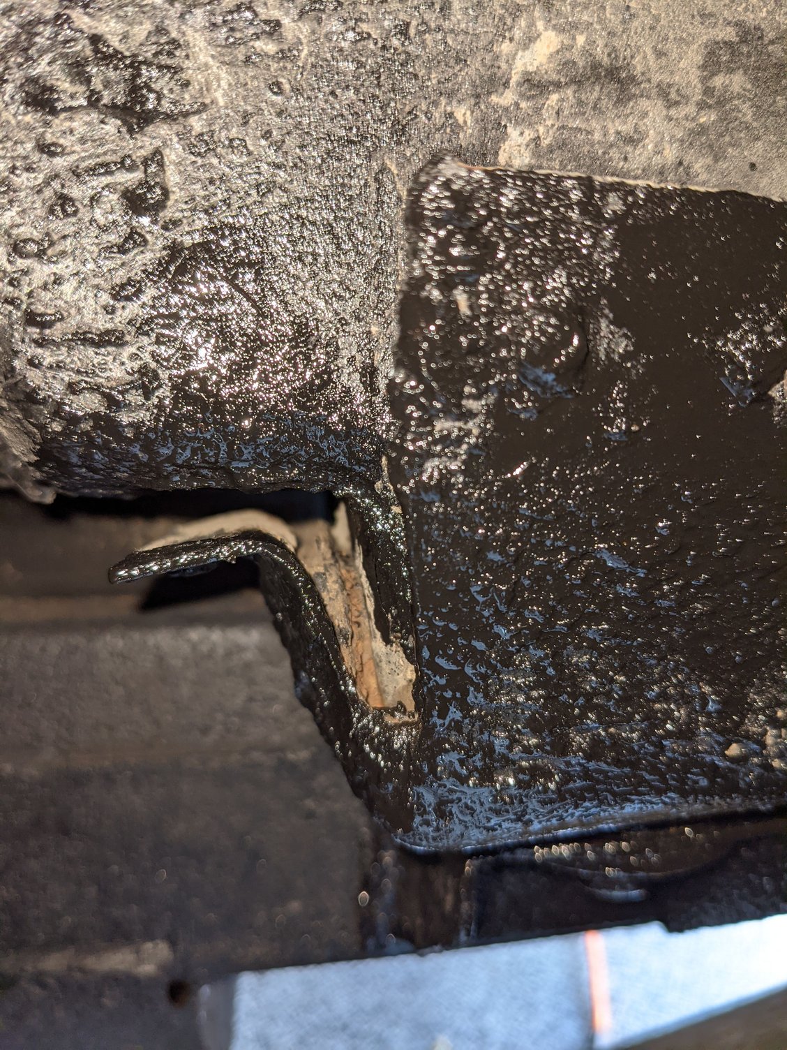

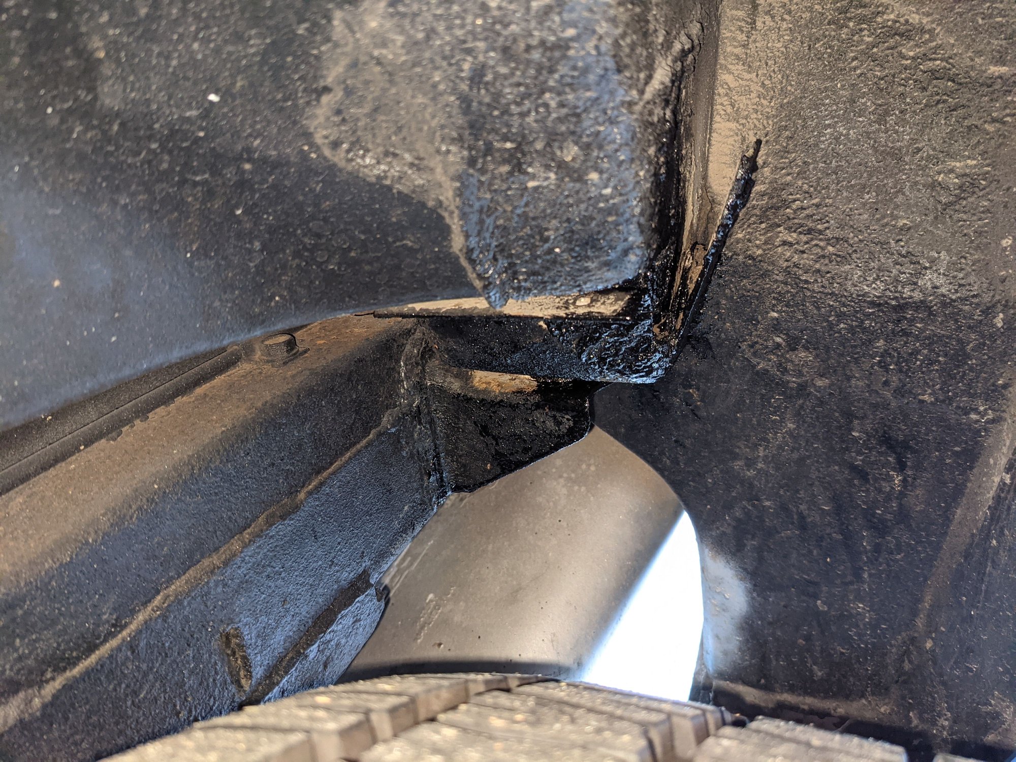

I was doing a little rust prevention on #4 body mount driver's s side and realized the flanges (both vertical and horizontal) were not attached to the "box" that comes down from top of fender (hope I am saying that right). Any ideas on how to attach these flanges to the "box"? Rivets? And what will be the challenge of working in a tight space to do this especially with the vertical flange? Thanks!!
horizontal flange
Vertical flange

They are riveted to the fiberglass underbody. Unless you are planning on a full NCRS judging, just get some 1/4” button head cap screws, nuts and washers and reattach.
