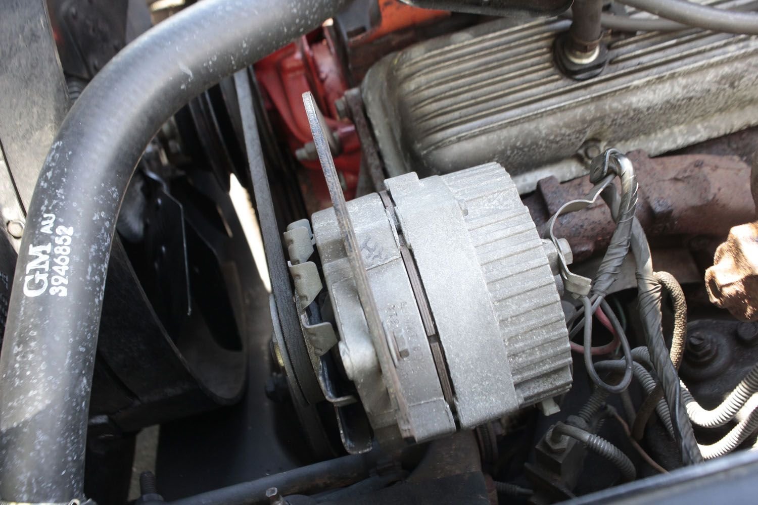

Posts: 219
Likes: 101
From: North Carolina
My engine in my 73 has never been painted or out of the car then this year I used Por 15 Chevy orange on the top half only and it matches the original bottom half well except it looks much newer that is. Yeah, the red orange is way off anything I ever saw. I replaced the original valve covers that were a little leaky but they were the same orange as the engine.

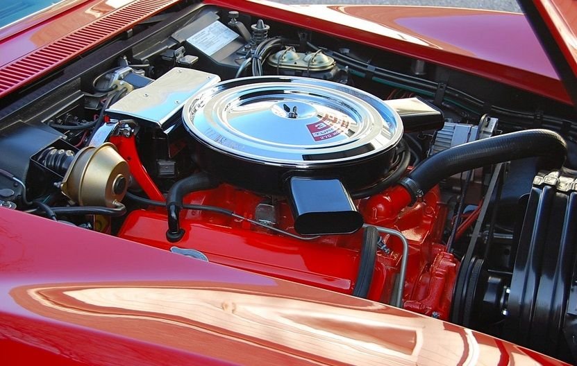

Originally Posted by Catfish4818
The 1971 base 350 had orange steel valve covers.
Correct, a 1971 base 350 would look like this:

Your alternator belt tensioning brace is in the wrong position Proactive solutions

Yes proactive your brace should be positioned like this 73.

firstgenaddict the rear of your alternator case is clocked in the wrong position

Car only has 30k miles and has never been apart was in storage since 1989 when I found it.

Rear case should be positioned like red car above
