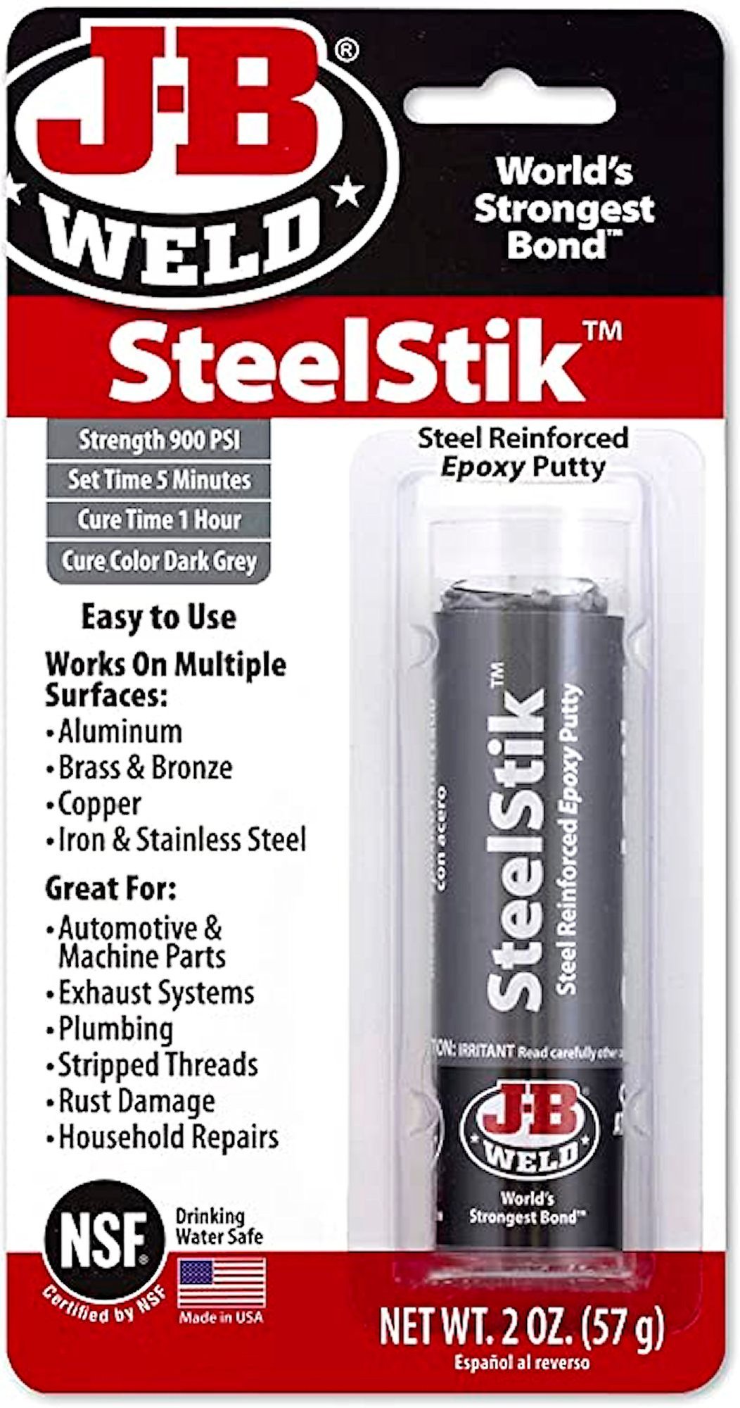

Yes, there is an excellent repair for that. JB Weld SteelStik epoxy putty (or equivalent).This will harden enough to screw tightly into. SteelStik can be molded, shaped, sanded, drilled and tapped. I use this anywhere old screw holes have been "reamed out". This stuff works on metal as well as fiberglass, plastic, or PVC.
This..
I use this all the time for various projects works GREAT !!

Fill the openings where the screw is to fit with JB Weld stick epoxy. As it is curing (cure time only five minutes after starting the mixing process), stick the end of an ice pick into the soft epoxy as a 'starter' hole for the screws you will be using. You could actually stick the screws you will be using into the epoxy, and then back them out before the epoxy cures and sticks onto them. I've done that...it works.
P.S. JB Weld stick epoxy is good stuff. But, remember that it is still only plastic once it cures. So, don't expect to put much torque on screws if the threads are in the epoxy. Just snug them down. If you need more than that level of retaining torque, epoxy some threaded metal inserts into the pads instead of just putting epoxy into them.
