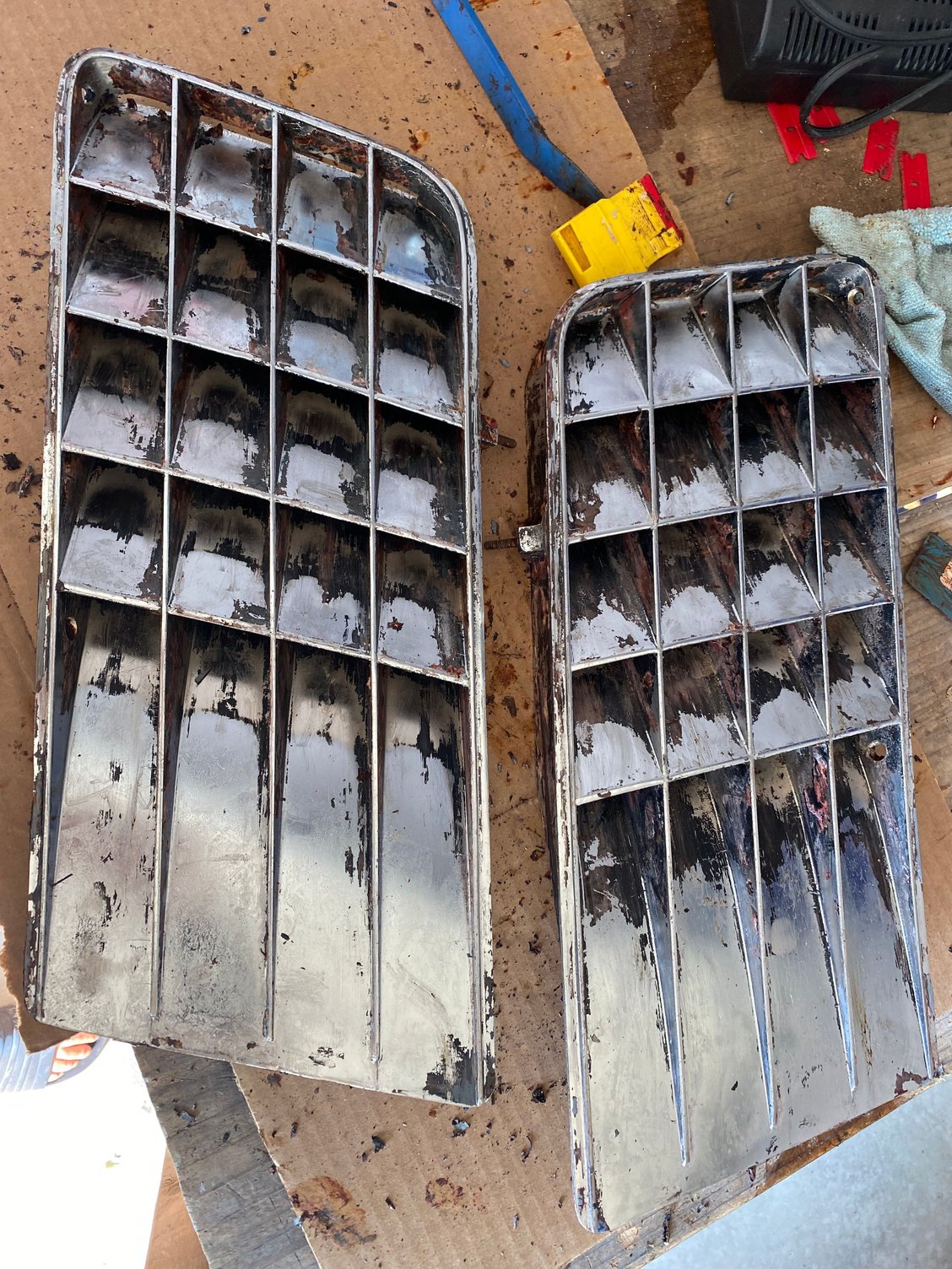

I'm looking for some better alternatives for stripping my egg crates on my 1970. I've removed them and used Aircraft Paint Remover 5 times to remove two coats of paint and primer. Some of the primer remains and the aircraft stuff, expensive as it is, doesn't seem to do anything.
Anything else work better? Can it be polished off? And why did they chrome these pieces ony to paint over them?

Mine are in good shape... I'd like to strip them and leave them all chrome, but, man, it's taking forever to remove the last of the paint/primer. 5 applications of Aircraft... this stuff is not as good as advertised. (but then again, what is?)
Any help is much appreciated.

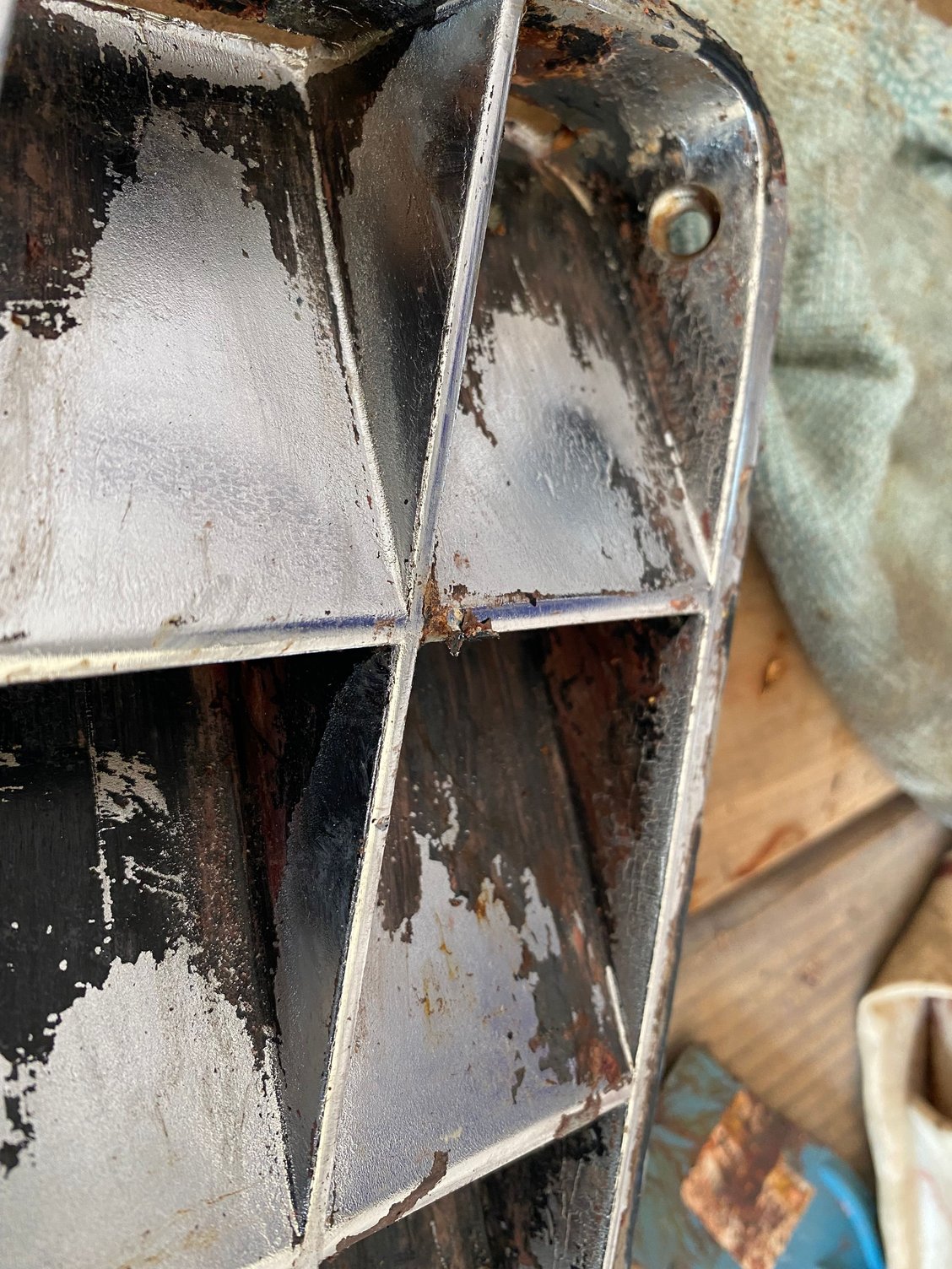

Thanks for the responses....I'll try anything, at this point. I don't want to damage the chrome, but I need to clean them up beyond how they are now. As for the kind / type of Aircraft brand paint, I couldn't tell you... I thought there was only one. It worked well in the outer layers of paint, but doesn't seem to be doing anything past that last picture. I'll try one more time and let it sit a full hour rather than the directed 45 minutes. I'll leave the crates in the sun for a while before the next attempt as well. Maybe that'll help.

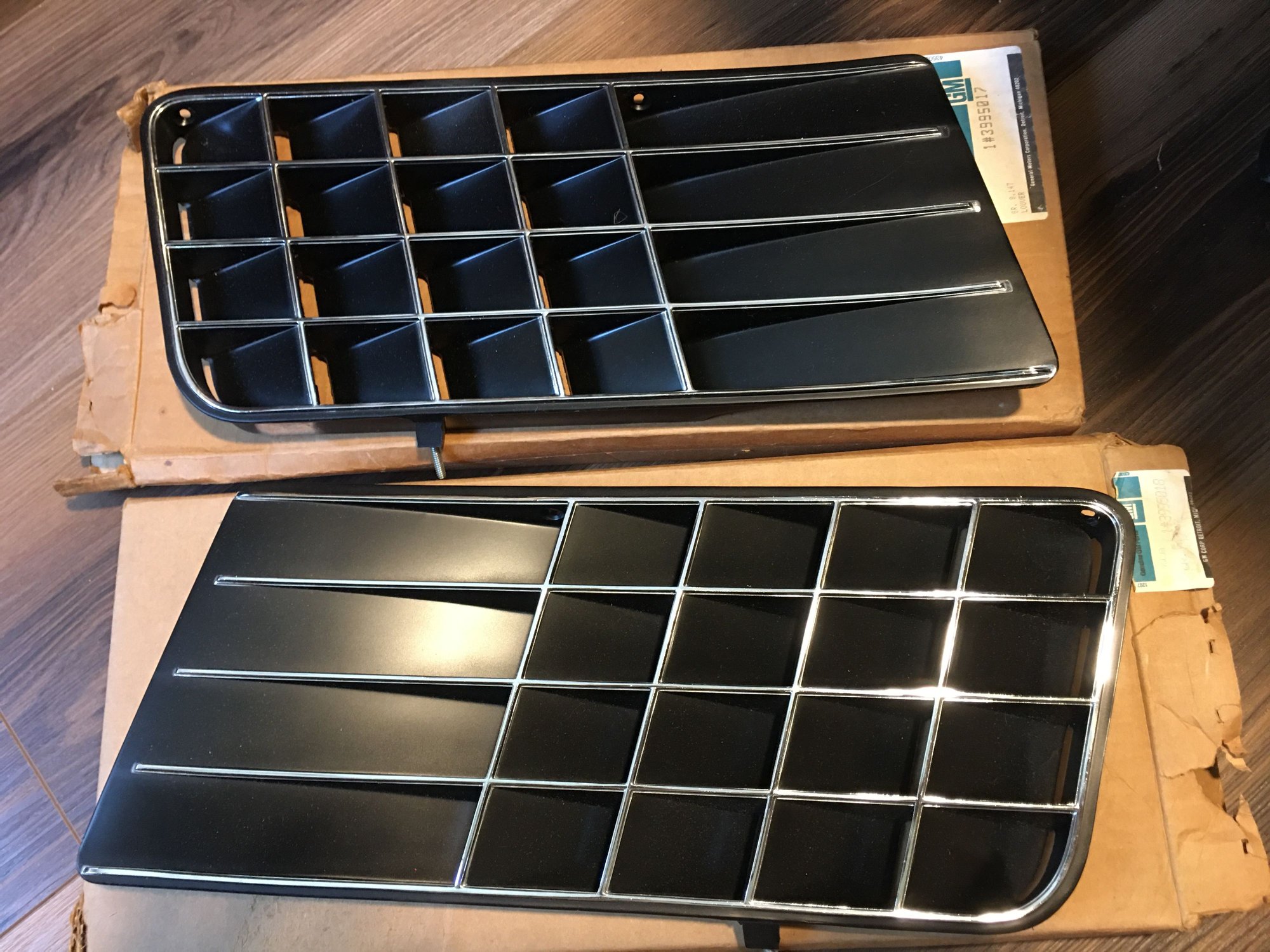

Are you sure of that? I have stripped two sets and owned an NOS pair, and they all had a black primer on them.
Black primer is on these NOS grilles -

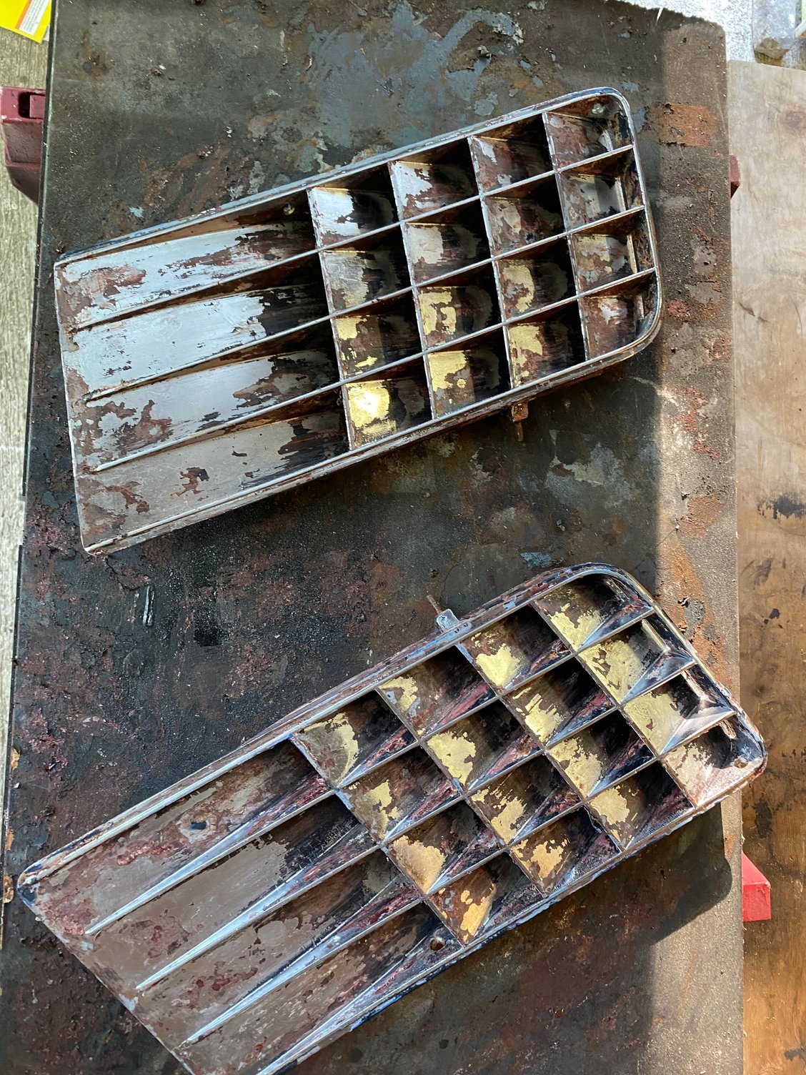

The real problem is even almost new - the chrome was not that "chromey" other than on the edges.
I did it in the early 80's- when paint stripper's vapor removed the paint!!! I thought it would look better than the re-paint red but was disappointed with the not so shiny fins,
IF the chrome is too pocked up- you can sand the potmetal and polish it up.
I found pin-stripping (1/8") works great if you are going to mask the edges and re-spray..-
Albeit these are custom-but the potmeteal does polish up nicely-
Chrome look back in the day
Finished -
