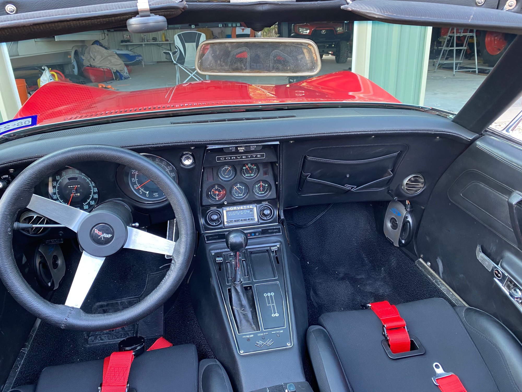

Or you could "dye" the trim pieces. Actually is is a flexible paint. I've used the SEM product with excellent results, but I think Corvette America has rebranded version.
You could probably do the whole interior for $2-300 including prep supplies if you did it yourself. Prep is critical to getting a good result.
You'll have to replace the carpet if you want a quality appearance (+~$350). Replace the seat covers too if you want a more durable finish (+ $??).
Depending on the car, this change may negatively affect resale value.
Before (I had already done the door panels)
After (couple of pieces were replaced, but they were all dyed to have the same sheen)
