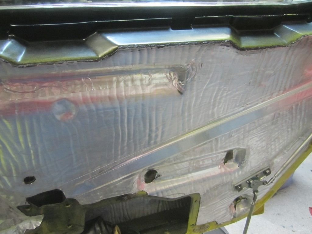

I used it on my 72, it did some sound dampening but I'd say better as a moisture barrier. When you closed the door it still resonated but not as much as without anything.
When I re-did the interior I covered the door in the dynamat type product and it did a much better job of deadening the sound to more of a modern "clunk"
I have no idea if either make any different in sound otherwise since the windows are almost always down, tops off and rear window out so....
The foam you linked to
BeQuiet material
