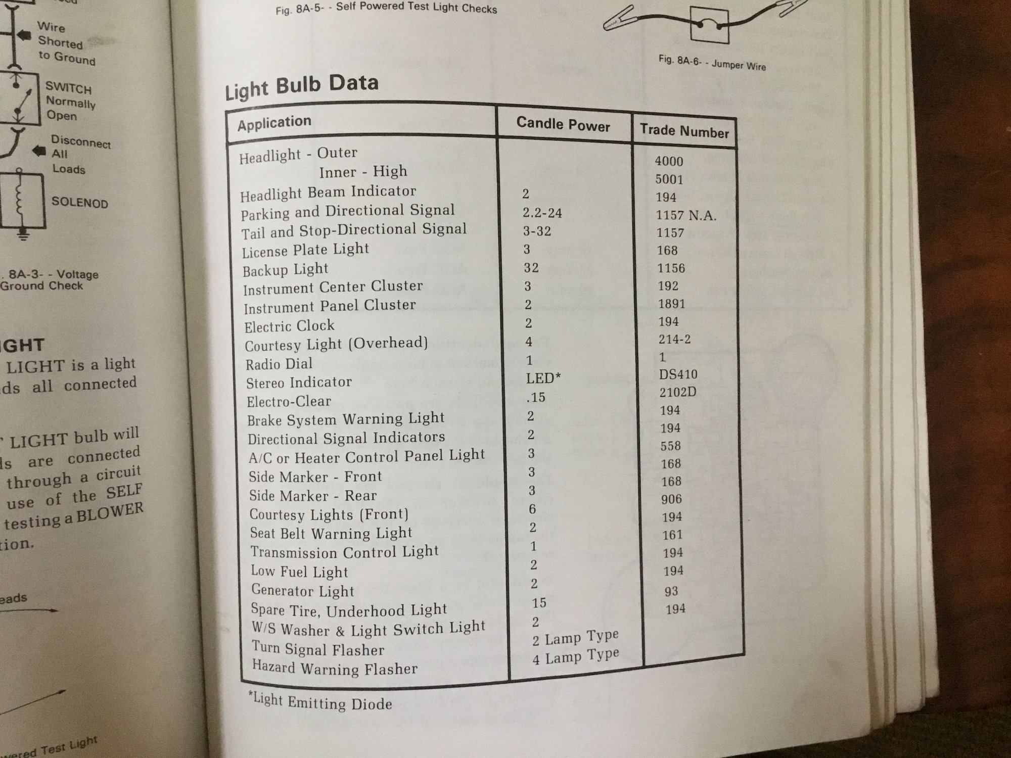

This table is from a 79 manual. It has 192, 558 and 1891 bulbs in addition to 194’s.
1979 manual. Candlepower is easy to convert to lumens or watts.
He has an 81.
