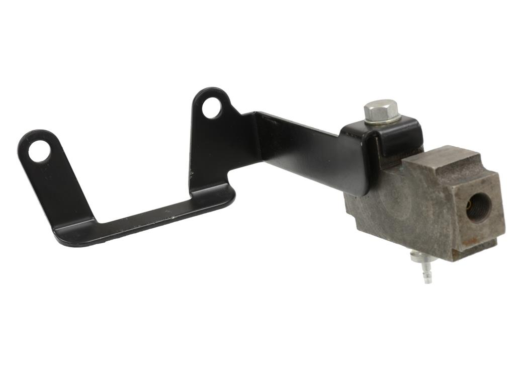

This is the block for the 68 vet that most distributors sell. Not sure about later models. I don't think it's chinesium. Another good reason not to use DOT5. I'm pretty sure this isn't compatible.

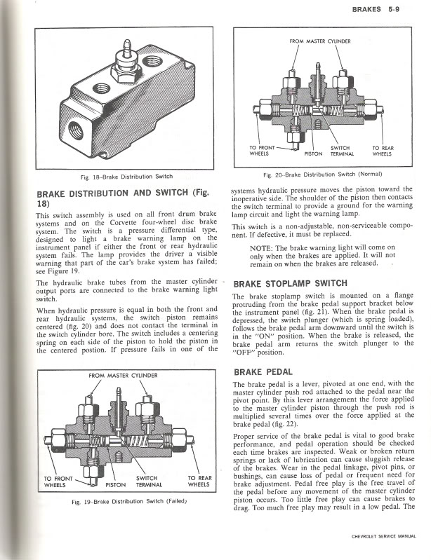

I am sorry,,,,, but that doesn't happen and that's not the purpose the valve. It only lights the warning light. The MC is divided in two halves. Front and rear. This is supposed to keep one half working, but I am not convinced of this either. As it says the light will only be on when you are pushing on the pedal,,, and goes off, the valve centers, when you lift the pedal,, no resetting, no stomping.
My '74 Service Manual says the same and on my Vette the LIGHT will go ON as you press the brake pedal and OFF as you release the pedal. That is how mine works.
For those that need to center the piston so the light goes OFF, yes! Stomping works for some but another way might be to have a helper depress and hold the brake pedal as you crack open a front bleeder.
If the light is still ON press and hold and crack a rear.
Your Corvette will stop on one system even if you had a serious leak but it will increase stopping distance by a lot.
