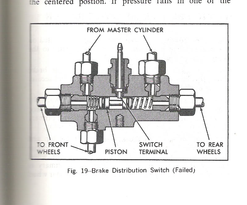

Top flight sells many different proportioning valves. If it looks like this, it's correct. You have two different calipers on the rear. Are they the same, just different sellers?Maybe one has more stopping power. Technically this isn't a proportioning valve, it's a distribution block. It's only function is to light up your brake warning light.

Old Aug 27, 2021 | 12:20 PM
7T1vette's Avatar
7T1vette
Posts: 37,637
Likes: 3,118
From: Crossville TN
It is possible that the shuttle valve inside your distribution block is binding up inside and causing rear brakes to hold under heavy apply force. It is also possible that your parking brake shoes are somehow being applied under heavy braking (don't know how that would happen?) and causing binding. You state that ALL of the flex hoses going to the calipers have been changed, correct? Because that would be my #1 pick for the cause of your problem.

From: Wichita Kansas
I have read that if you start the car and then slam the brake pedal, that it will do some resetting, on the proportioning valve?
Old Aug 27, 2021 | 09:09 PM
kodpkd's Avatar
kodpkd
Joined: Jun 2019
Posts: 5,472
Likes: 2,180
From: Loveland
If it is an original distribution block for the 70,,,, it doesn't reset. It is only a switch that lights the light. It doesn't get stuck in the wrong position. Stomping on the brake pedal doesn't do anything to this valve. It is like stomping on the brakes to reset the brake light,,,, it doesn't happen.
Old Aug 27, 2021 | 10:20 PM
7T1vette's Avatar
7T1vette
Posts: 37,637
Likes: 3,118
From: Crossville TN
Yes, the dist block shuttle valve WILL reset, if it is 'tripped' in one direction and any leaks have been repaired. It isn't a guarantee that the valve will reset, but that is the FIRST order of business to get it back to center position. Just give it a good, hard, stomp to attempt a reset.
P.S. If it has been tripped, the "BRAKE" warning light in the speedometer should be illuminated (if the bulb is good and system is operational).
Old Aug 28, 2021 | 09:03 AM
kodpkd's Avatar
kodpkd
Joined: Jun 2019
Posts: 5,472
Likes: 2,180
From: Loveland
If this type of valve is tripped, it doesn't shut off fluid to the side that is leaking, it only makes electrical contact to light your brake warning light. A tripped valve doesn't do anything to the flow of the fluid. Now, if it's rusted all to hell and has corrosion and gunk in it,,, it could be plugged up, as any brake part can be. If the valve is functioning normal the springs will center it.
To Brake help
Old Aug 28, 2021 | 06:13 PM
7T1vette's Avatar
7T1vette
Posts: 37,637
Likes: 3,118
From: Crossville TN
Actually, under pressure, the spring at the end of the shuttle valve will compress and it will nearly eliminate flow to the defective 'half' of the brake circuit. That's its purpose: to let you know that there is a problem (with the BRAKE light). to allow the continued use of 1/2 of the brake system, and to prevent the loss of fluid from the defective side of it.
Old Aug 28, 2021 | 06:40 PM
kodpkd's Avatar
kodpkd
Joined: Jun 2019
Posts: 5,472
Likes: 2,180
From: Loveland
I am sorry,,,,, but that doesn't happen and that's not the purpose the valve. It only lights the warning light. The MC is divided in two halves. Front and rear. This is supposed to keep one half working, but I am not convinced of this either. As it says the light will only be on when you are pushing on the pedal,,, and goes off, the valve centers, when you lift the pedal,, no resetting, no stomping.
