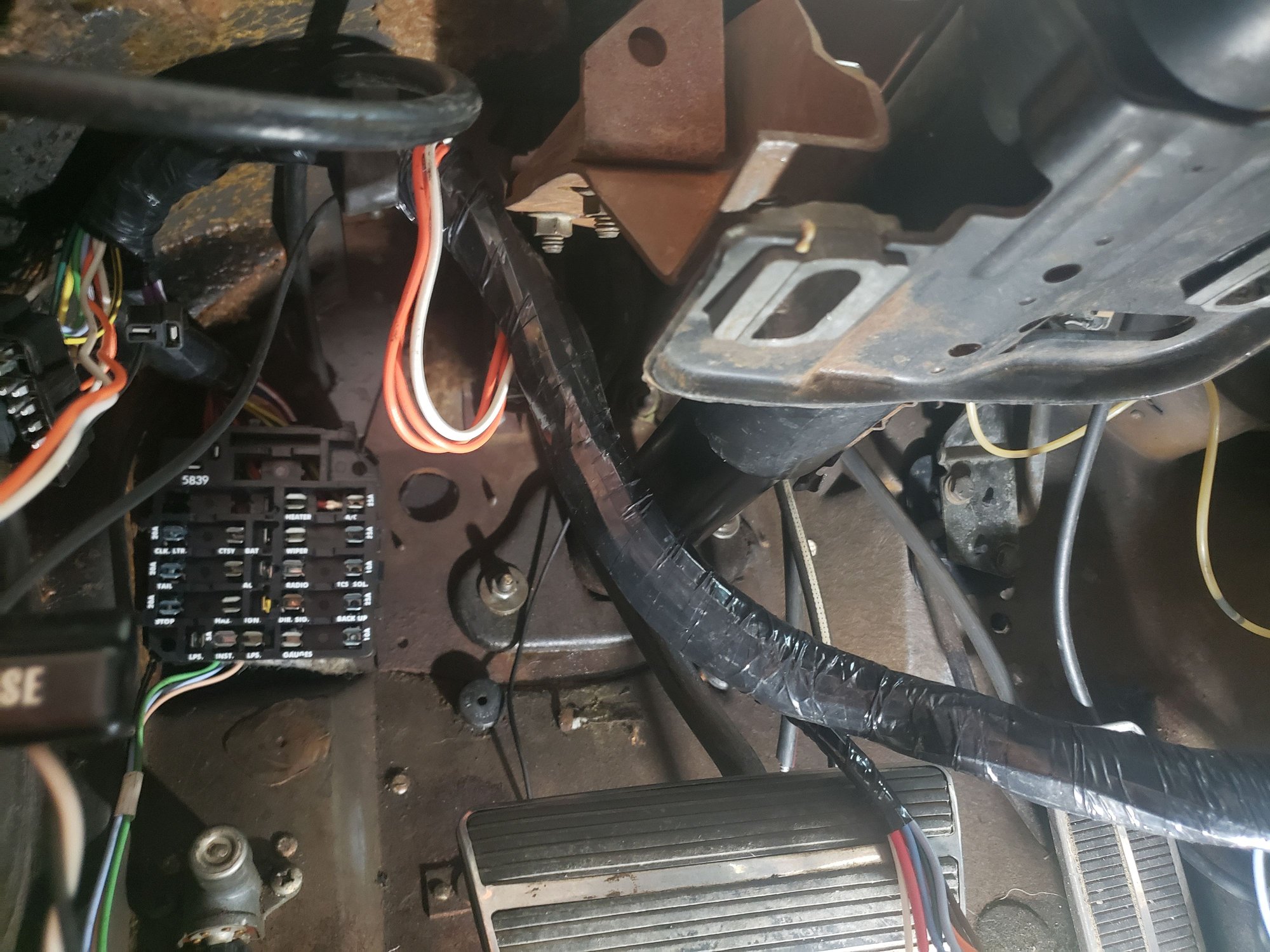

Routing a new 1972 Dash harness, does it go UNDER the steering column or OVER the steering column (under dash)?
The pic below shows how I have it now,, which is under.
Thanks my Vette brethren!

Do you have a copy of the AIM for 1972 model year? The section on "Electrical" has drawings of all wire routings.

yes I do. And if it does, I guess I'm not making sense of it.
I exhaust all my options before I post in an open forum.

It goes over the steering column.

This is what was confusing me, this in the AIM makes me think it goes UNDER.

Sometimes the AIM doesnt aim where it should! Route the harness where you have the most slack to reach all the components...try over the column first

I see what you’re talking about. It runs from the fuse block to a clamp on the lower dash pad and then runs over the top of the speedometer and tachometer. My 68 is similar except that it runs below the speedo and tach.

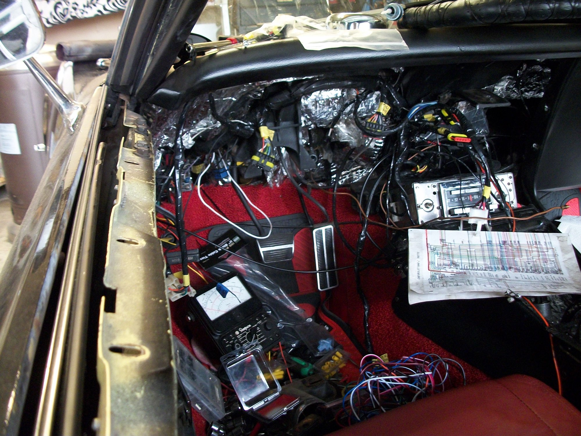

Old Aug 25, 2021 | 07:18 PM
STL Zombie Hunter's Avatar
STL Zombie Hunter
Joined: Sep 2012
Posts: 823
Likes: 102
From: St Louis
St. Jude Donor '13
Originally Posted by doorgunner
Thats B-Yooo-Tea-Full!!
That did the trick!! Thank you!!

plus they go under the tac and speed cable
