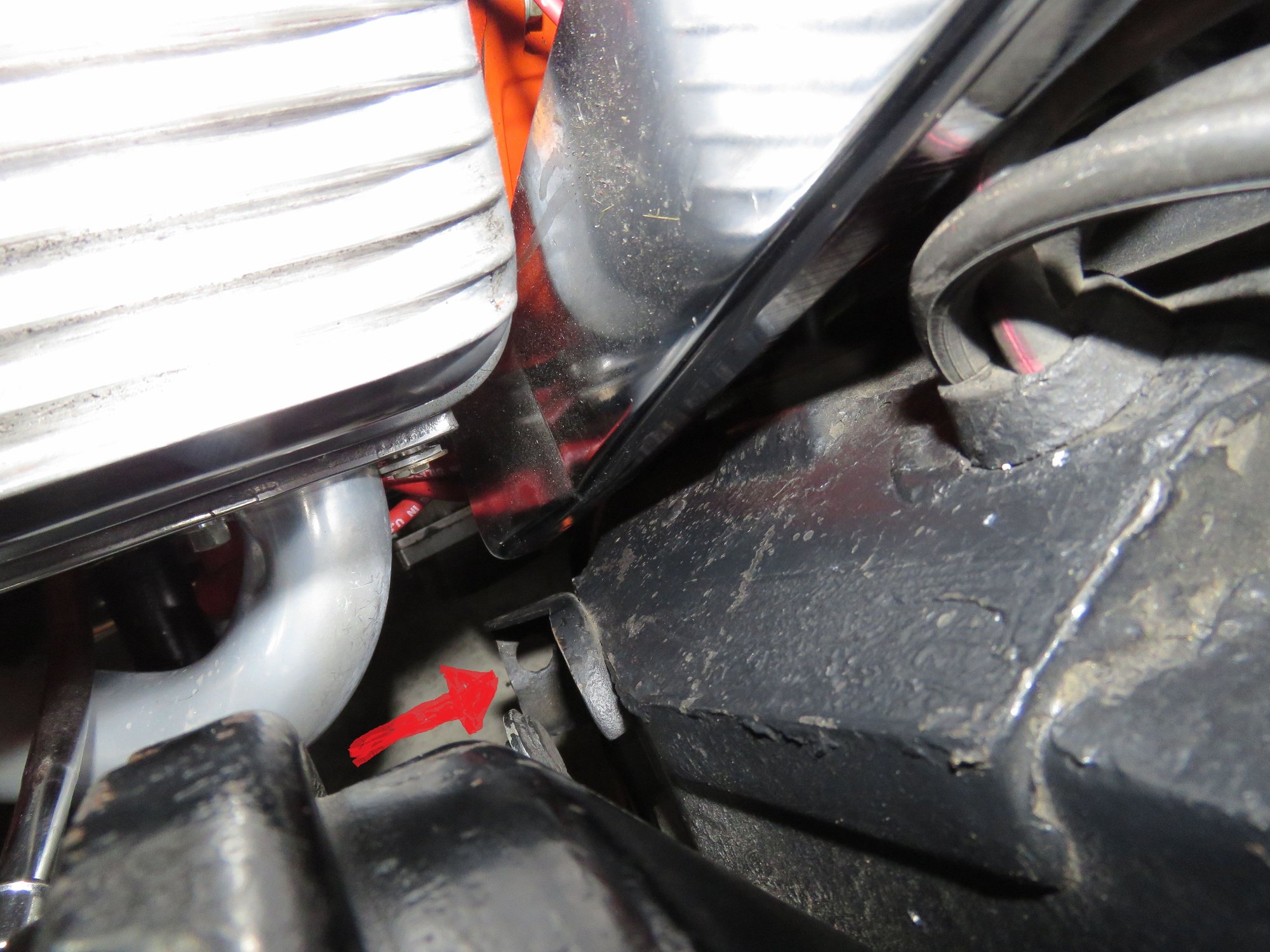

Originally Posted by Bergerboy
The interlock cable attaches that lever to the trans underneath at the reverse linkage.
Probably via this bracket, right?
Old Aug 31, 2021 | 10:09 PM
sw69vette's Avatar
sw69vette
Joined: Apr 2020
Posts: 264
Likes: 200
From: Sicklerville NJ
Yes , cable goes from the column to the reverse lever on the trans .
