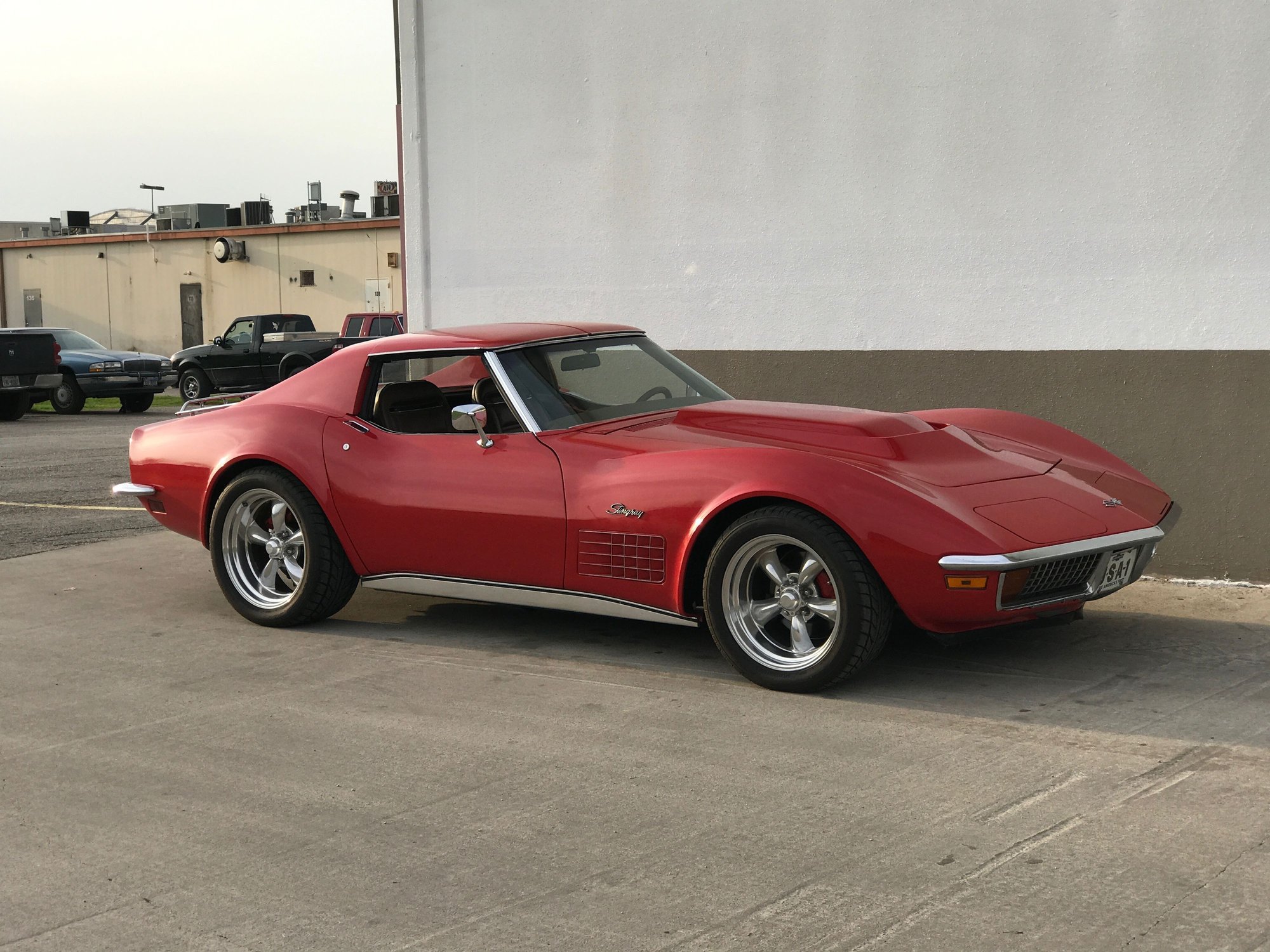

The wheels are 18x9.5 with 4.75" Back spacing. No modifications required on my 78 car. These are with 275 40R 18's not sure what your render gap looks like. This is with the VB&P Street & slalom kit installed. ~ 27" fender to group measurement

Get the stance correct first...tires are to expensive to try out IMHO and so visible to get it wrong......seen it too many times. The red 79' above from cagotzmann has been saved in my computer for years as an example of perfect stance......

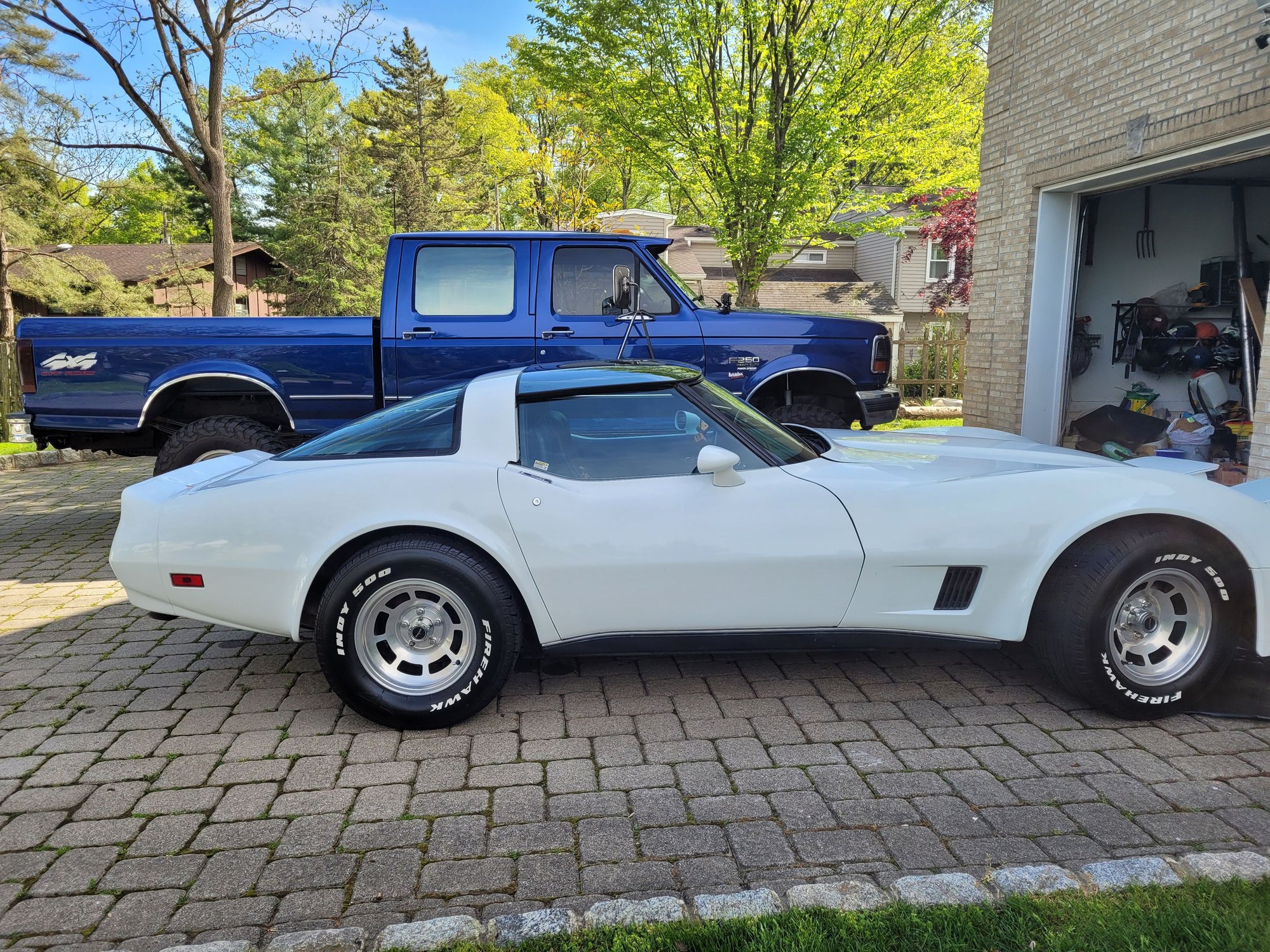

After with smaller tires and new wheels 275/40r18
Before 275/60r15

See what you mean......but a 275/60/15 is a huge tire for a Vette in the front.......in 78' you could get a 255/60/15 stock and the wheel lip was trimmed a bit at the factory......those must rub on the frame like crazy....how they clear the fiberglass is a mystery.
Ho close is the 40 right now? You should be able to tell if the 45 fits by looking at how close your 40's fit and getting the diameter of the 45 in question. Personally.....I would lower this car. 2" in the front and 1" in the rear.....but that is just me.

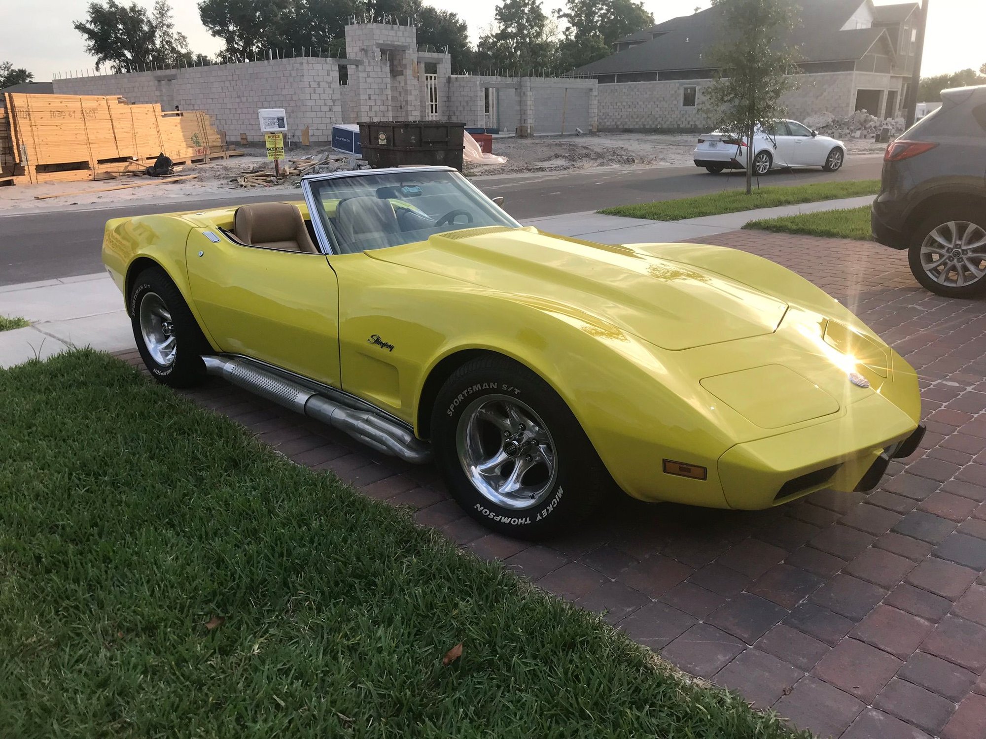

I have had 255/60R15s on my 1975 for almost 30 years with no issues. 10 years with the stock Rally rims, 4" BS and almost 20 years with the current American Racing rims with 3.75" BS. ZERO issues.

evey since I bought the car I had no idea how the owner before got such large tires up front and they barely rubed the in side fender at lock but never the frame. It's like a blessing. But it look sicked with such a big tire and I want to keep that look. Also how would you lower it. I can't get lower bolts because it's already close to my wheel and any longer I would be afraid
