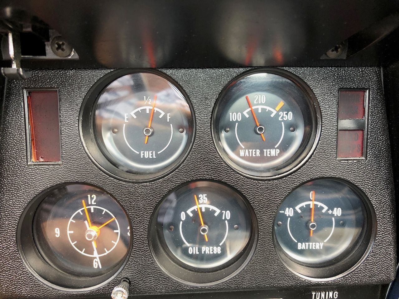

Took these pictures of the guages on my stock 73 L82 on July 9, 2021, sunny mid 80's. Idle and cruising about 2500 RPM. 10W30 oil.
Fran
Cruise
Idle

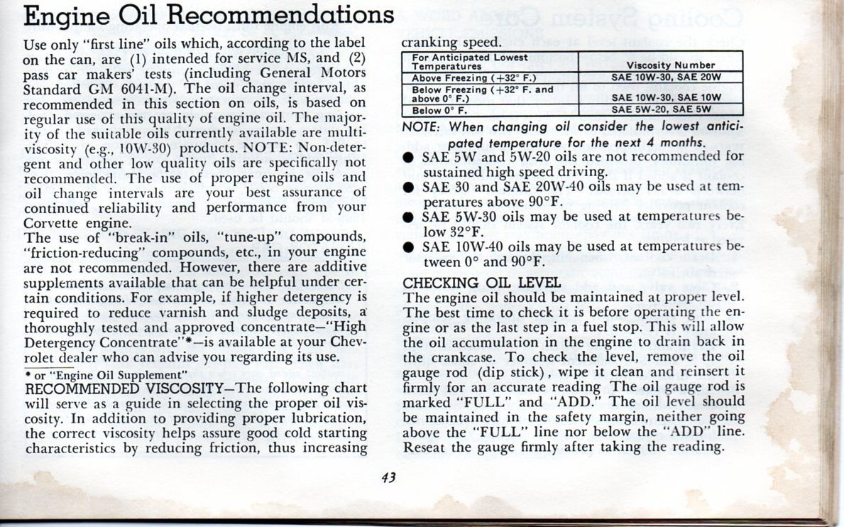

5W30 is not intended for your car.
You need 10W30.

Old Sep 7, 2021 | 04:34 PM
Redvette2's Avatar
Redvette2
Joined: Nov 2013
Posts: 1,570
Likes: 485
10W30 - The first number in the oil rating is the cold start up viscosity. Colder climates typically require a lower number which is thinner at the low temperatures. The second number is the rating when the car is warmed up. Most car manufacturers give a range of oil viscosities based on lowest anticipated temperature that the car will see. Here is the page out of my 1968 manual.
1968 Engine Oil Recommendations
