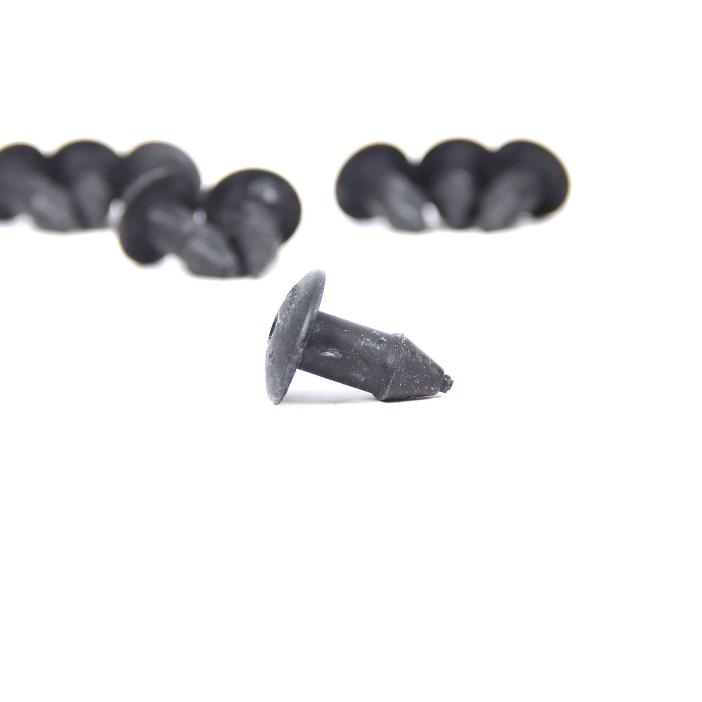

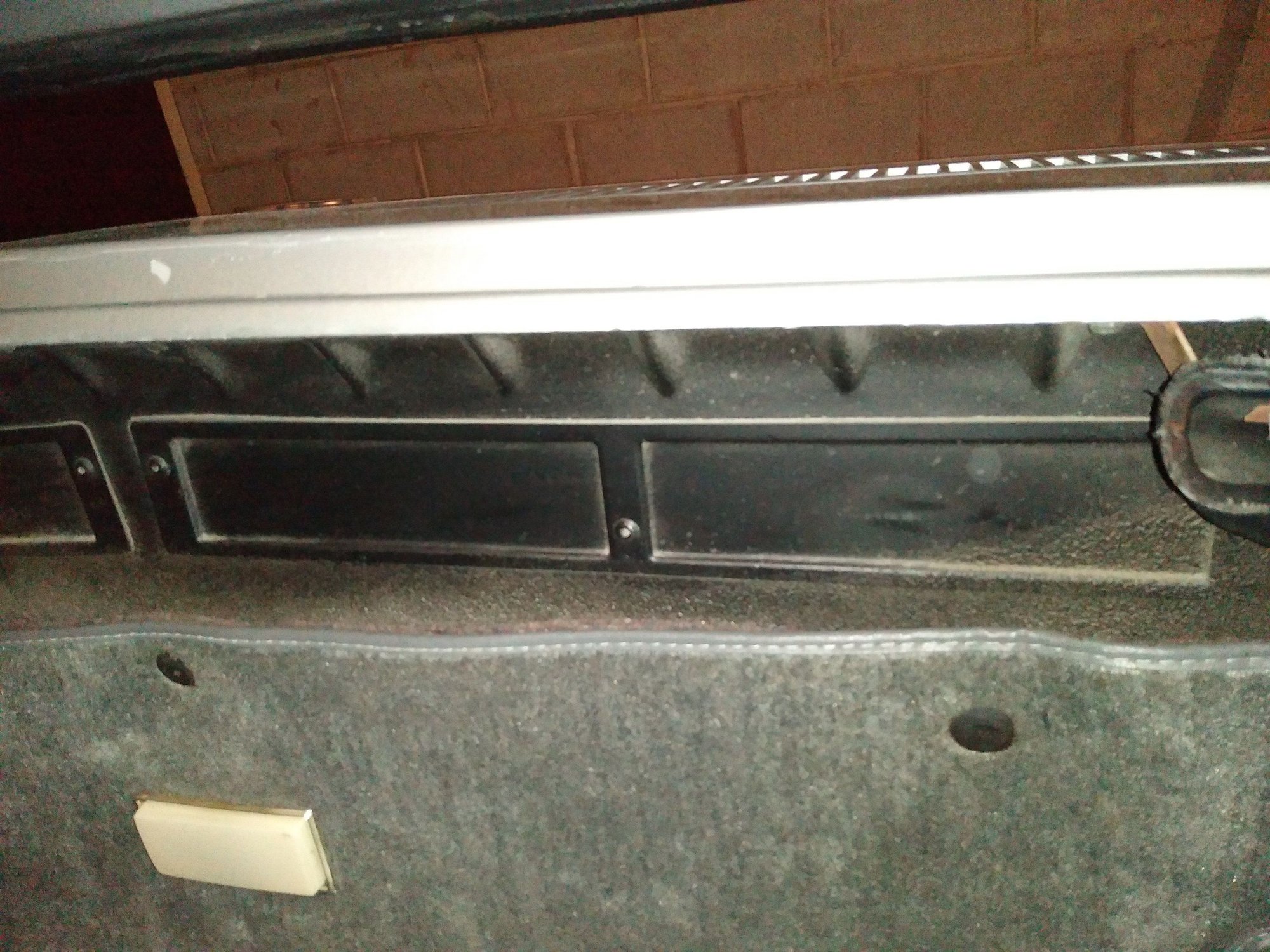

The carpet retainers are rubber, not plastic. They are no longer available from GM. They are being reproduced. Here is one source:
https://www.zip-corvette.com/68-82-c...ing-plugs.html
The holes that accept the retainers should still be present in your rear bulkhead panel. Here is a pic of 2 of the carpet retainers from my '75

Pic of the carpet retainers I mentioned in my previous post:
