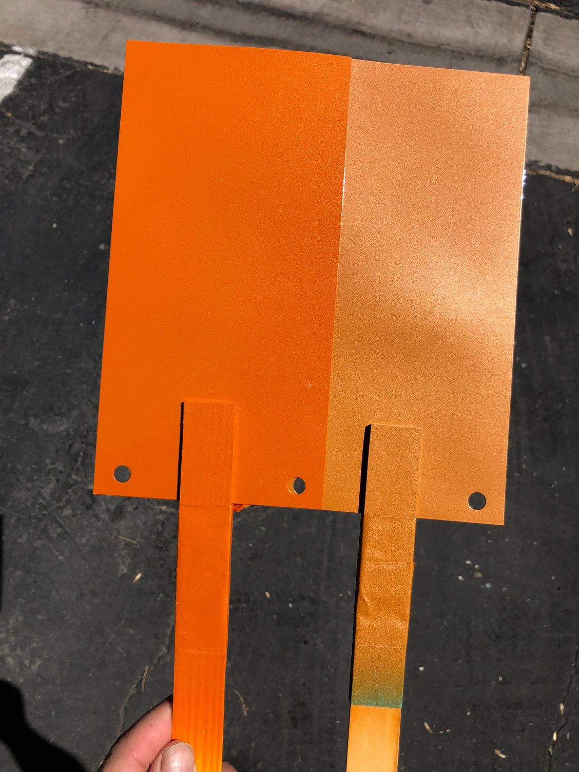

Good luck trying to match it. I’m repainting my whole car and I’m having a hard time matching the color correctly. Can you have a paint store use their camera to find the correct mixture? I’ve attached a picture of my paint sample that’s the same formula but with 2 different sizes of metallic flakes. Completely different colors! The finer metallic turned it into a milky orange bronze vs the larger metallic is more of that blaze orange.

it should do fine for little chips. im not sure if youd ever get a close match with those tho. automotive metallic paints are pretty translucent so the flake shows thru the color. its basically clear/silver basecoat with toners and metal flake is suspended in each coat. the base they start with is silver and use toners to get the right color. the solid color paints youre using has white as the base with yellow green toners
im not sure youll find a silver flake in model paint that matches that, the silvers are pretty much powdered aluminum so it sprays thru a tiny airbrush.
mixing regular solid paints and trying to add metal flake probably wouldnt make a big difference either, since the flakes would get buried in the solid paint. maybe if you try reducing it or adding clear and micro flakes, but then the coverage would probably be terrible. maybe try mixing only metallic model paints?
I would just get that piece you have, take it to a paint supply and swatch or scan it and get a tiny can of paint mixed.
