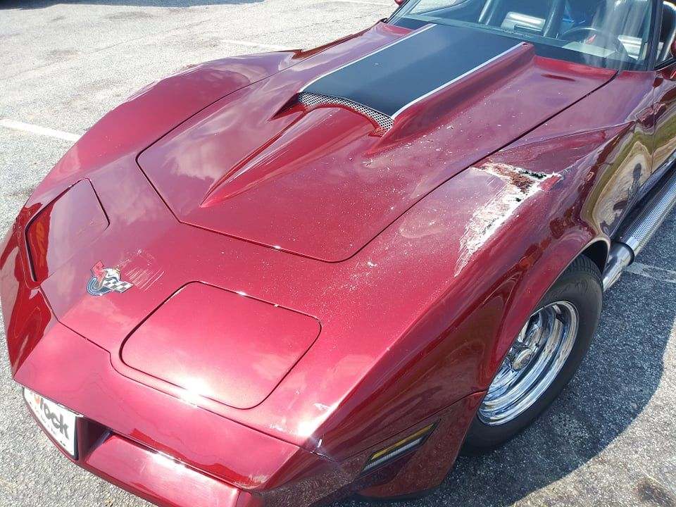

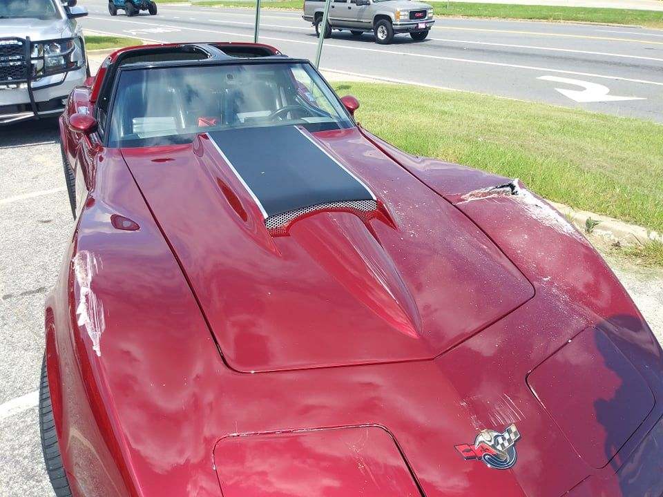

Have it insured with Hagerty for 30k. Semi trucked backed into me after we both had complete stop at stoplight. He didn't see me and backed up so he could turn into SubWay for a sandwich.

Not at 30k value. Beat 5 or 10k car, it’s totaled.

It really depends on who writes the estimate. It's definitely repairable. I hit a deer back in 98. my front end looked a LOT worse than that. Had it repaired, spent a year in the shop.

New fiberglass on entire front half and total repaint with labor at a nice shop will be over 20K to do it right is my guess.

Any good fibreglass shop can fix that front end. all new front clip??? Not really necessary unless your super picky. and repaint front clip only. Generally cars get totalled if the repairs go over half the value. A lot depends on you. Do you want it totalled? Estimates can be written high or low. And of course there is more than one way to repair this.

His insurance will try to get it as cheap as possible. Find a real corvette repair shop and have them right a full estimate including all new fiberglass and paint. Also have them check the frame and suspension as it probably bottomed out the suspension.....Or have the trucks insurance give you the $30k for the car and the $250k for the medical bills...Or they can just get it fixed correctly for the $20 k estimate...up to them

I'm guessing $8 to $10 Grand to repair. No way will it be totaled it @ $30,000 ............ $30K ??? I'm NOT going to say it ! But, I am very sorry this happened to you & your car.

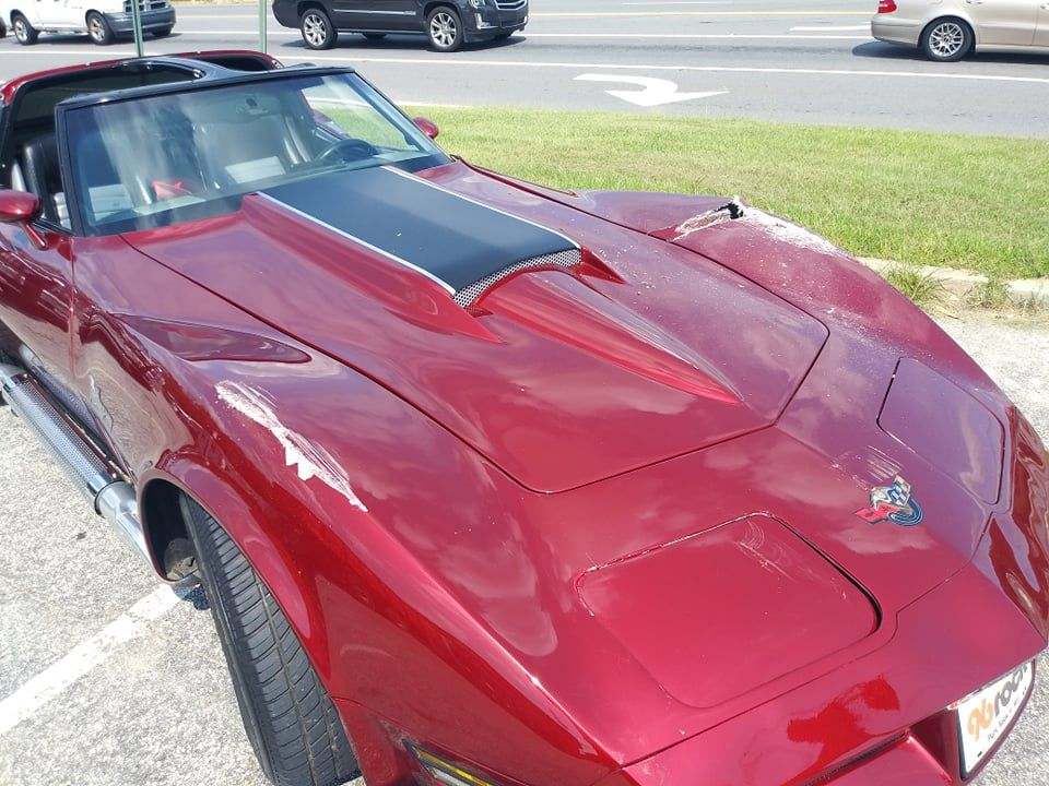

Very hard to tell from our view based on pics, but if there is zero damage to the suspension or anything else underneath it certainly DOES NOT look like it needs nor will they put a full clip on that car. From what the pics show it really doesn't look all that bad. I know one tiny, little rock chip on my car has made me insane but as stated above "any good fiberglass shop" can repair that, well maybe not ANY but it sure looks repairable !!! Again it's very hard to tell from this point of view. Haggerty's adjusters know what they are doing. I'm looking forward to reading about a "HAPPY ENDING"

The pass side is not that bad just a large deep glass scuff. The driver side is a hole large enough to put a coke bottle in sideways and carries over from the top into the side of the fender. Head lights are push in enough to chip paint on the backside of both. Nose has small cracks/scuff here and there. Center of hood has some deep scuffs. Only thing mechanical could be some damage to the popups. They are loose and wiggly but still work.
I had 69 gills glassed in and don't want to lose them if repaired. As well as some custom emblems that were expensive. Hopefully Hagerty takes this into consideration.

For $8-10K all you get is patched up fiberglass and shiny paint. To fix it right it's a total.

Fiberglass is about the most repairable body material there is. It's not totaled and it can be fixed. Do you WANT it to be fixed, or do you just want to get paid?
