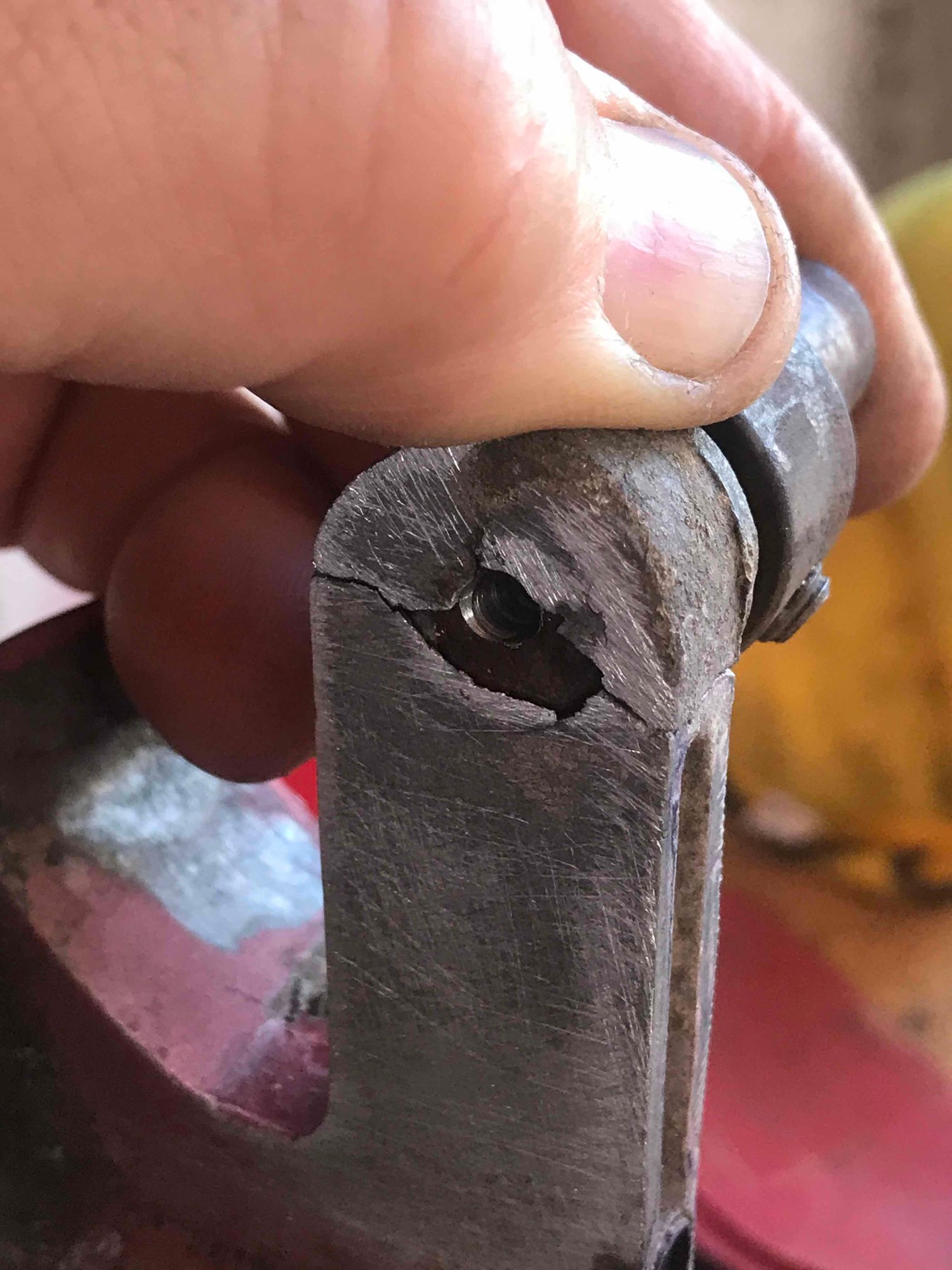

This is one of those "shall I try to repair it?" calls I need to make. I'm a fan of repair over replacement whenever possible. My questions are:
Is this aluminum? (because if it is, I can't weld it)
Will JB Weld + some support material do the job? (Thinking that some additional bracing, plus some JB weld might do the trick.)
The part is the headlight cover hinge on the passenger side.

Sand the crud off it.
Line both pieces up with each other/Make Sure the Cap is oriented correctly on the main arm and clamp tightly in a vice--tap the cap back into alignment if it "*****" a little
Drill a hole thru the "cap" on each side and into the main part of the arm at least an inch deep.
apply plenty of JB weld to the mating pieces
Drive/press a steel roll-pin into each hole...
make sure the roll-pins bottom out in the main arm and are long enough that they protrude out of the cap once they are bottomed out
grind the excess flush with the cap on each side
wipe off the excess JB weld
allow it to cure at least 24 hours...more is better
clean/sand the I.D. so the large steel dowel slips in
apply grease to I.D.
Assemble

POT METAL.............. don't smoke it !

I don't think JB Weld is strong enough for that application. I also believe that the casting is aluminum, rather than pot metal. If so, the repair can be made via Heli-arc welding....or by replacing the buckets with salvaged parts.

I'm absolutely not an expert here. But fairly certain I've read on here (this forum) That these are not weldable. me, I'd be calling salvage yards looking for a good used one.

I would try putting the broken part on a drill press and drilling maybe a 3/16 hole through it, then use that as a guide to drill further into the bucket. Put a bolt in it with red locktite.

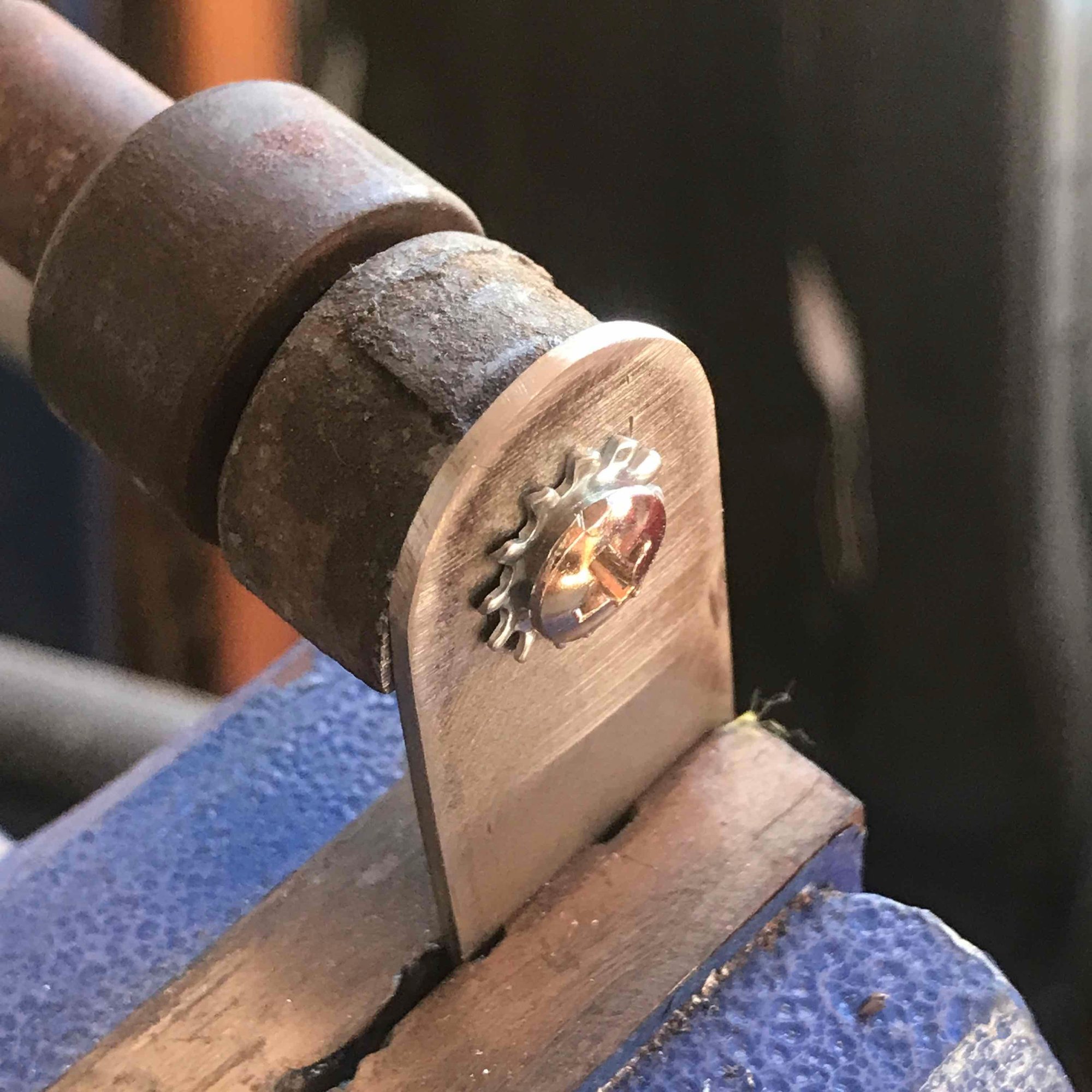

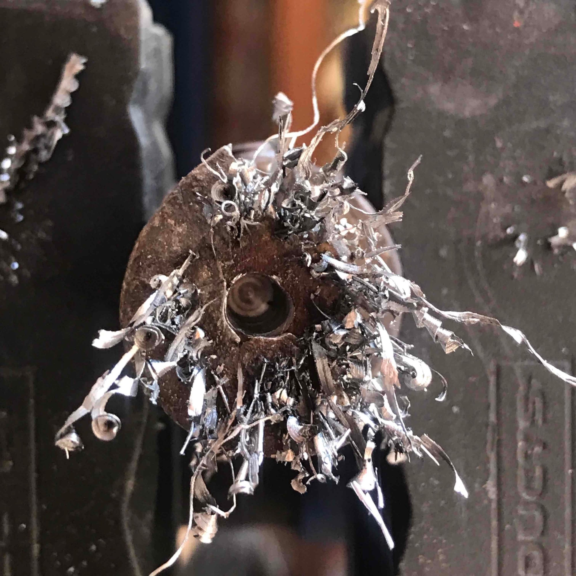

Thank you ALL for the suggestions.
I ended up making a small plate that will support the end and anchor it in place with screws.
Drilled hole in dowel - Tapped - JB metal on all surfaces - screwed into place, then clamped together.
The plate will get an additional 2 screws in the support arm once the JB weld is set.
Like some have said, it's worth trying ti fix it, if it doesn't work - I'll get the part.

Old Sep 13, 2021 | 05:18 PM
Richard454's Avatar
Richard454
Joined: May 2003
Posts: 8,877
Likes: 3,556
From: Fernandina Beach FL
Good job!!! That's exactly how I would have went about it.
Well- I might have used a button cap instead of a Phillips
Old Sep 13, 2021 | 05:19 PM
K-Dog's Avatar
K-Dog
Joined: Aug 2021
Posts: 219
Likes: 46
From: Los Angeles
Thanks - I would have preferred to use a Torx or Hex bolt (or button cap) but I used what I could find among my spare stuff.
I think it will be fine.

Thanks for posting repair pics. Other parts on the car can be saved using the method above!
Old Sep 13, 2021 | 10:41 PM
7T1vette's Avatar
7T1vette
Posts: 37,637
Likes: 3,118
From: Crossville TN
Very inventive. I do hope it hold up. nice work.

looks really good!

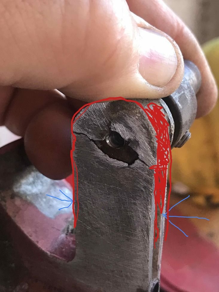

i think a strap over the top of the pivot would help also. my fotoshop skills are lacking, but a strap where the red is and attach it to the arm at blue arrows should be considered.
It didn't! When I trie to install it, the pressure against the two guide pins ended up breaking the sheet metal screw I had installed in the lower part of the plate.
I then re-installed two bolts in its place and re-JB welded it together. I'm confident that it will now hold together.
Old Sep 16, 2021 | 01:58 PM
K-Dog's Avatar
K-Dog
Joined: Aug 2021
Posts: 219
Likes: 46
From: Los Angeles
Yes - I can't disagree with you. I'll see if I can put something together along those lines. I'm working at home with basic tools and supplies, so it's always an adventure!
