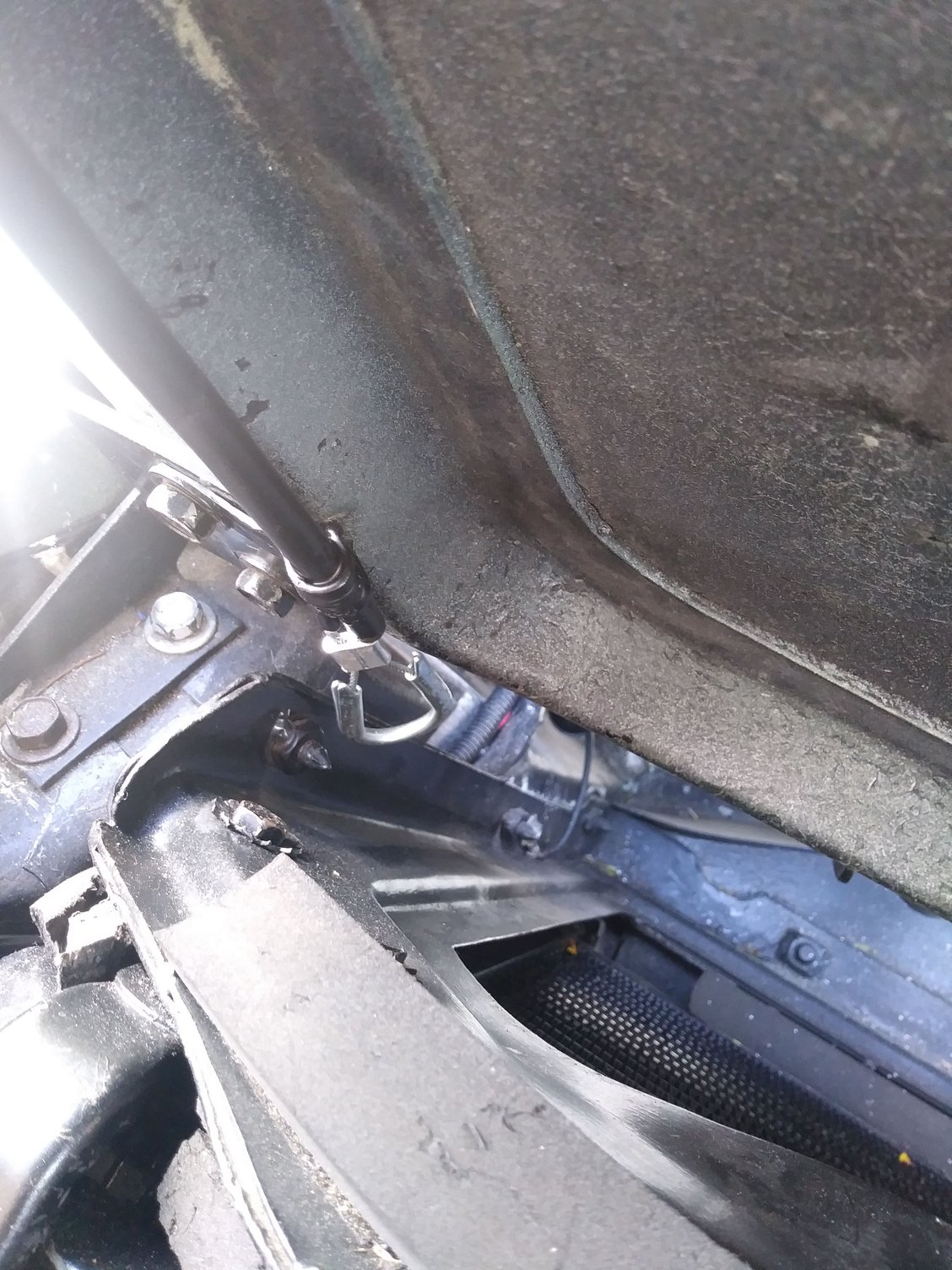

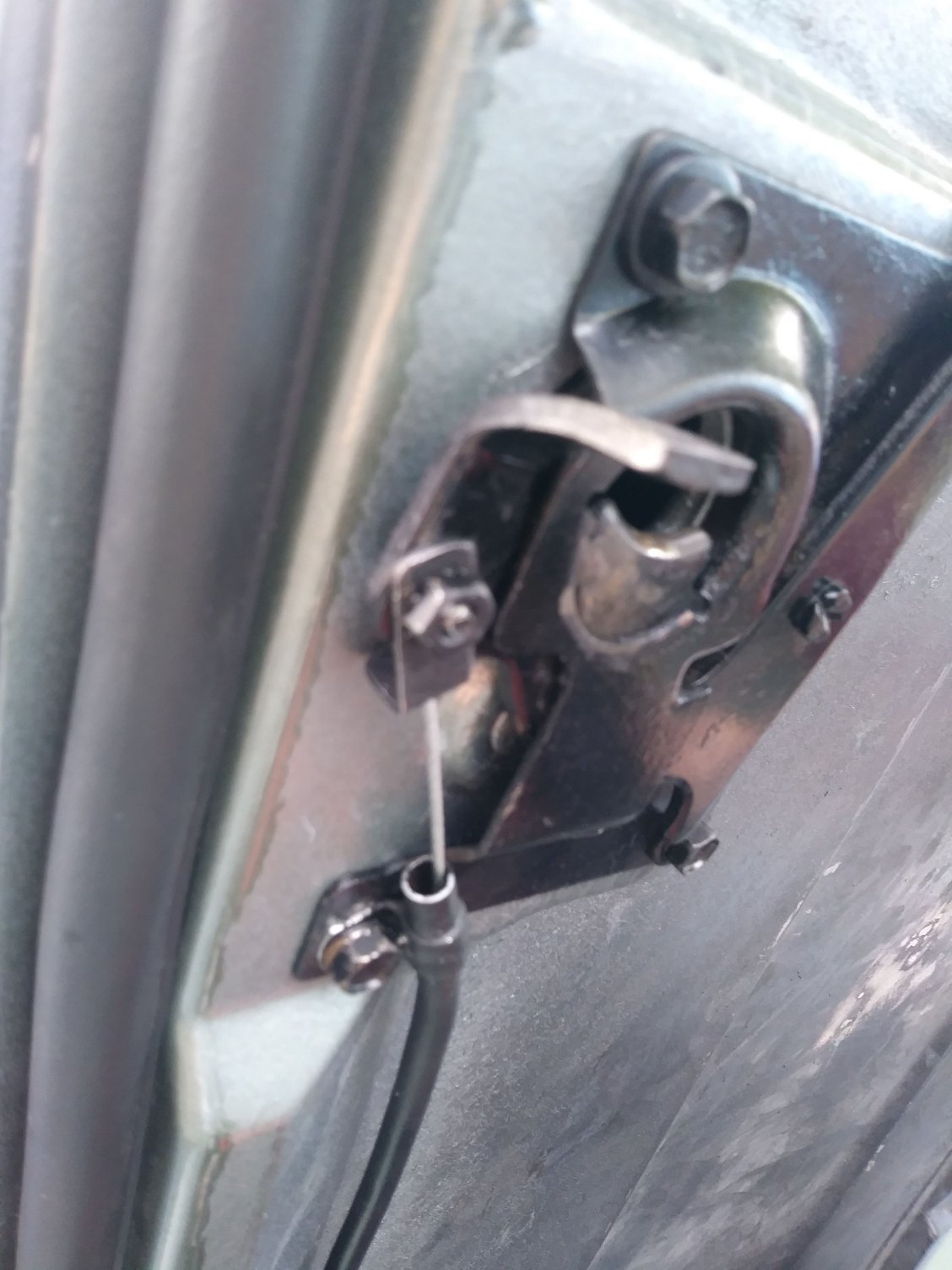

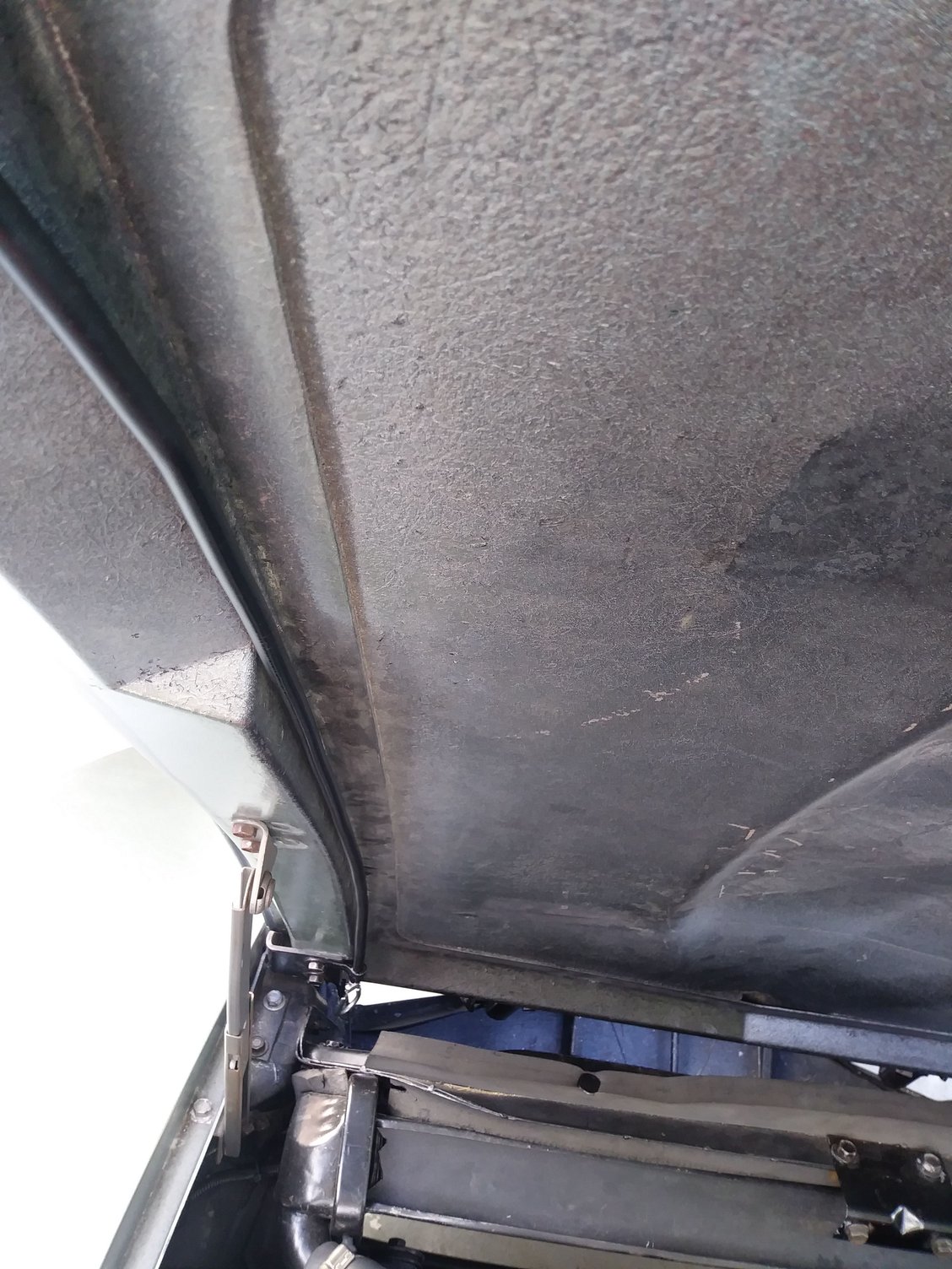

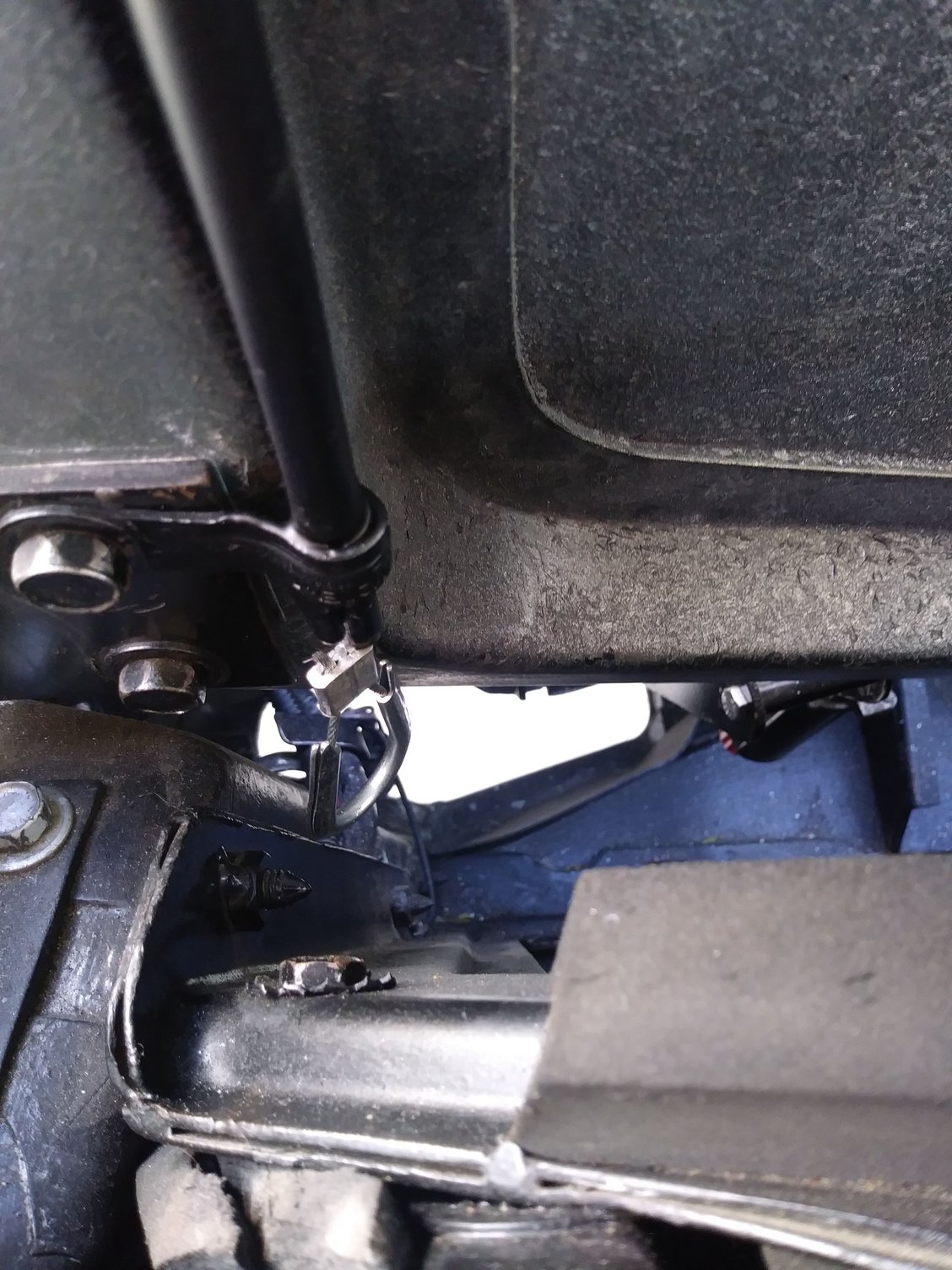

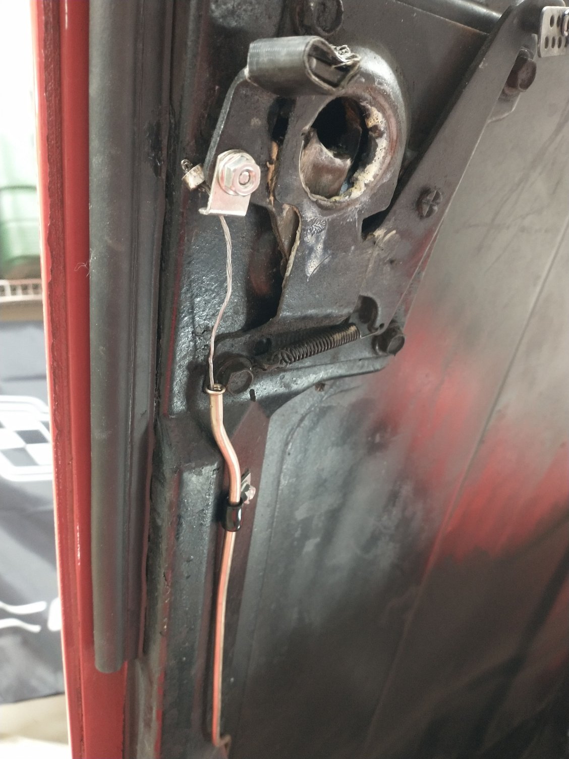

Yup......I did mine with some scrap brake line, a couple straps, & a piece of cable for under ten bucks! The loop is at the front edge of the hood, just reach up in the hole on the bottom of the front valence.... behind the headlight.
