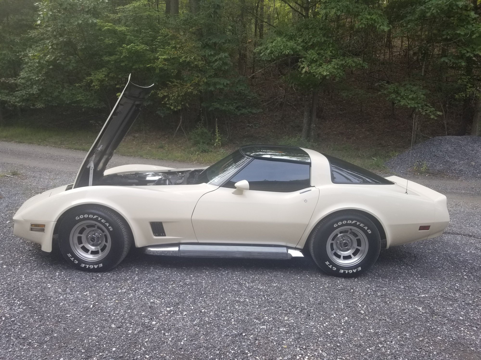

Hello all... this is my first post as i just bought a 1981 c3 with what i was told are original 1969 side pipes on the car. The pipes sound great and the pipes are fully functional. I have a check engine light that comes and goes. The previous owner had the check engine light checked out and his mechanic said its bc of the side pipes and they are missing some sensor. He stated if i went back to stock exhaust the check engine light would go out and stay off... i love the side exhaust and do not want to go back to stock ehaust... Anyone know how to get the check engine light off and keep the side pipes installed and fully functional? Thanks in advance to everyone for their help.
