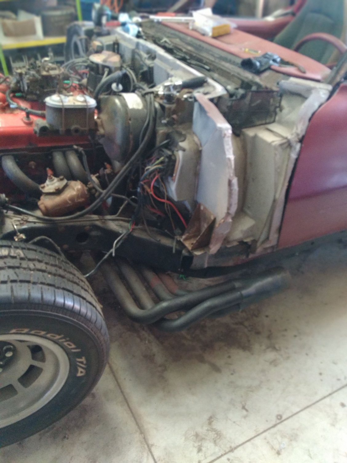

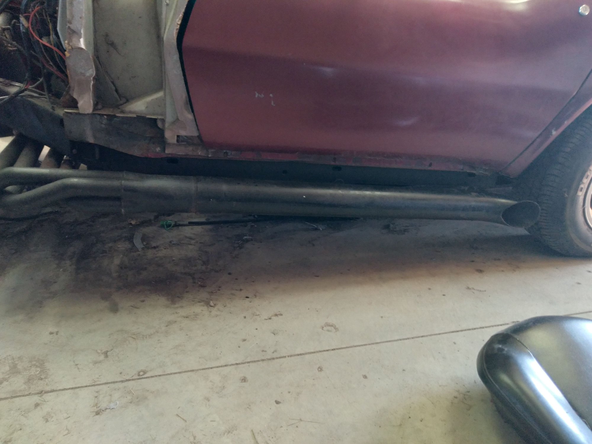

Made my weekend
big tubes, from front to back.

They appear in good shape...."no abuse".

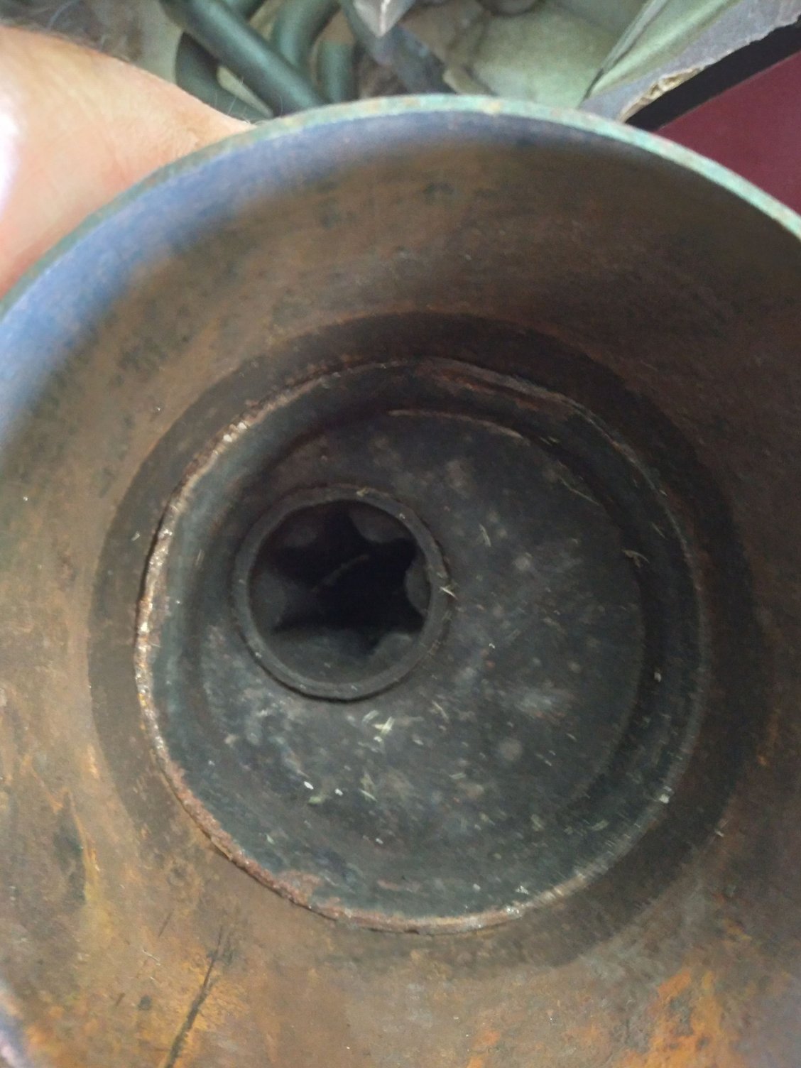

Yikes the inner muffler is that small in dia?
do love the look of those pipes and those primaries behind the front tire.

Thats what I thought, wow is the muffler insert tiny. The collectors and pipes are 4 inches in diameter, but that hole is under 2 inches. It's VERY quiet with the inserts in.

Those are the most restrictive inserts Hooker sells. So called "reverse flow" but not really reverse if you cut one open. Someone here just did that.
Classic Chambered sells "Vettepacks" for Hookers. He does inserts for quite a few Cobras and Vettes. Utube has video clips but it is hard to know exactly what your car will sound like.
I agree. Back in the day, Hooker made that style of headers for a number of GM cars, Pontiac Trans Ams, included. I had a set of them on the T/A that I owned, back then, and I had both the "glass pack" inserts, as well as the "reverse flow" inserts, and yeah, the inlets in RV inserts were that small.........

Throw those inserts as far as you can toward a cold roll steel bit.......they are terrible.

Those Hooker "quiet" inserts are such a terrible design. First the exhaust hits a huge wall, then like Play Dough, squeezes it into the internals of the cartridge. Ugh.
