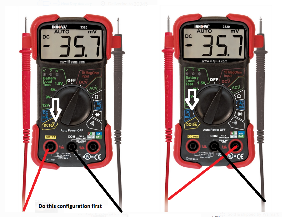

Just a guess- you probably had the door open- so the courtesy lights came on-they pull several amps
You really need to check the amps- in a series - current draw
Here's how to measure-
Do the left configuration first- ONLY use the right side configuration after you have determined the draw is lower than 200mA...otherwise you'll blow a fuse.
A picture is worth a thousand words...even more if you are a slow typer!!!

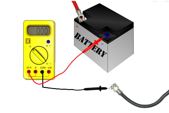

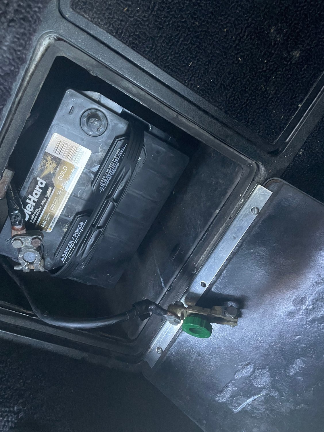

I went ahead and tested this with my multimeter and first measure 1.6 ADC. Doors were all closed.
The readings then went to 0.0 ADC after a while.
i attached how I measured the urrent draw and video of sparking.
