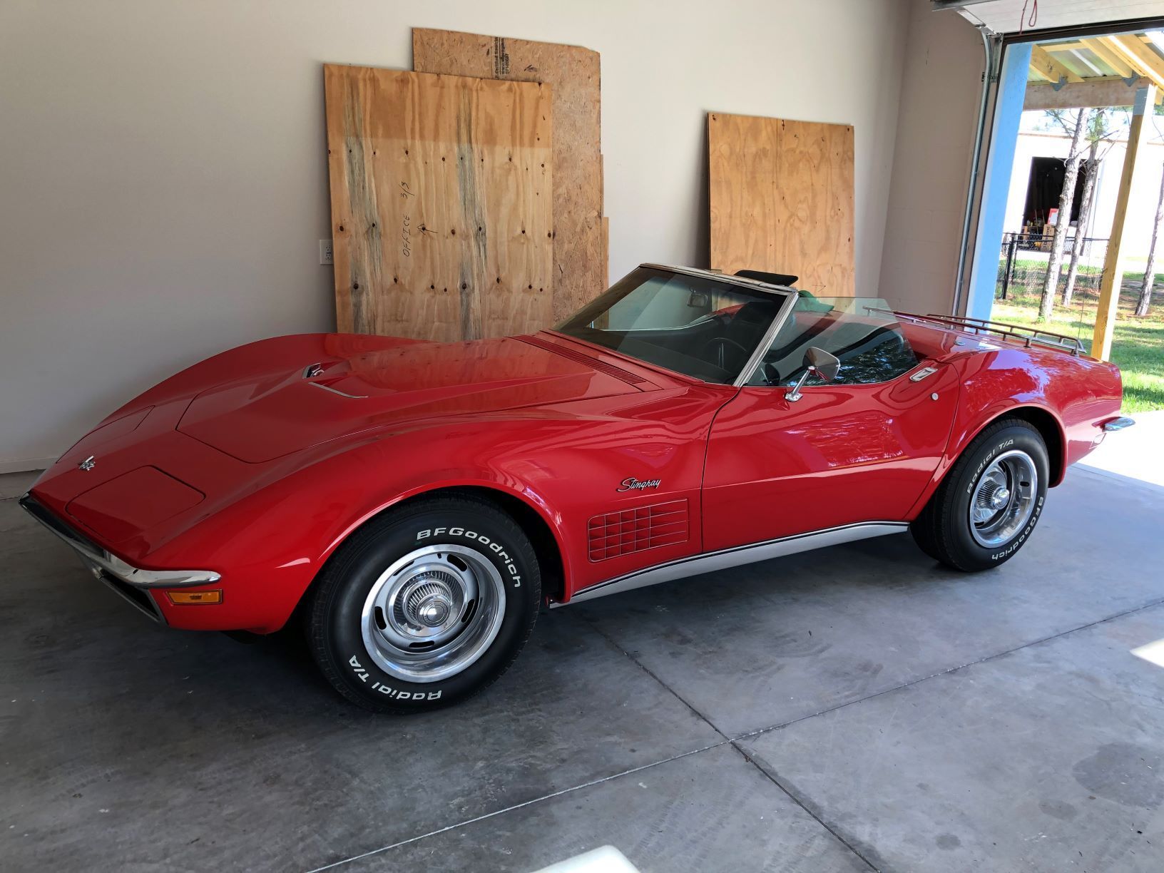

Hello,
I have a 71 C3 that is in very good condition but I’m having an ongoing issue with gas leaks with the EVAP valve that mounts to the side of the tank. Gas leaks out from the valve, runs down the side of the gas tank and drips on the top of the muffler....not good.
I’ve personally dropped the tank twice and replaced the valve but still have gas leaks whenever the tank is ½ full to full. (Full is 1” below the base of the filler neck).
The car is back for a second time at a well-respected vintage repair shop, still leaking gas after their repair. The work done at the shop was replacement of the EVAP valve, replacement of and rerouting gas lines, blowing out the line to the EVAP charcoal canister.
It resumed leaking after just two weeks of bringing it home.
Anyone experiencing EVAP valve leaks?
Seems there are no good quality OEM replacements, only cheap plastic junk.
Looking forward to your thoughts!
Alan
