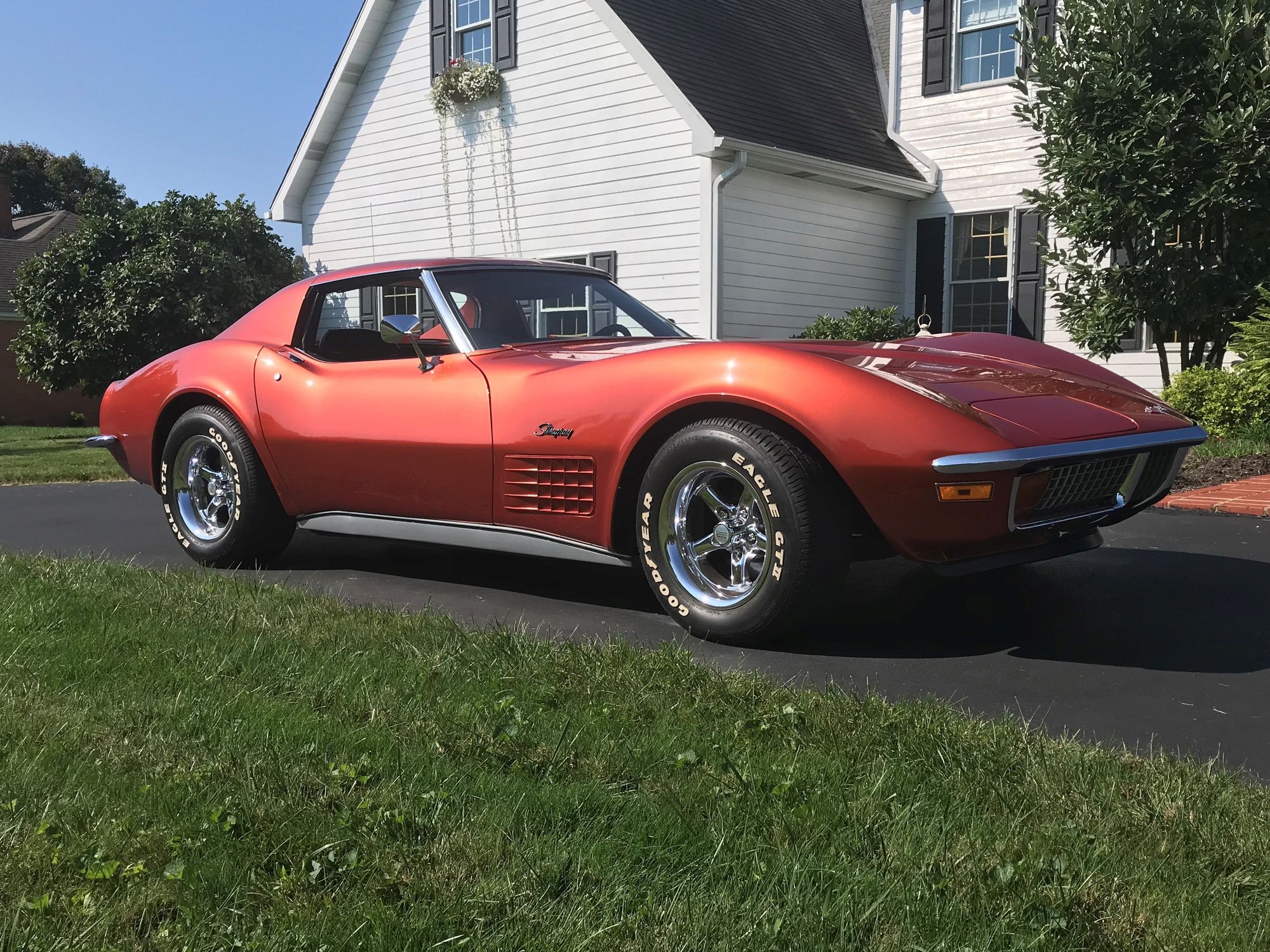

The left front of my 72 is sitting too high. I would like to lower it about an inch. I'm thinking of cutting the coil spring but I don't know how much. They are the stock springs and the spring is sitting correctly in its perch. The right side is good. What say all-knowing CF members?

Ok, a little more information: The frame was bent from a front collision before I got it. I had the frame straightened, he said the left front was bent up and in, but I'm not completely sure he did it correctly. Too late to fix it now! Anyways, the rear is pretty close as this was a complete frame-off rebuild.

Here is a pic of the other side:

OK. I'm not seeing an issue at the right rear.
I wouldn't do anything until I made ride height measurements to the frame and to the body, and rolled it across the scales to get corner weights. Something isn't right. "Fixing" it without locating the actual problem and addressing that could make for some other issues.
Does it drive straight? Pull to one side? Does it feel better cornering in one direction than the other? From what I'm seeing, I'm thinking some handling/steering issues are also present here.
