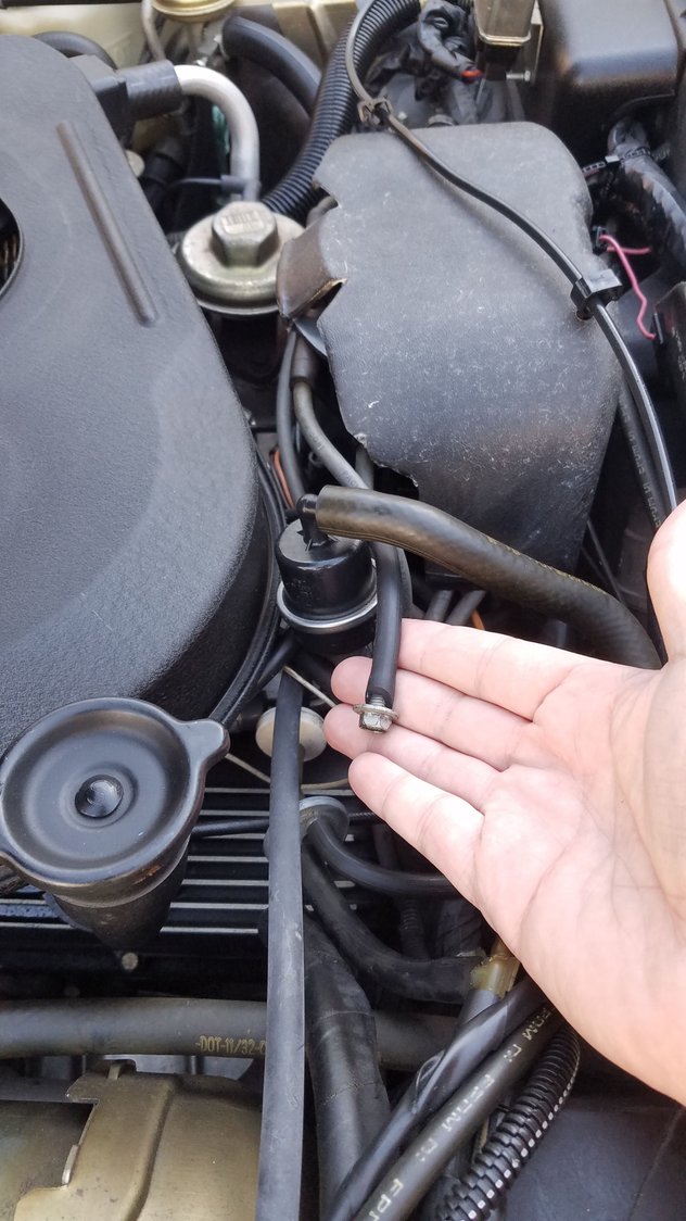

The headlights go up and down quickly. the idle is at 1000 or 1100 rpm.
It's a nine thousand mile car, so I'm sure I'll have to chase a few things here, no worries.
Thanks!

where/ what is on the other end of that poorly plugged line?
what does that line reach?

Too hard to tell what that line is for/from. Remove the aircleaner and take a pic of where it goes, plugged in at. But no, that is not for your brakes. The large line going into your booster is for the brakes. As far as the high idle goes, it can be a few things causing that. Do you get a check engine light at all? You may have a vacuum leak somewhere causing it as well. Things that may be causing a vacuum leak are...Bad top plate gasket (cracked) TB base gaskets bad, vac hoses bad just to name a few of the most common issues with CFI and high idle. May also be something going on with your IAC(s) as well. Let us know what you find. BEST thing you can do as a new owner is to purchase the 82 GM service manual. It has everything that you need to fix or maintain your 82. GL

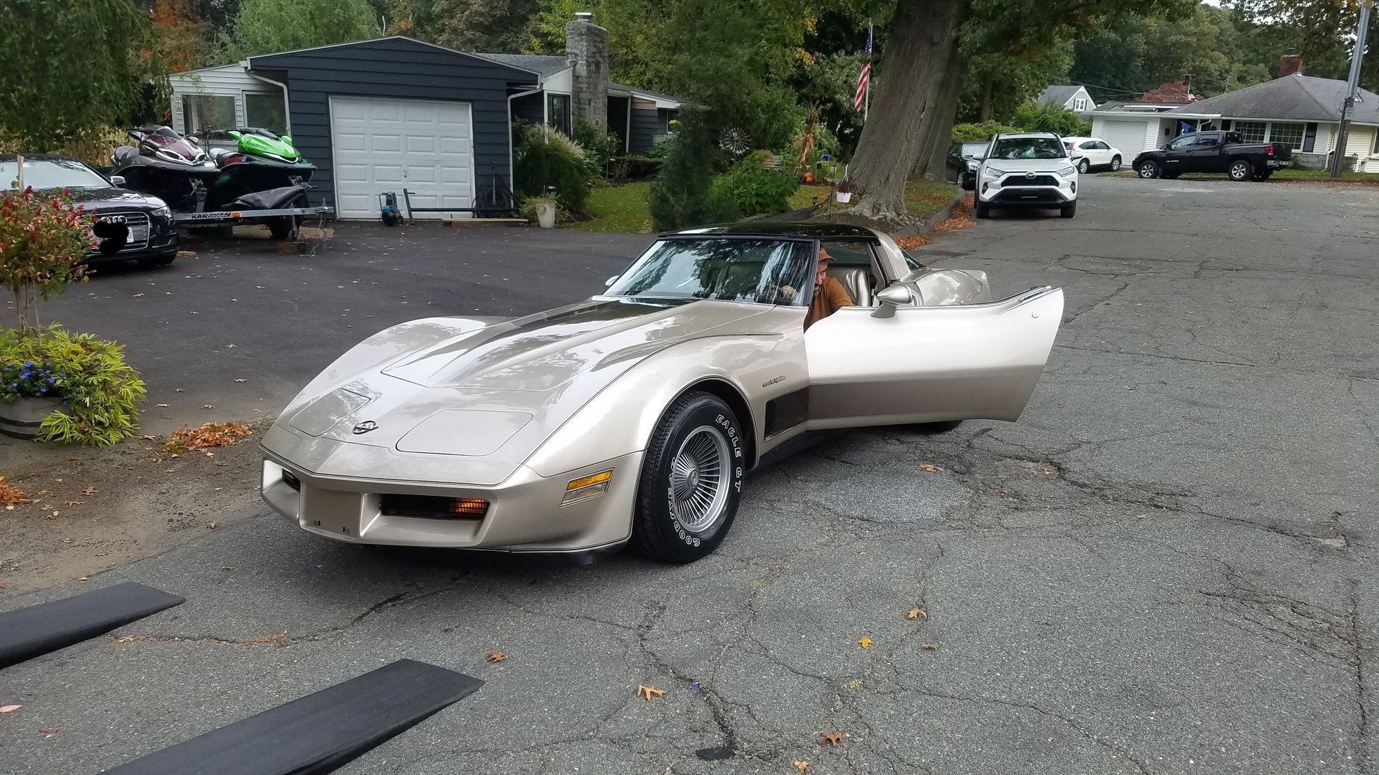

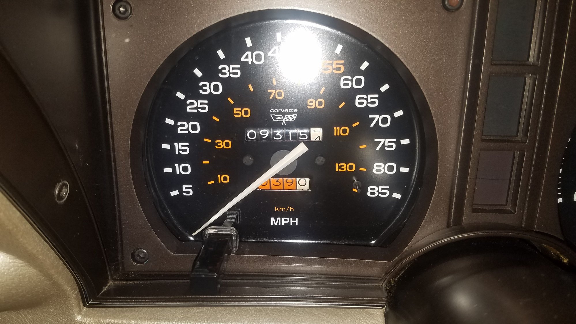

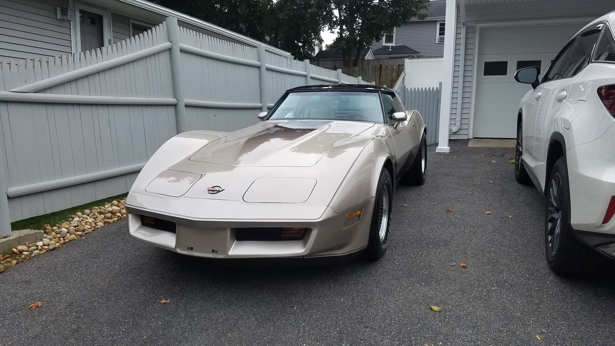

Would love to see some pictures of your 9k mile 82.
Old Oct 17, 2021 | 10:49 PM
Johnnyracer's Avatar
Johnnyracer
Joined: Jul 2021
Posts: 148
Likes: 107
From: Boston
Old Oct 18, 2021 | 12:53 AM
Buccaneer's Avatar
Buccaneer
Joined: Nov 2005
Posts: 3,532
Likes: 1,185
From: Arizona - If you don’t know CFI, STOP proliferating the myths around it...
Oh...It's a CE. Nice car. Wait until Hal see's this car, he will drool. Where did you find that jewel?
Old Oct 18, 2021 | 01:08 AM
Johnnyracer
Joined: Jul 2021
Posts: 148
Likes: 107
From: Boston
I should start a new "Hello" thread....

Here is where the vac line goes.....
its on the drivers side (picture is from passenger side) and goes right to intake
It's for the thermostatic air cleaner.
https://en.wikipedia.org/wiki/Heated_air_inlet
Nice car BTW!
Old Oct 18, 2021 | 05:10 PM
Johnnyracer
Joined: Jul 2021
Posts: 148
Likes: 107
From: Boston
Thanks! I'm not really gonna worry about it then...
