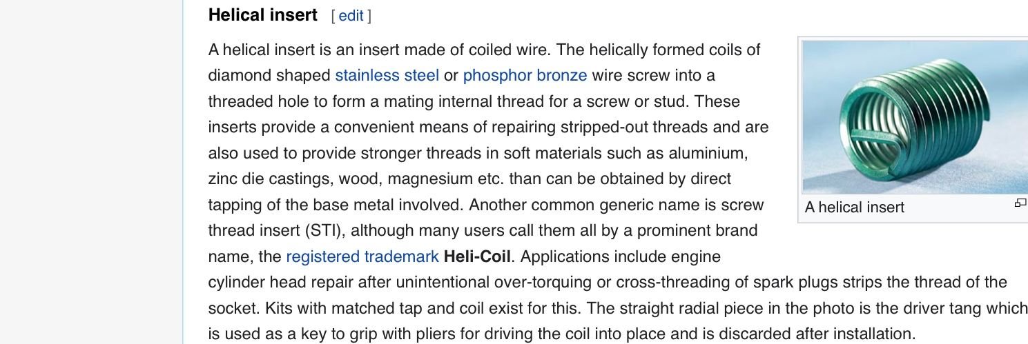

Thanks 62corvette but not sure what a helical is, never had to use one

Old Oct 22, 2021 | 11:34 PM

Since that bolt is going into a water passage, you will need to seal the Helicoil AND the bolt going into it. Usually, one would use Loctite on the Helicoil; but that won't seal water. You might need to use some epoxy on the outside threads of the Helicoil when you insert it. Be sure to wipe out any that gets into the inside threads....or chase it with a thread tap after the epoxy hardens.

Doing a Heli-Coil for the first time is not that exciting or difficult a job. Just go someplace like a NAPA store and they will have the proper size "kit" for the size of the bolt that stripped. The kit will have a "drill bit" to make the hole the right size and a "Tap" that threads the hole and an "Insert Tool" for installing the heli-coil in place. After you install the Heli-Coil you need to break off the tab used in the installation which is scored and breaks off easily. The trick is to use a long nose Needle Nose pliers to remove it when you break it off. If it does drop you can pick it up inside the manifold below the thermostat, just try and not drop it.
I "used" to build high horsepower Air Cooled VW engines and we used to install heli-coils for the spark plugs and the bolts that held the engine together. A "Boxer" style engine is a "split-case" that has pistons pushing in and out horizontally and the stress of extra HP required hell-coiling the holes before they stripped out.
Before inserting the Heli-coil I would use RED Locktite and coat the outer threads like I have for hundreds of heli-coils. I only had one spark plug ever come loose while working on VW's and that was due to the Locktite not bonding properly. This taught me to clean the holes with a alcohol wipe before putting on the Locktite.
