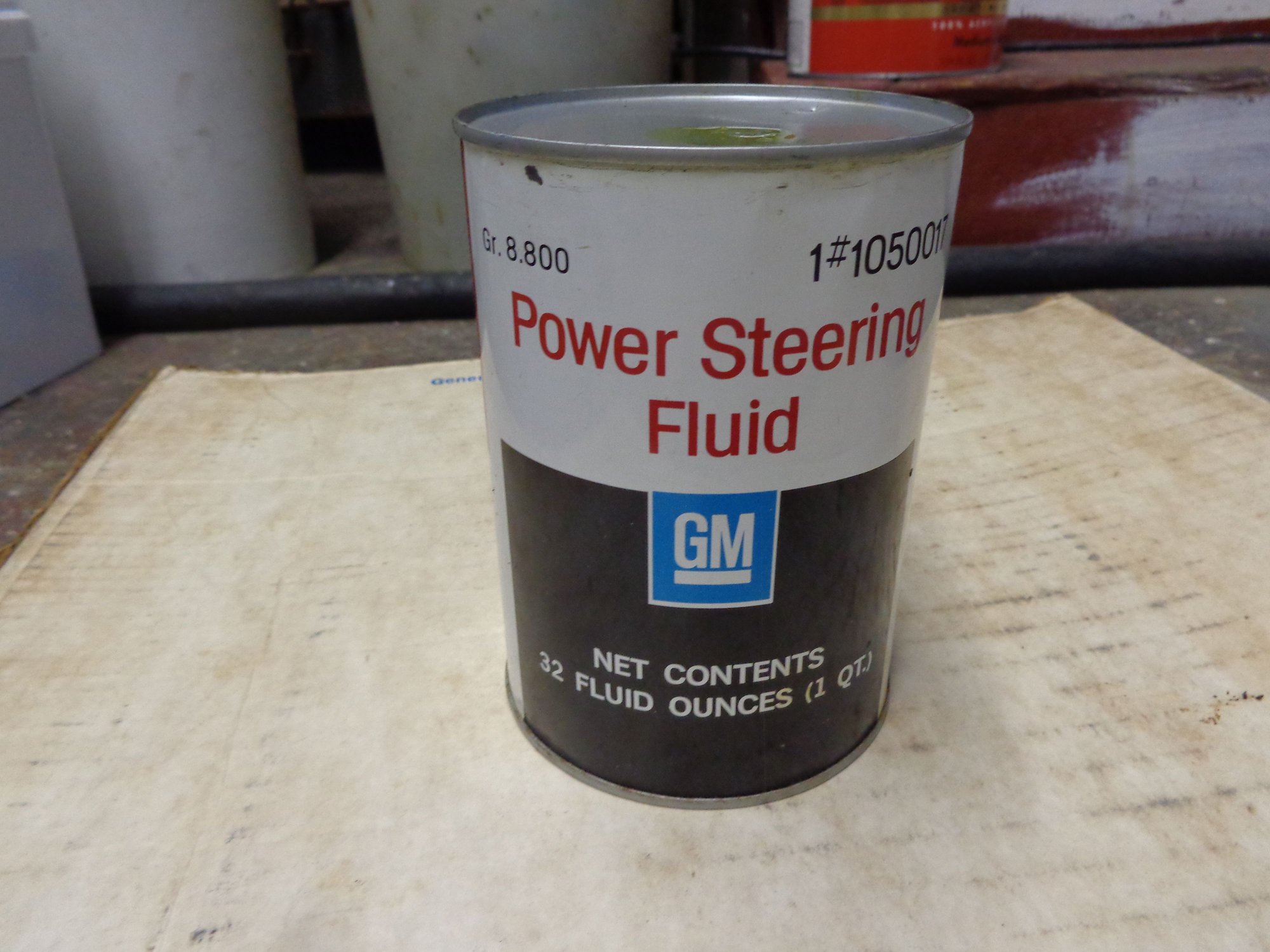

Hey, ralphspears, The General discontinued that stuff decades ago. Ask me how I know.
