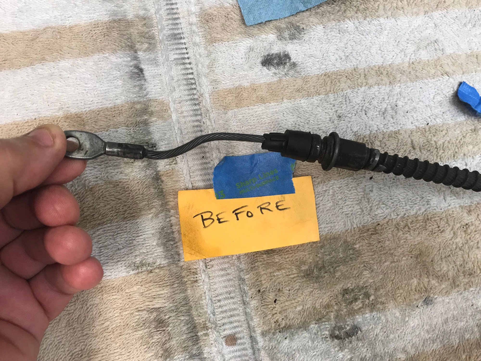

It is not happening with my original '69 interlocking spiral-wound cable. Lever is moving nicely since all the crud was cleaned out and the lever oiled. The wire cable moves freely inside the spiral-wound sleeve but I am pretty confident now that the kink at the end where the loop connects to the reverse shift linkage is never going to allow this system to function right.
Cable will not return to full retraction in reverse gear like in the Alan71 photos (photo #2) that 71 Green 454 passed along. My cable still has about 1/8" plus more distance to retract and will only get there by pulling on the steering column level as general ike suggested. It's a whole lot better and very close to neutral position so I can get the keys out of the ignition but still no cigar without a slight pull.
Moving on to Bergerboy's suggestion and replacing the interlocking steering column cable.
Assuming that at some point a prior owner attempted to force the cable to push the column lever all the way up and the cable kinked....then probably disconnected the loop from the lever on the steering column and left it that way. I think the best option now is to replace it.

KS, same thing happened on my '69. Car sat for 30 years and cable grease froze inside the sheath. Someone tried to force it and then the cable kinked under compression, and it's strength was gone. Solution was a repro cable from on the Corvette parts houses. New one's been working great for 10 years.

Replacement spiral-wound cable arrived from a donor '69 car, cable is in nice shape, cable moves freely, no kinks. Spent some time cleaning and oiling the cable. Removed the 1-2 and 3-4 shifter rods from the tranny linkage to make it a little easier to attach and position the new cable. Cable installed okay. Reattached the shifter rods to the linkages. Cable moves okay but is still 1/16" from the swivel-bowl on the steering column returning to neutral position without a very slight counter-clockwise manual assist with my left hand in order to remove the key from the ignition. More work to do.... sure was hoping it would work perfectly and I could move on to other items. Beside more cable adjustments that need to be made, the Reverse shifter now does not unlock and release completely going back to Neutral. Now I'll have to spend time making adjustments to the linkage too.

New '69 donor cable installed, it has full travel range of motion and I can now get the key out of the ignition switch with the car in reverse. Have cycled through the pattern a dozen times or so of insert key, unlock ignition, shift out of reverse to neutral, ratchet through the 1-2-3-4 shift pattern and return tranny to reverse and remove the key from the ignition. Wow, was that fun.
