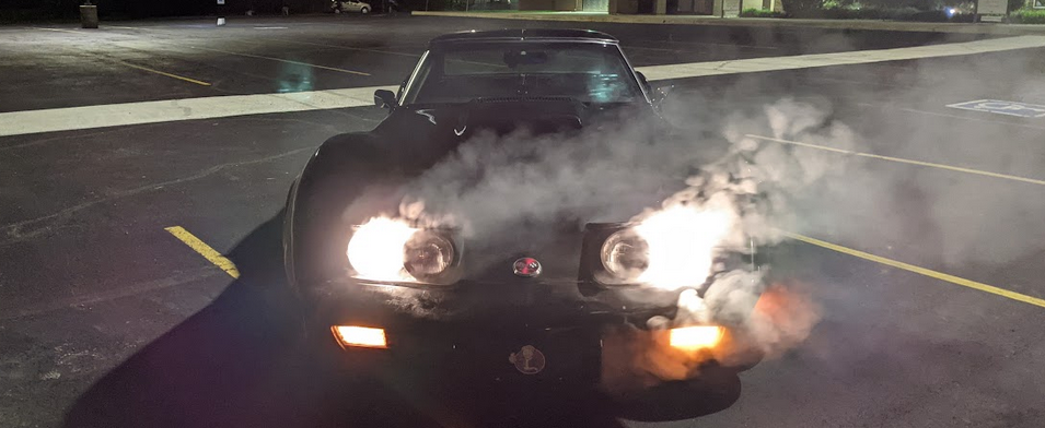

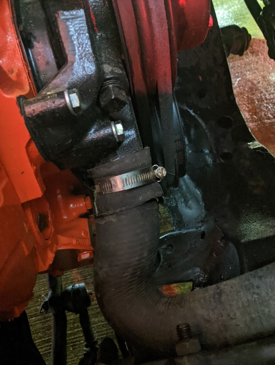

Took my 76 for a shakedown run this evening after a complete rebuild. Engine, transmission, and new FiTech TBI seem to be working great. Ran it through a local, good, carwash and as I pulled out I started to smell coolant. Pulled into the free vacuum area and BOOM steam everywhere. Blew the lower radiator hose at the water pump. Luckily where it broke I had enough that I cut it flush and reattached. Also luckily, the hardware store across the street was still open, so took a short walk for coolant and a funnel. When I got home, realized my electric fan fuse blew also and the hot steam started to de-laminate the underside of the hood in a few spots (but luckily no damage on the topside.)
So now my freshly cleaned engine compartment is completely covered in coolant. Joy.
Made for a cool photo though with the coolant burning off the headers!

The temp gauge does not work i found out, but the FiTech temp gauge does work, and I had it set to come on at 200. It clicked the relay when it was supposed to, the problem was the actual fuse for the fan was blown and i didn't realize it. The system did not get up to 15psi when the radiator cap should have started venting, somewhere between 0 and 15 psi the hose blew. It split right at the neck of the water pump so that was just the weakest point I suppose.

Nice pic except for the pucker factor involving steam and car engines…
