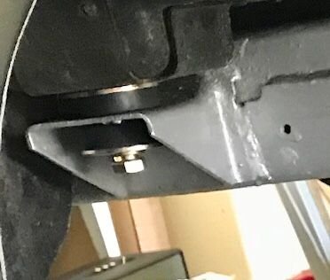

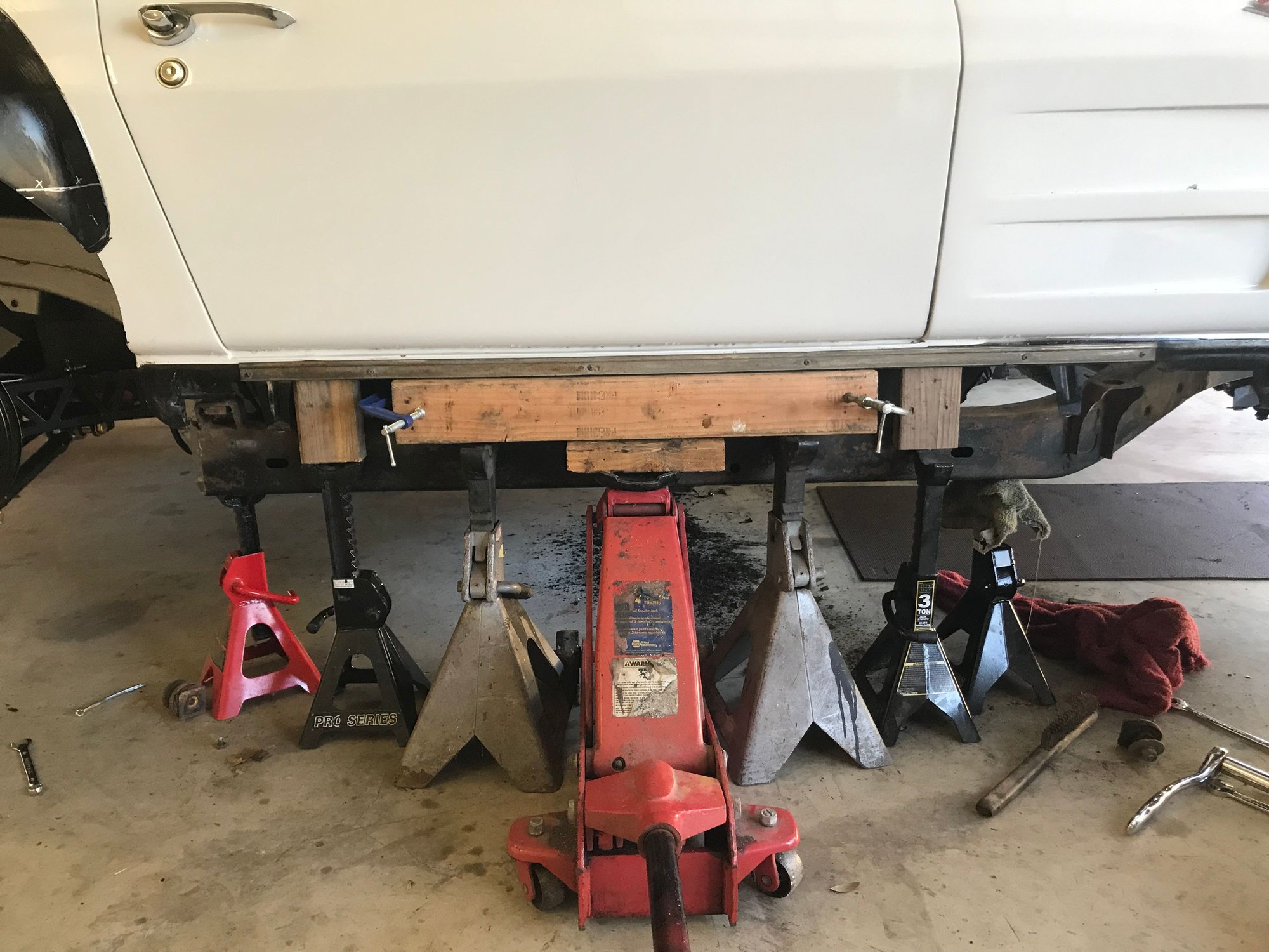

This is my ‘64, but same concept. I lifted it about 10” one side at a time.
Yeah, a little overkill but safety first! Remove all the bolts one the side you will jack up and loosen them all on the other side.
This is mount #1 on the passenger side after lifting the passenger side about 10”. I cleaned and painted the frame and sealed the inside of the frame, and replaced the fuel line and rear brake line.
I discovered this on the driver side, my rear brake line completely crushed, so it was replaced.
This is #4 on the passenger side when I was finished. Interestingly, both #4 bolts had fallen out and were missing!

Thanks for the pics factoid. Looks like you place the wood for jacking right up under the rocker channel outside of the frame ? Will be nice to have some new hardware under there. The painted frame looks nice also.
