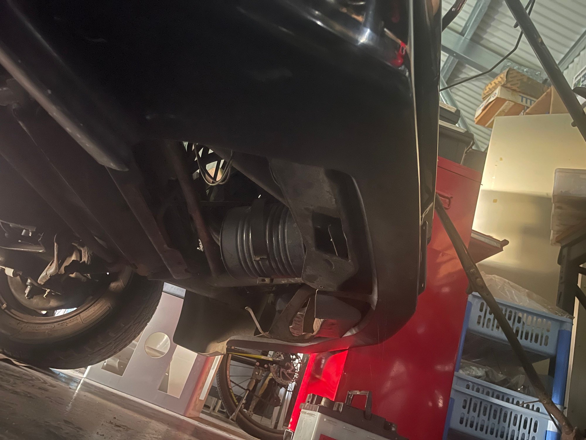

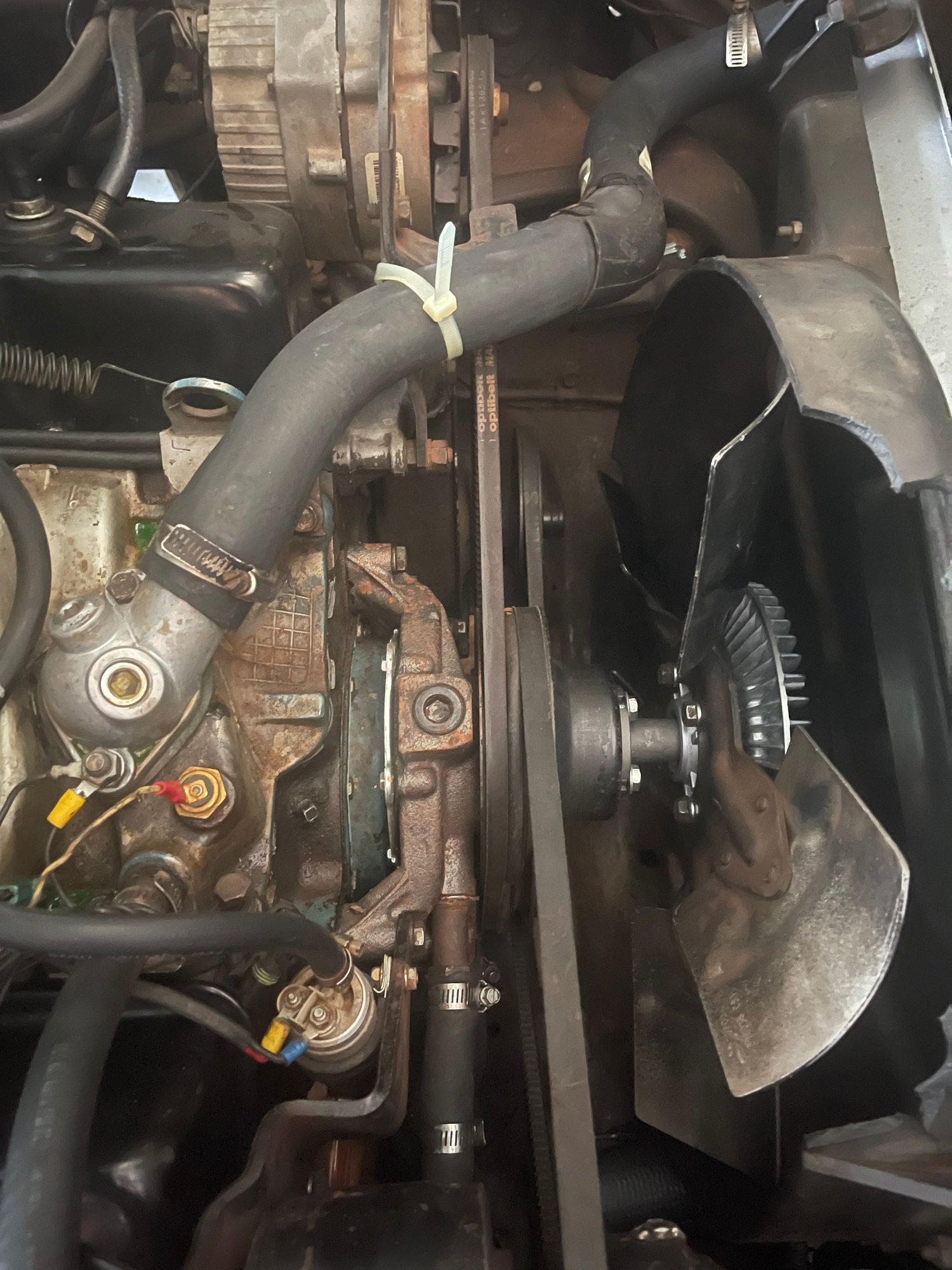

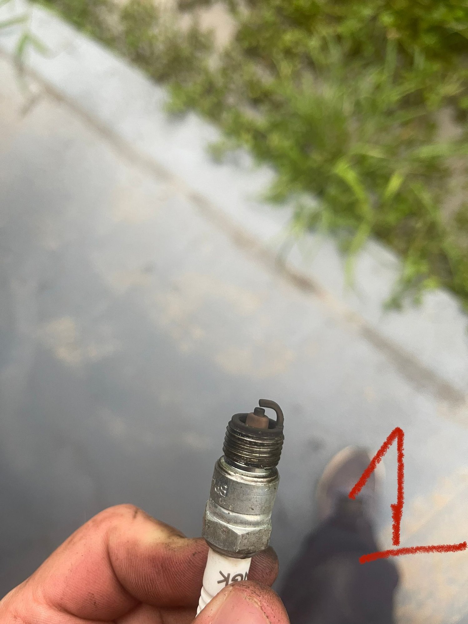

I have tried to take all the pics I could before it got to dark

I have revomed those plugs in those orders Damn forgot how hard it was to get to a few of them. it wasn't until I got to #7#8 that I had to bring the revs up that I realised I may have needed to bring the revs up higher when testing them all. But I watched and put my hand over the hole there was no steam and there was no water or coolant on my hands. I took a pic of each plug if that helps not sure what I am looking for here is #1

Here is my water pump. The broken shield happened after it started over heating it broke a engine mount and the fan went through the shroud

Here is what is behind the font bumper I don't think the spoiler extention or the defelctor is there I dread trying to get them in Australia but it might be the answer??

Thanks for the photos!
The water pump looks correct. It is the correct "depth", right up against the timing cover, so I don't think that is the problem. The fan blades are pitched correctly of course.
You are missing not just the rubber "lip" on the lower extension, but the extension itself. I think that's called the "Center Valence Panel", or perhaps "Lower Bumper Extension". The rubber parts are the "Front Lower Spoiler Air Dam Extensions". Links below, with a photo of what it looks like in my 80 (mine was replaced by a PO, and says Ecklers on it somewhere, so shearing them off appears to be a common problem).
