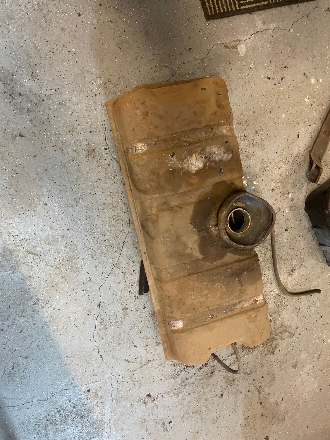

Do you think I should replace the tank? It doesn’t leak but it is rusty. And if I do mine has a vent return line, is that important?

Looks like it’s out already. I would go for it if you have the funds. Ecklers or Paragon are good resources for tank kits. The vent line is a Big Block only feature, so make sure you purchase a Big Block tank with vent return.

Get a Quanta tank, they are made with the correct GM dies. That is not a vent line, that is the extra anti-vapor lock fuel return line from the special gas filter by the engine that has three ports. Lou.
