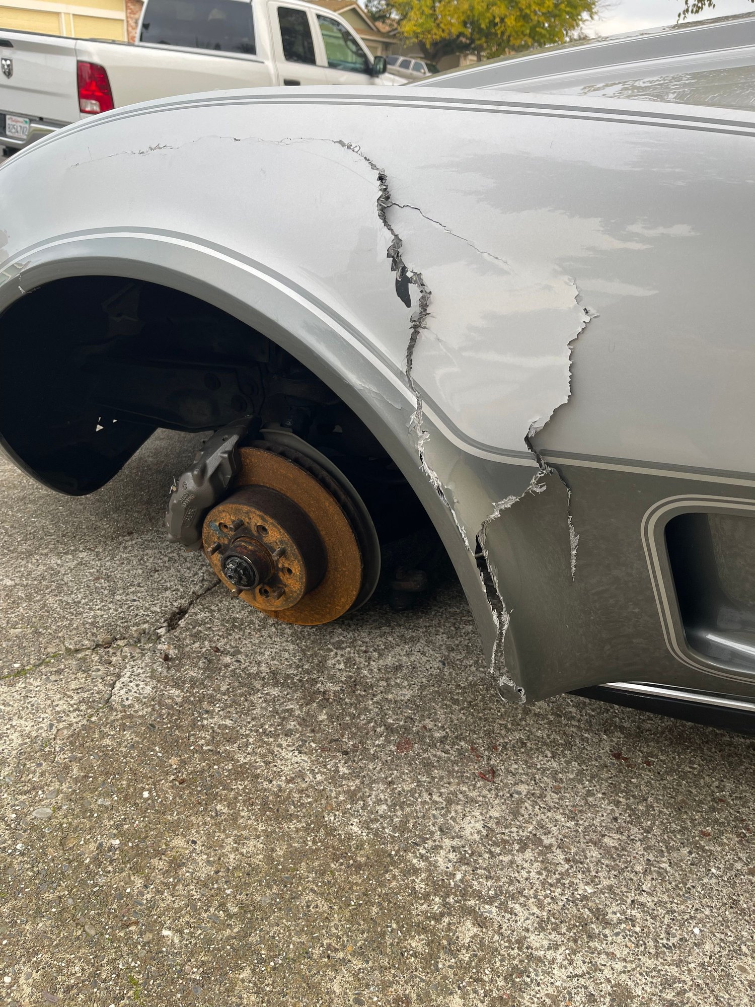

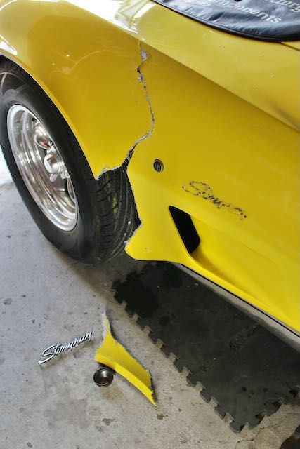

I am considering buying a 78 vette with a damaged left front fender. His wheel fell of while driving. I see I can buy new fenders for it pretty cheap. Can I cut out the damaged area and put in a new part in that area, cut from the new fender? I watched a video about replacing the entire thing, but that's a big job, I just wonder if we could us a part of the new fender, then blend it in? This is all new territory here for me. The rest of the car of perfect.

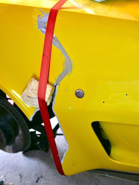

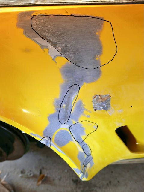

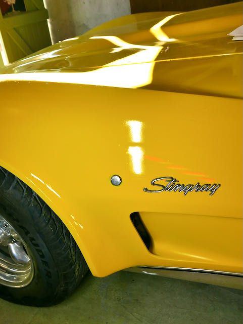

The same thing happened to me, and what made it worse was that it was my own stupid fault. I'd had the car on stands for about 3 weeks and didn't properly tighten the left front wheel when I put it back down. After five minutes of driving, terrible noises, left front drops down and I had to use the door to push the tire/wheel away from the car so I could get out and see exactly what my carelessness had cost me.
I live in Europe, so not much hope of a shop with the right experience, and I decided to do it myself. Not a lot of fun, but, even an honest friend of mine who saw the car before and after says it's pretty damned good. Paint matching the original was almost impossible, so I stopped at the top fender crease and then back to the door/fender crack. With the light hitting it from above, the new paint and old paint are seen from 2 different angles, and it looks normal.
For what it's worth, I'd repair it. If you match the old and new paint at those pin stripes, it should work out really well.
My car's a more or less daily driver, and it's 45 years old, definitely not a show car.
Anybody who funds fault with it probably drives a Hyundai, so who cares?

Default Left front fender
Left front
Left front

As nice as that car appears, it is worthy of a proper repair on that fender. The right person will have no problem replacing that fender in a manner that would be nearly if not completely undetectable. A "spliced" fender would be quickly detected and cast a shadow of suspect on the car to future purchasers. I think blending and matching the paint will be the greater challenge and you will have that regardless of your method of repair. Chip.

first, where are you? this whole nose can be found cheap, but shipping makes free parts very expensive when this big a part is involved. the nose is a big job, but takes much less actual body work. the damage across the top is right at the bonding strip where the fender is attached to the hood surround. so the whole fender would be an easier repair than tryna patch the damage where the damage is. but a patch panel loike this: https://www.ebay.com/itm/15393784155...4AAOSwllZewtGt will take care of most of the bad stuff. if you were to try to do this yourself, you need to accept that the first version will come out less than perfect. but you need to learn glass work somewhere.

The fender damage is repairable. I would be more concerned as to how the wheel and tire came off.

If you can find a used fender locally. Or a partial fender to make the repair yourself, that would be good to gain experience. If it doesn't look exactly correct when you finish the repair, a body shop may be able to smooth out your repair and paint the fender..

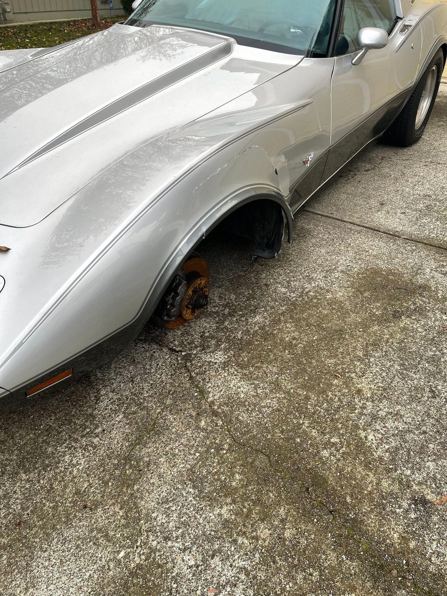

Judging from your pictures, I would say this is a 60/40 split between repairing vs replacing the whole fender - meaning it’s close to a toss-up. If you are planning on doing it yourself, IMO it’s a no-brainer to repair as evidenced by hdeoyng’s post. Done correctly, you’ll never know it happened.
Whichever way you go, be sure that the fiberglass repairs are done with an epoxy based resin. Your car is built with SMC (Sheet Molding Compound) panels which are NOT compatible with the polyester resins that are used with FRP (Fiberglass Reinforced Plastic) panels that were phased out by 1973.
Silver paint is the absolute worst to match. You can try to have it matched but I would seriously consider a respray of the entire left side.

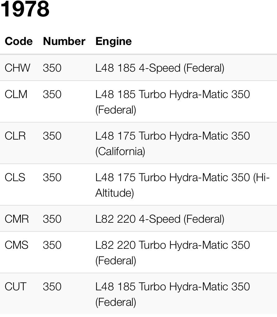

The L-82 option put a badge on the hood. Look at the engine code on the front right side of the block. Should be CMR or CMS if an L82.
