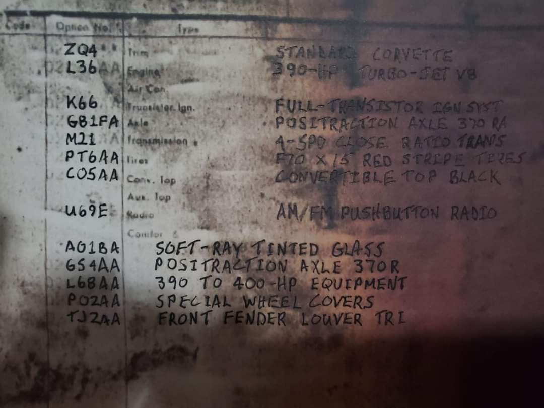

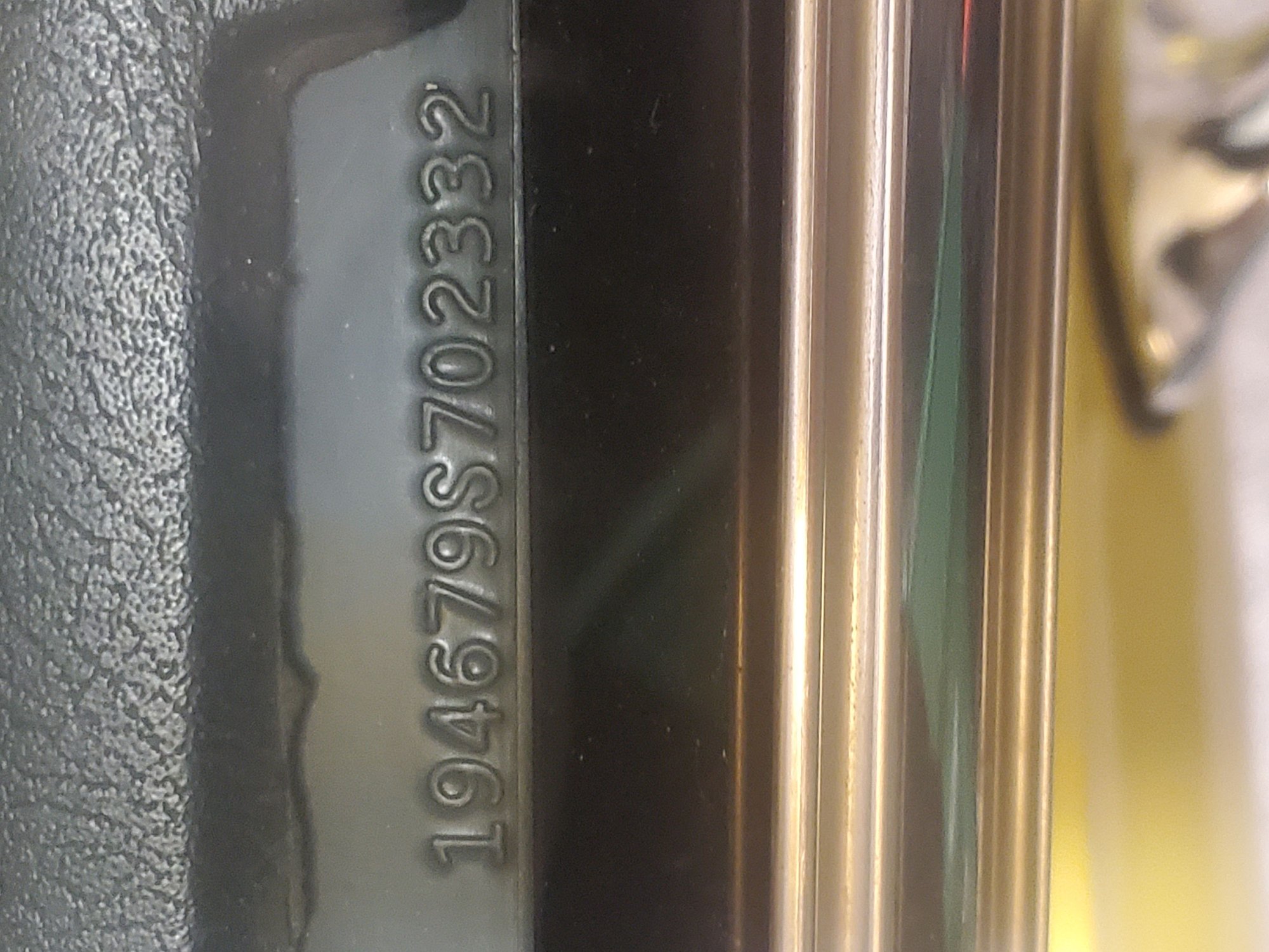

More pics/info...tri
m tag, Vin and copy of build sheet.

IM is for a 68 L36. Your car is a 69. It should be an LQ for 400 hp cars with standard ignition and MK if you car has transistorized ignition.

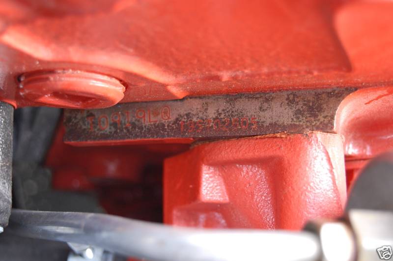

According to your Trim tag the build date is September 21 1968. Your engine stamp is Jan 11th which would be incorrect for the car. Here is an original engine stamp for an original L68 standard ignition car to compare to your. Now, your car is early and does have TI according to the tank sticker which was unusual and there could be a case for a factory grind out. But I am not seeing that with your stamp. What is the castling date of your block? Also, can you post a clean version of your tank sticker?

Wow....lots of good information, but still confused as to what I really have. So, here goes with the story on how I got the car and info. No, I did not write over the original build sheet and in fact, I do not even have the original build sheet. That is a copy that was provided to me from a previous owner and the original was lost sometime along the way. Based on responses, I question whether this build sheet is even for this car??? So here goes....

1969 Corvette VIN 02332 was built approximately Sept. 24, 1968, according to the C3 Birthday Calculator. The assembly date stamped on the block, 0111, is Jan. 11, 1969. It is impossible for an engine assembled in Jan. 69, to have been installed in a car built 4 months earlier. "IM" was the suffix code for the Corvette 427/390 in 66-67, and the 68 427/400, but in 1969, "IM" was the suffix code for a 350 2bbl in a Chevrolet passenger car (Chevelle, Impala, etc), not a Corvette big block. As DKM-106 pointed out, your trim tag has a body build date of Sept 21 (B21), which fits perfectly with the car's assembly date of approximately Sept 24, but not with the engine's January assembly date.
