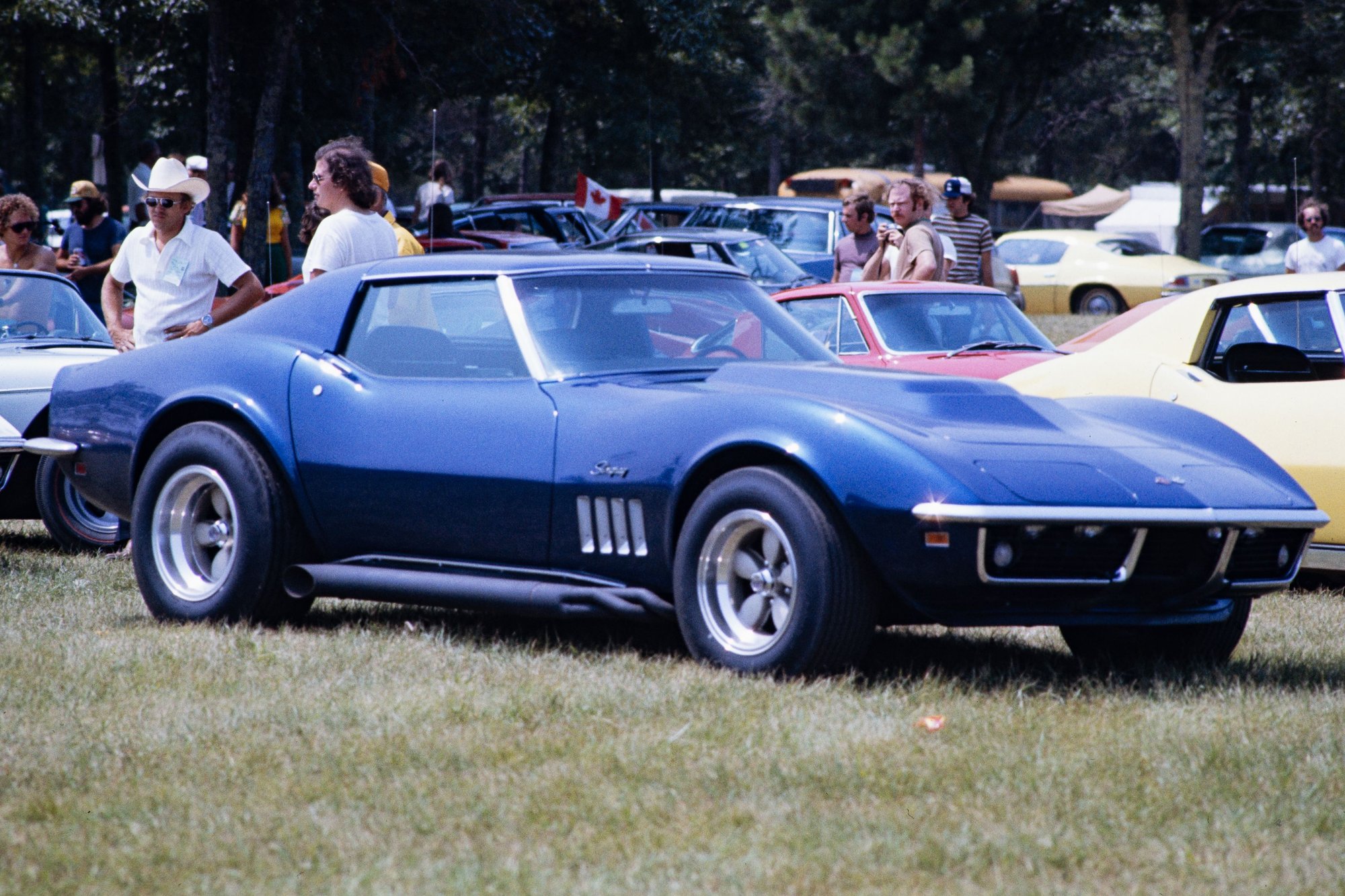

This is my car in 1975. L60x15s on 10” on the rear and G60x15 on 8.5” on the front. No suspension alterations and other than a very slight kiss rub on the fronts at full lock, no issues.

Good looking car. I like your wheel choice. I just sold the exact wheels, in the same size that I had on my old trusty Ranchero. I took 120.00 for them and the young man had a smile from ear to ear to have those 'big 'n' littles'. And the hood is my all-time favorite.

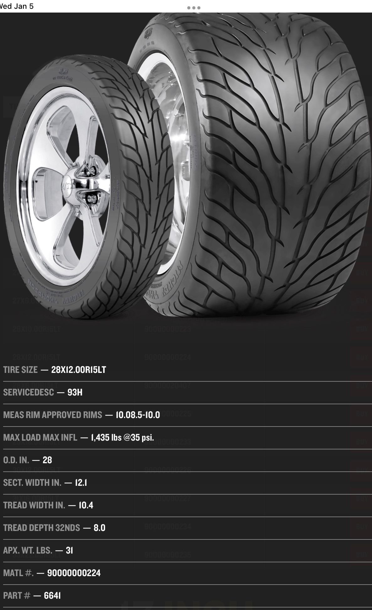

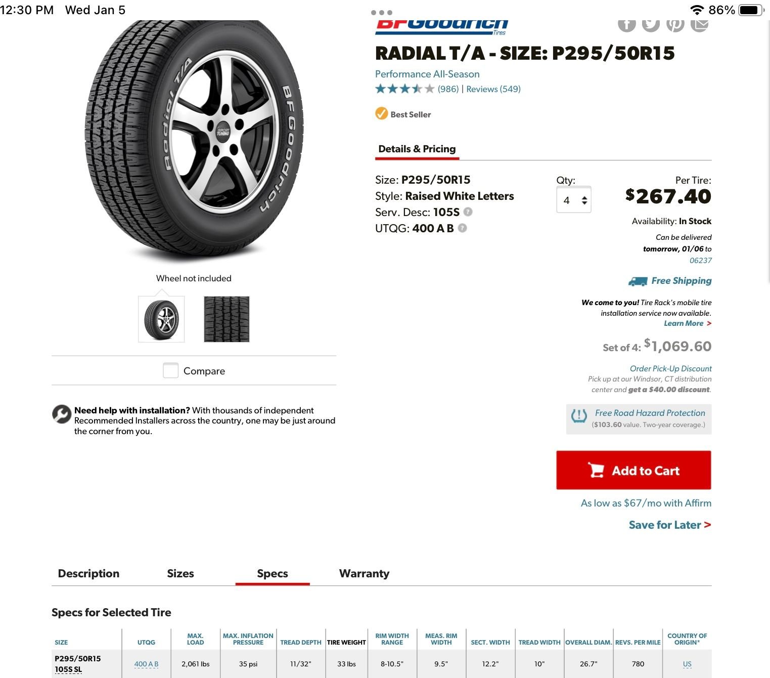

Respectfully disagree with your “no issues”. True, you can mount the wider tire but tire manufacturers will almost always provide, in their specifications, a rim width range and a recommended width.
In the two examples below, note that for the Radial T/A, the range is 8 to 10.5 and the meas(uring) width 9.5. For the Mickey Thompsons, the range is 8.5 x 10 and the meas(uring) width is 10. There is a reason the manufacturers provide the “measuring” dimension because that is the width the engineers chose as the optimum for the size of the tire.
I used to work for Goodyear and I recall being trained in on this aspect. When mounted, the middle of the sidewall should be the at the maximum section width. FWIW, IMHO too wide a tire (relative to a rim’s width) looks out of place but that’s just me.

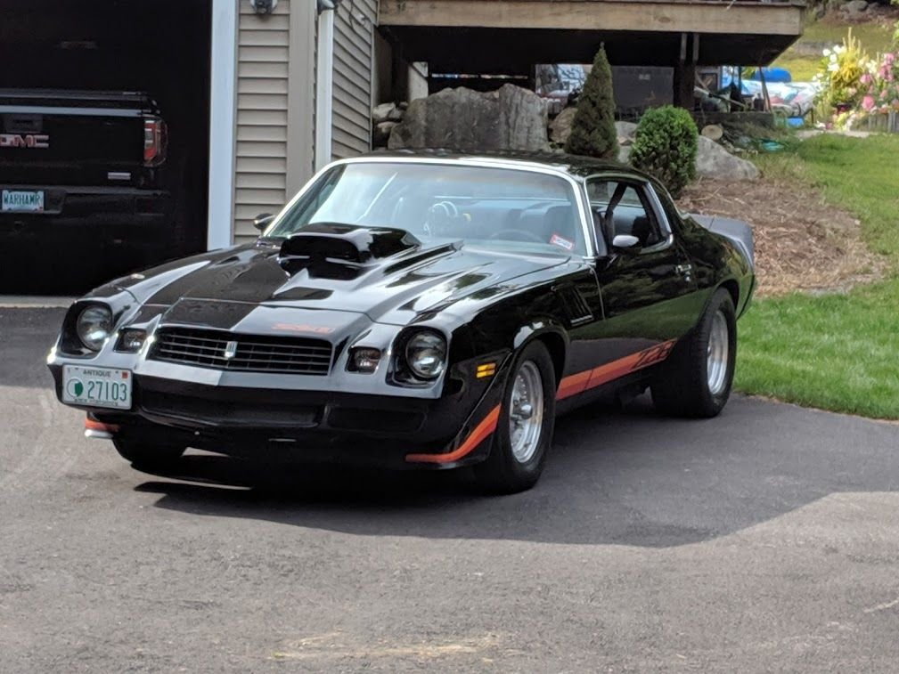

I currently have 295/50s on 8.5" Centerlines on the back of a 79 Z28- they work just fine.
I'll attach a pic.

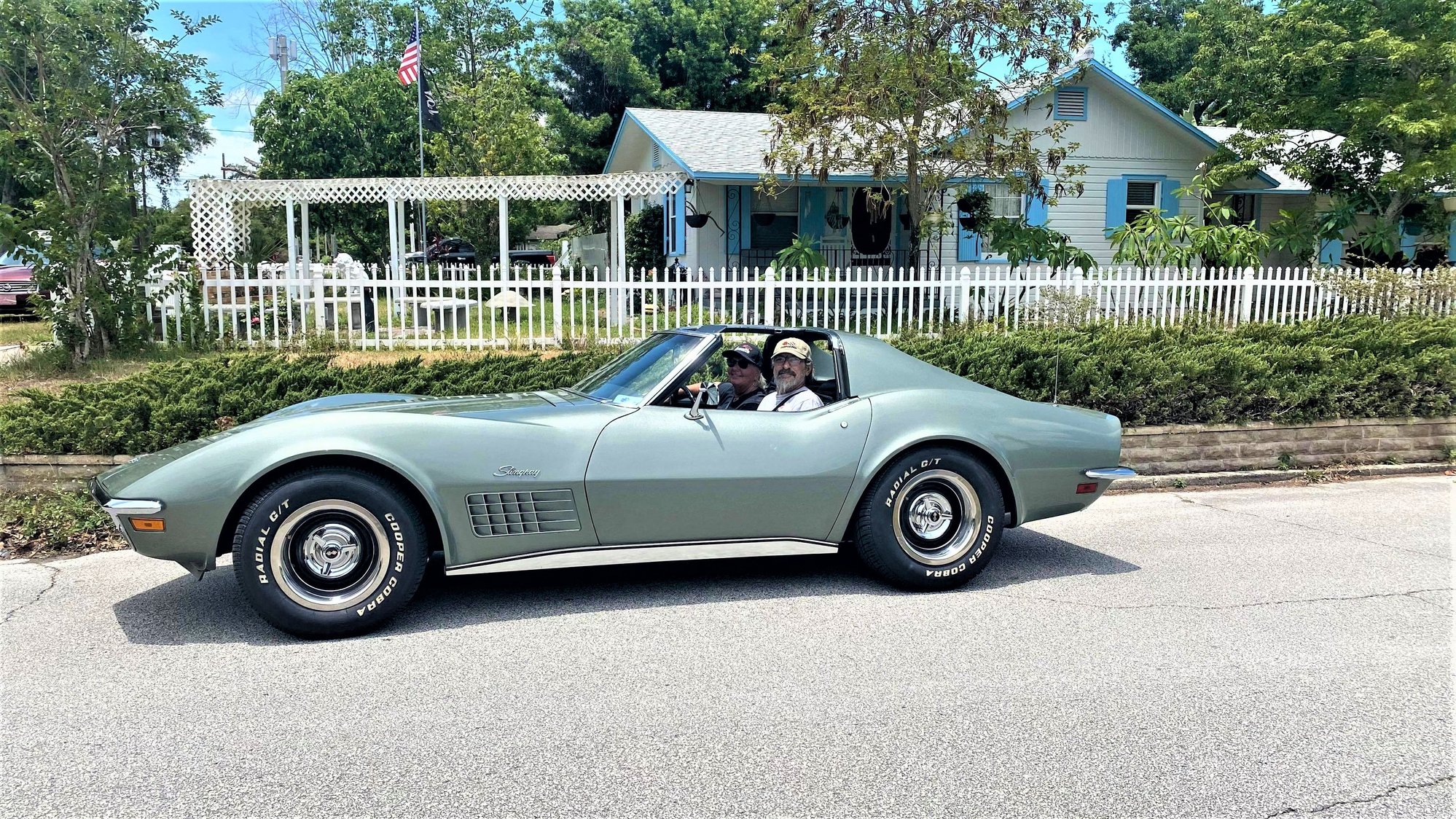

These are 225/70/15 on our 71.... they look too tall?

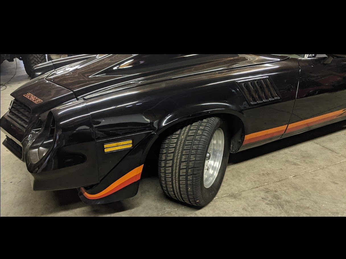

These pics might be helpful. Yesterday, I decided to change up the look on this Z28 for 2022 & see if I could fit a 295/50R15 on the front of this car.
They fit, with no (static) clearance issues. These tires are mounted on 15X8.5" rims with 5" backspacing.
Going to a 15X10 with same size 295/50 for the rear.
Be curious to see how these wheels would look/fit on the '69 Corvette. I'll throw them on and post some pics.

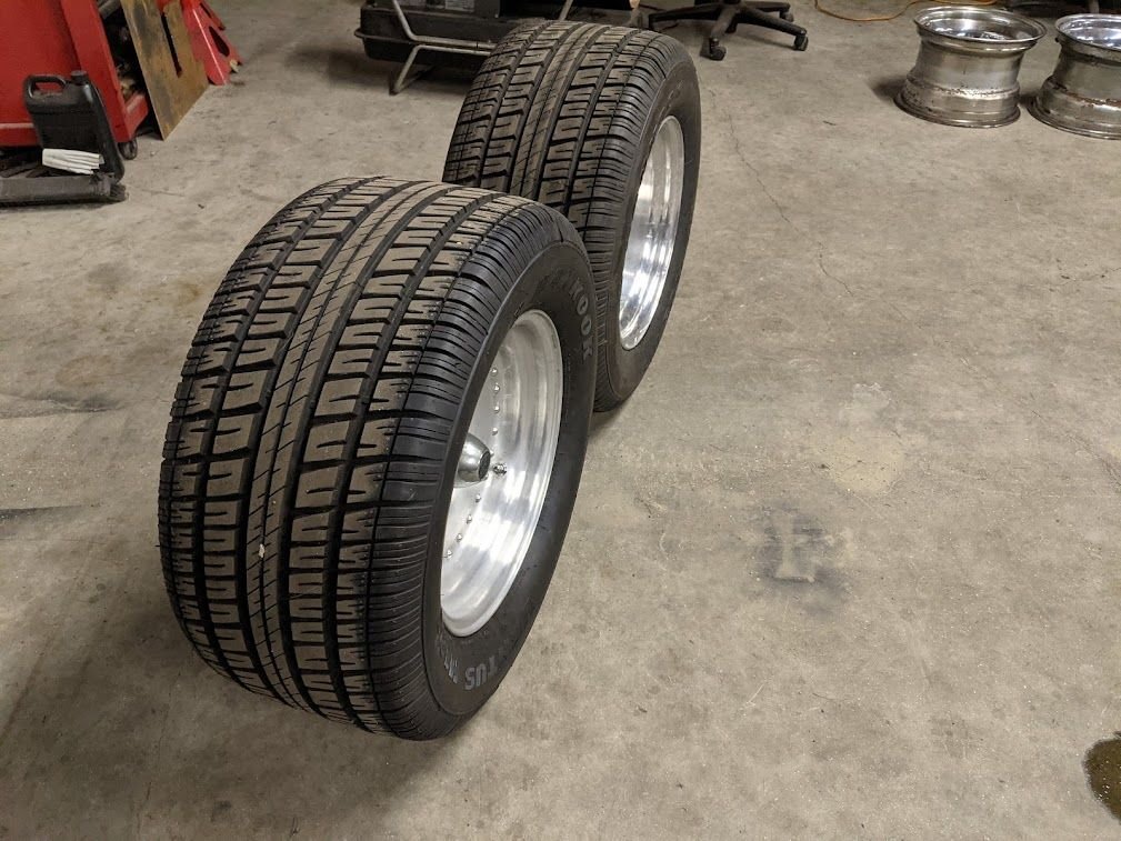

Thought some folks might like to see a pic comparing what the same P295/50R15 tire looks like on a 15X8.5" rim vs a 15X10 rim.
Both rims are Centerline Auto Drags.
