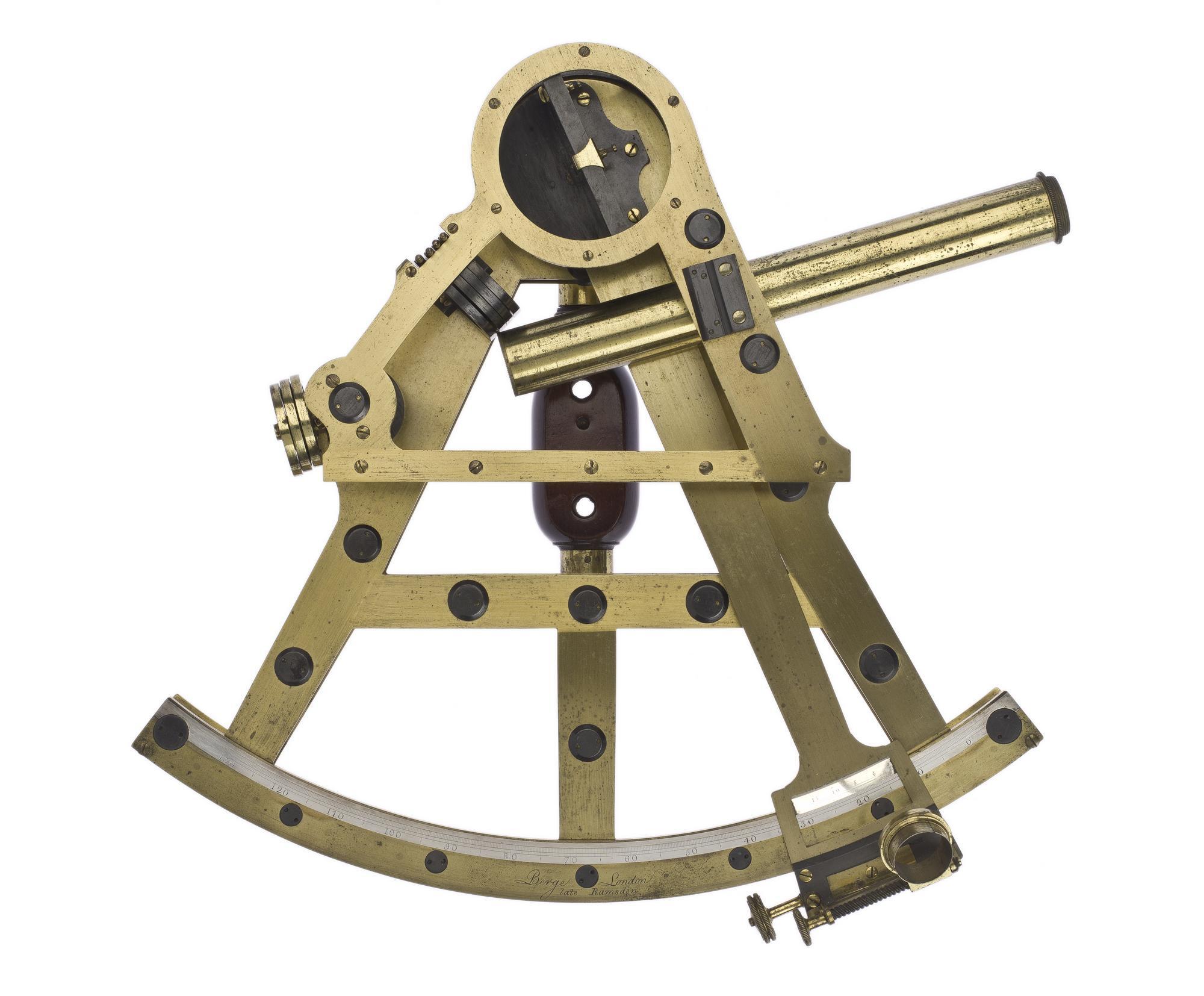

And for measuring the door gaps....

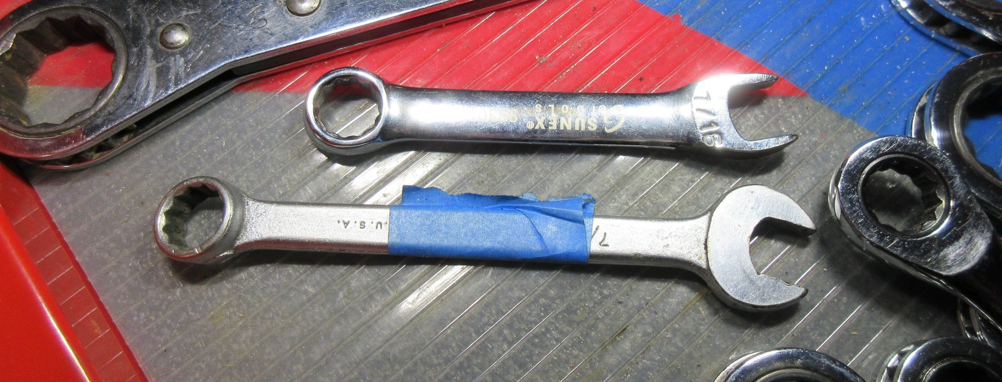

Made this years ago and between all my C3s, my friends cars and The guy in town that works on a lot of them, we have used it more times than I care to think.
Steel rod bent perfectly to trip the hood latch when any of the release cables are seized or broken. Taped so nothing scratches and the red tape marks right where it lays against the windshield pillar.
Also two 7/16 wrenches. The one with the blue tape is just the perfect length and the other has been ground down. These are home made special for the dozens of outside door latches I have changed.
