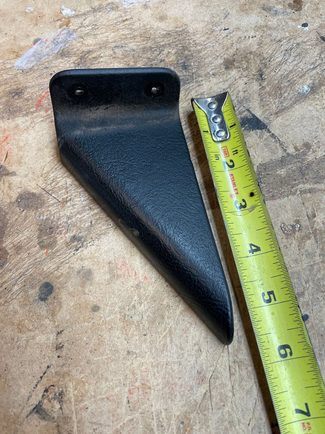

Welcome to a new episode of "What's This Funky Thing!"
Almost done with the Vintage Air install and can't figure out where this thing goes. Help!

Scientific wild *** guess..... Protector Shroud for the condesation drain tube that is supposed to go thru the tunnel/floor.

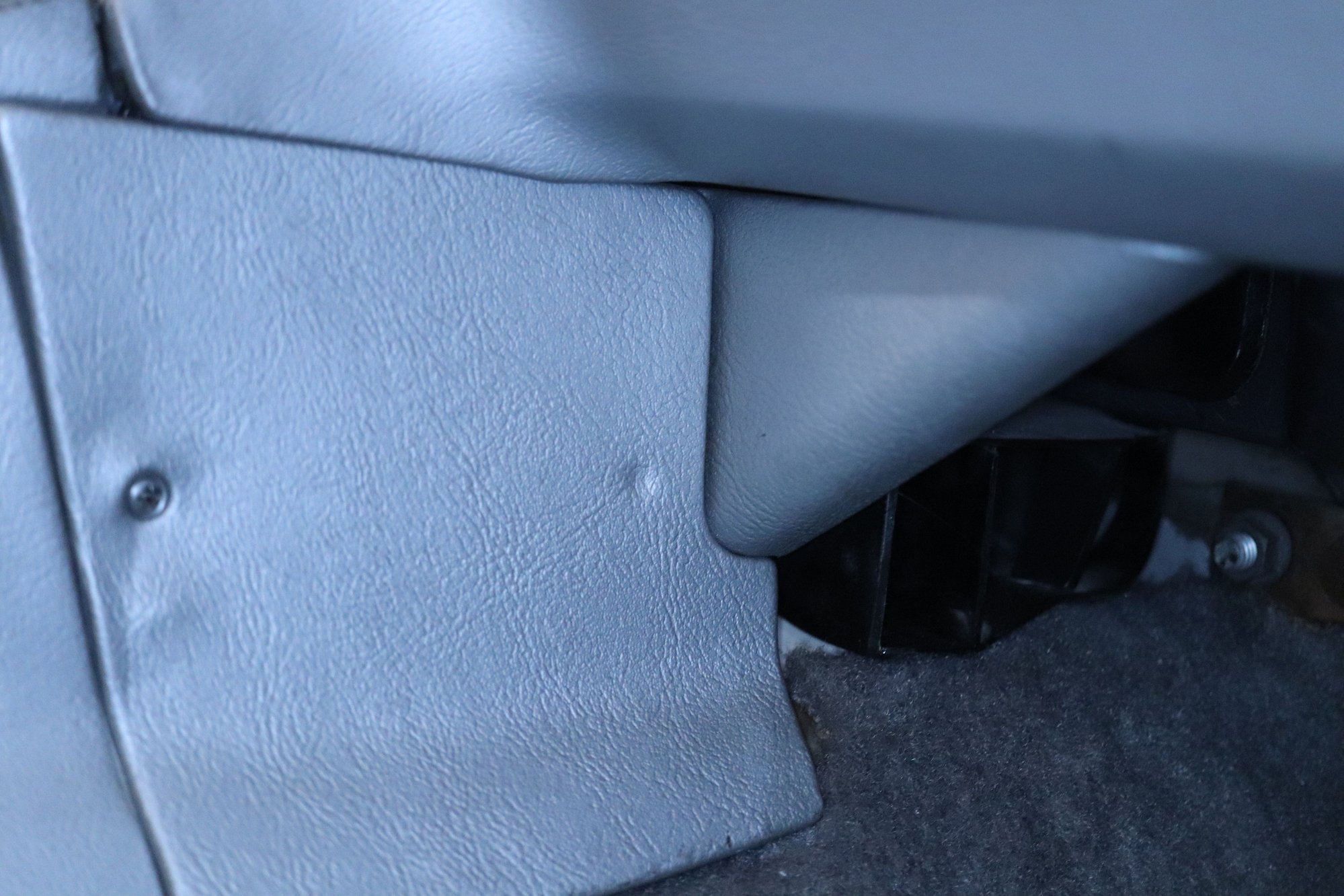

Covers the edge down at the side of the console, passenger side up at the front

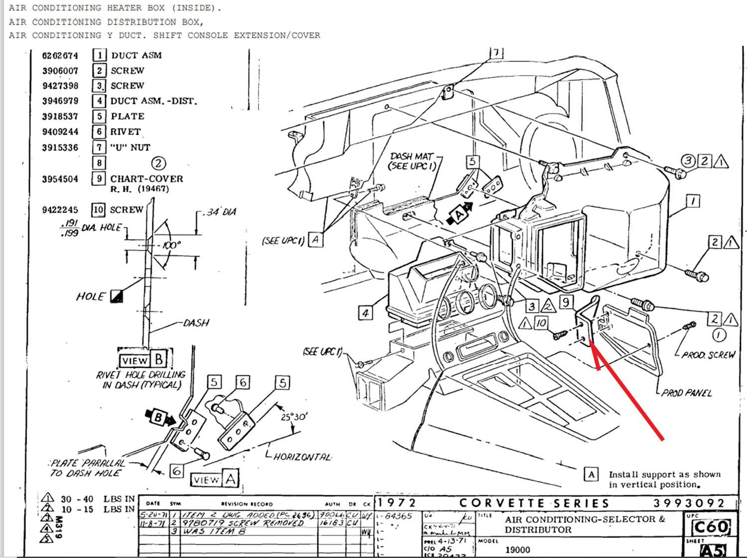

Correct, Mooser. It is called the forward console trim pad extension. It is used on convertibles with A/C. It conceals one of the convertible with A/C-only cross braces located behind the passenger side lower trim panel.

Just right...thanks!
