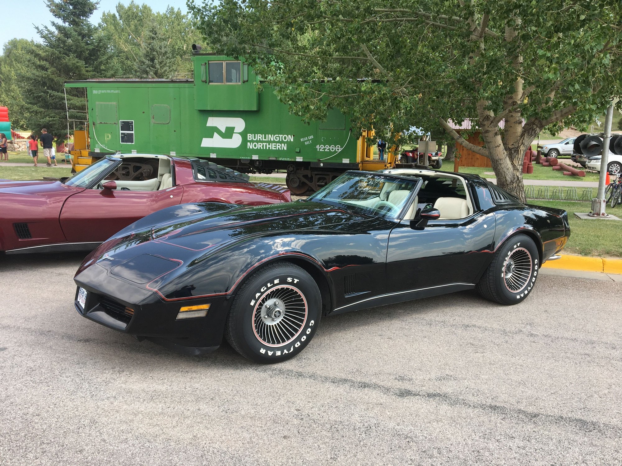

!980 rocker panels are black with a polished top strip.
