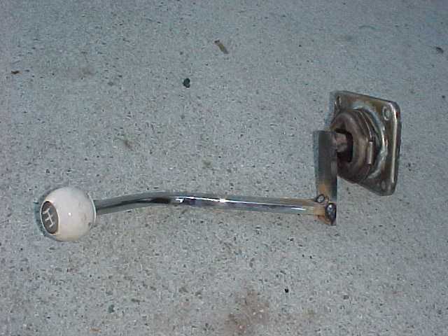

Yes, it comes up and to the left a few inches. I got a Ford t5 stock shifter off ebay for a few bucks because where the stick attaches it is vertical, not slanted like the camaro and firebird (because I mounted the trans straight)
A hole, and a lil tab to bolt a stick to is all it took. Later changed it to a vette stick to look the part.

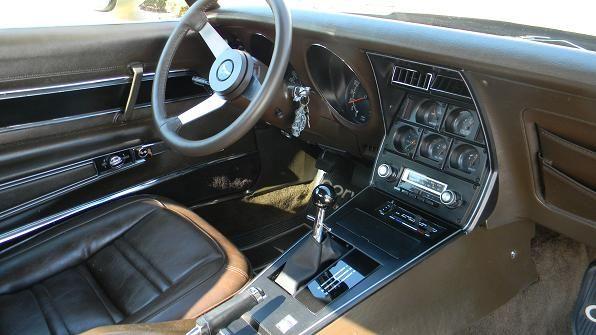

The shifter location is no problem as you can see. And The T5 will last if you don't abuse it. However, have you done a 95 mile commute in a C3? Besides the comfort, reliability, and safety issues, have you considered the cost of fuel? Even with tall gears, and at 60 mph, 15 mpg would be optimistic.

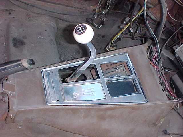

I see your setup my issue is the tunnel appears to have been cut to allow for the welded shifter linkage. I can't do that because that section on my car has wiring and electronics physically mounted to it. It's worth considering.

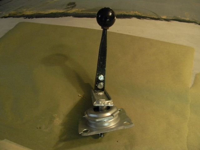

My car was originally an auto, as stated. I had to cut the tunnel for the shifter. The GM WC T5 was mounted on an angle in the Camaro, I mounted it straight up in the C3, Hurst sells a Blackjack shifter specifically for doing this. I modified the auto shifter plate just slightly to accept the stick.

The McLeod box is loosely based on the T5 and i had to notch my shifter hole to the right and modify the shifter bracket just like the T5 guys
