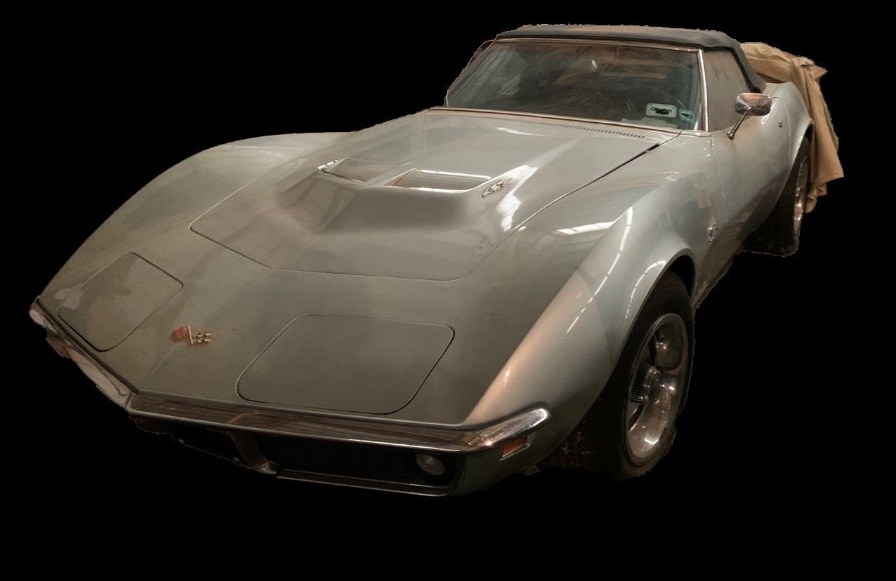

Thanks, everyone. As this was literally my first post ever - I guess I know how to get people's attention! And I truly appreciate your thoughts.
To answer some of your questions:
  1. I'm in the Rochester, New York area - about 90 minutes East of Buffalo and the Buffalo Bills
  2. The shop (dealership) I'm looking to take this to is Van Bortel Corvette in Macedon, NY - and yes, there are old guys working there (Link: https://www.vanbortelcorvettes.net/v...ettes-service/ ). I believe Van Bortel purchased Turner Automotive Corvettes that was in Victor, NY. It's also my understanding that in their shop now is at least one if not two '63's they're rebuilding along with a few others. So it's not a generic dealership with the kid right out of high school. Although I am totally open to other suggestions.
  3. The car was driven to its current location (It was my father's car) and parked in an enclosed barn and has been covered for a long time so it's a bit dusty. Prior to that, he had done a ton of work on it - I have the repair records going back to 1974 (includes "motor mounts, upper/lower and in/out ball joints, control arm bumpers, power steering hoses, power steering pump", and a ton of other updates literally 1,900 miles ago - although it was 1991)
  4. The carb was removed after it was parked and is missing - hence the need for a new unit
  5. The brakes have been completely worked over (calipers, pads, Master Cylinder rebuilt) once in its lifetime
  6. I suspect new belts, and probably hoses as well as spark plug wires, spark plugs, and maybe the distributor, possibly the brake and fuel lines at least will need to be checked over as mentioned. Not to mention 4 new tires.
I understand that this is going to be a process and I'm literally at the beginning. I could probably do some of the work myself - as I might do because I have better than basic skills, but I'm like the older version of that "20 something-year-old kid" that @Rescue Rogers mentioned. After sitting for so long I want someone who knows what to do to look at it to first make it safe to drive.
Thanks again and have a great day.
Here's the car as it sits now - I had to do a photoshop tweak to remove some items from the background. It needs some TLC. @Gixxerman
