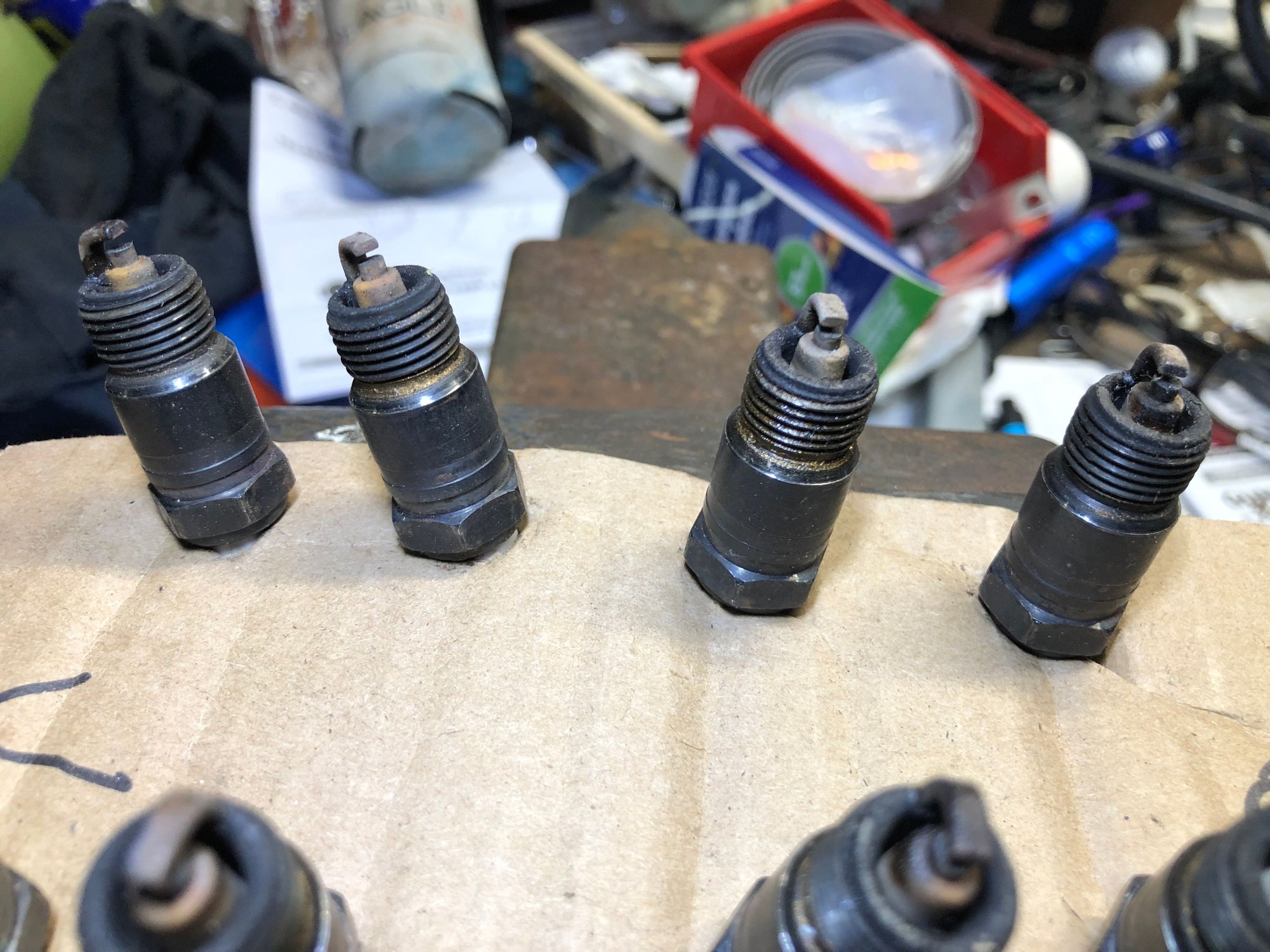

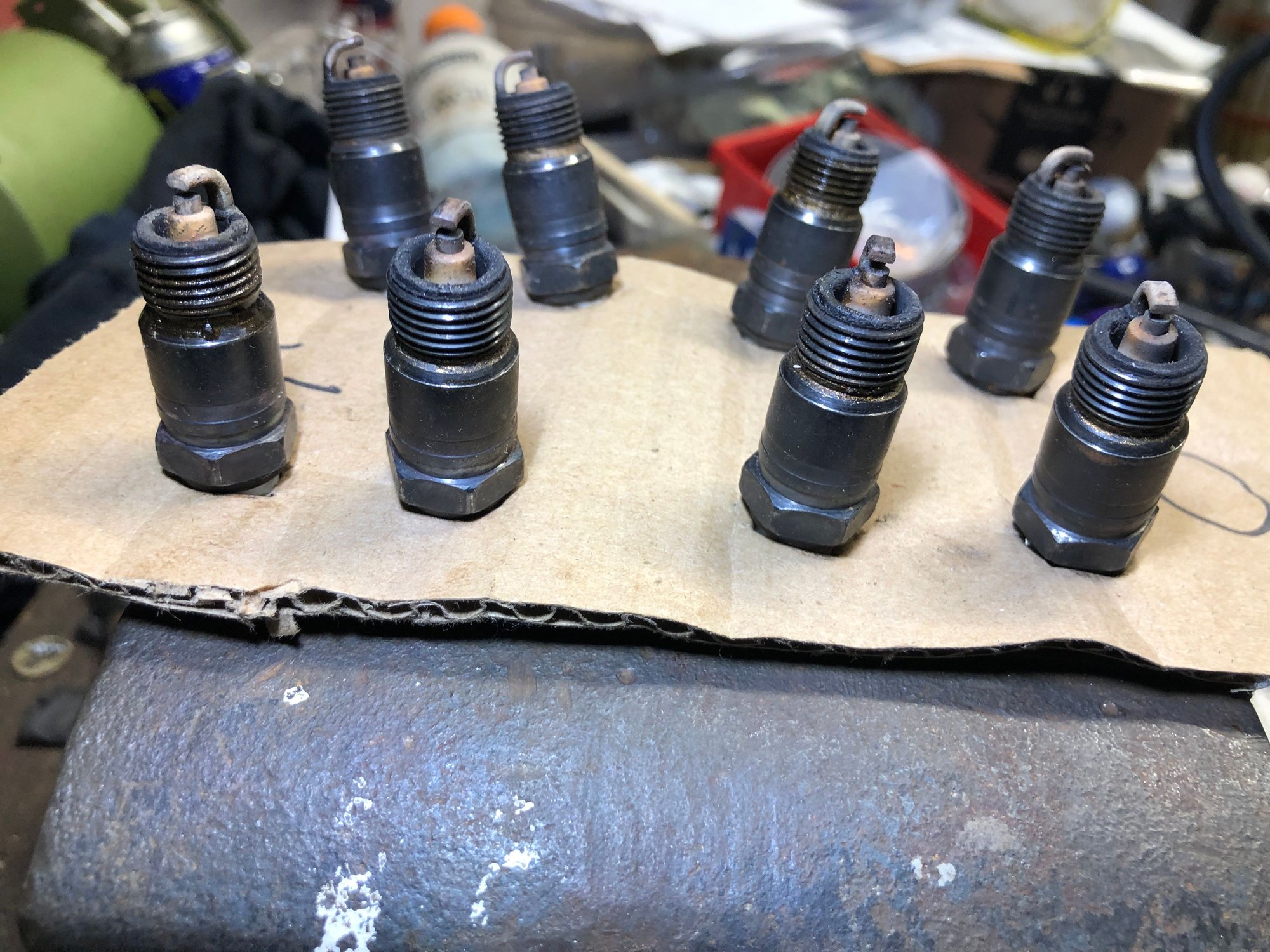

When I was trying to find #1 TDC I bumped the engine around with my compression tester in #1 hole and the cap off. I knew where the rotor should point. As I came around pressure built as the rotor got close. I removed the tester and put the rod in the spark plug hole and cranked the motor around with a ratchet by hand until the rod was captured, then painted a mark on the damper. I repeated the procedure and got back to the same spot. I assume the damper is keyed so I'm not sure how it could be so far off, even if it slipped. Is there another big block engine that this damper could be from that is that much different from my engine?
As far as the removed plugs, they don't look too bad. And the cam condition is unknown. When I first got the car I removed the intake and reinstalled with fresh gaskets and that made an improvement.
The plugs

Is #8 the one that has the miss?
Those plugs look eh, ok. rich running perhaps but nothing glaring. They also look relatively new or with not a lot of miles on them. #8 look the richest or most contaminated vs the others.
Hard to read those dark colored plugs.
However they all look to have a pretty good covering of soot on them. Some appear to have a little oil contamination maybe as well. #1 perhaps oil on the threads or that could be just antiseize. #5 looks to have slightly more carbon build up as well.
