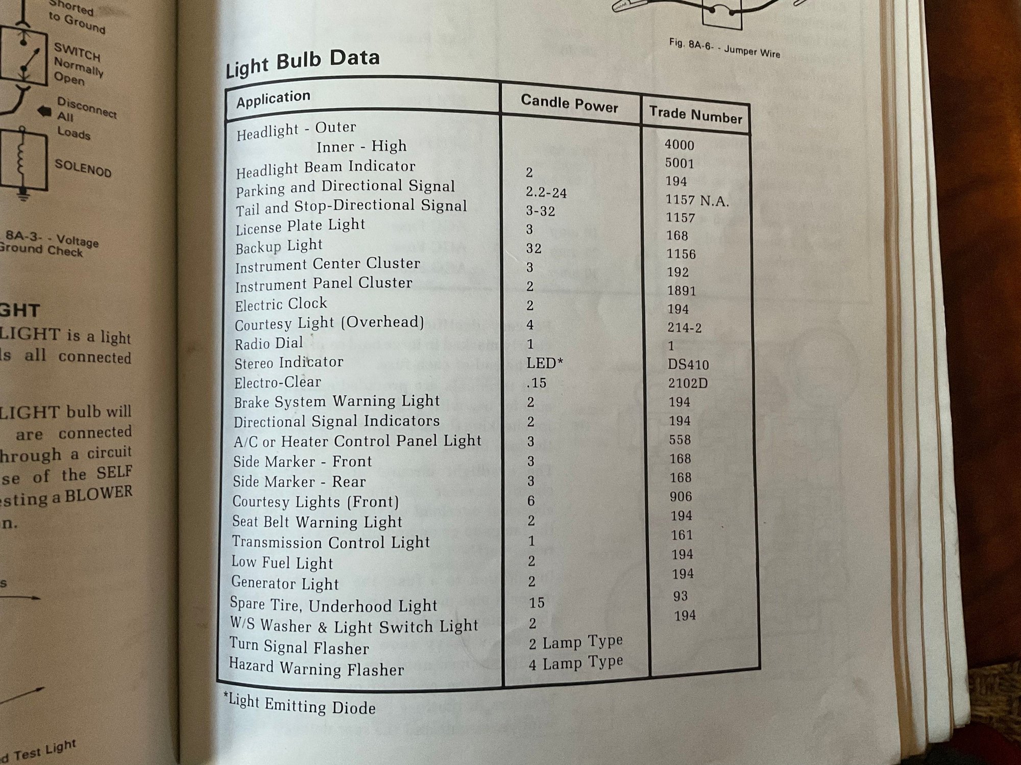

Can you switch out 1895 bulbs to BA9S for more brightness- do they dim with light switch? Thanks

Two of your dash lights are 1891 bulbs. New GE incandescent bulbs are much brighter than ones that have been in use for years. Their useful service life is over long before they burn out. LED bulbs are redesigned as often as iPhones; about every two years. Newer LED’s are not polarity dependent, have thermal resistors and work with dimmers. Best to have all the same types on the same dimmer circuit. Great educational videos on different led types at headlightrevolution.com.
Some people like very bright dash lights, but my night vision seems to work best with the dash gauges barely visible. I do love LED backup lights!
