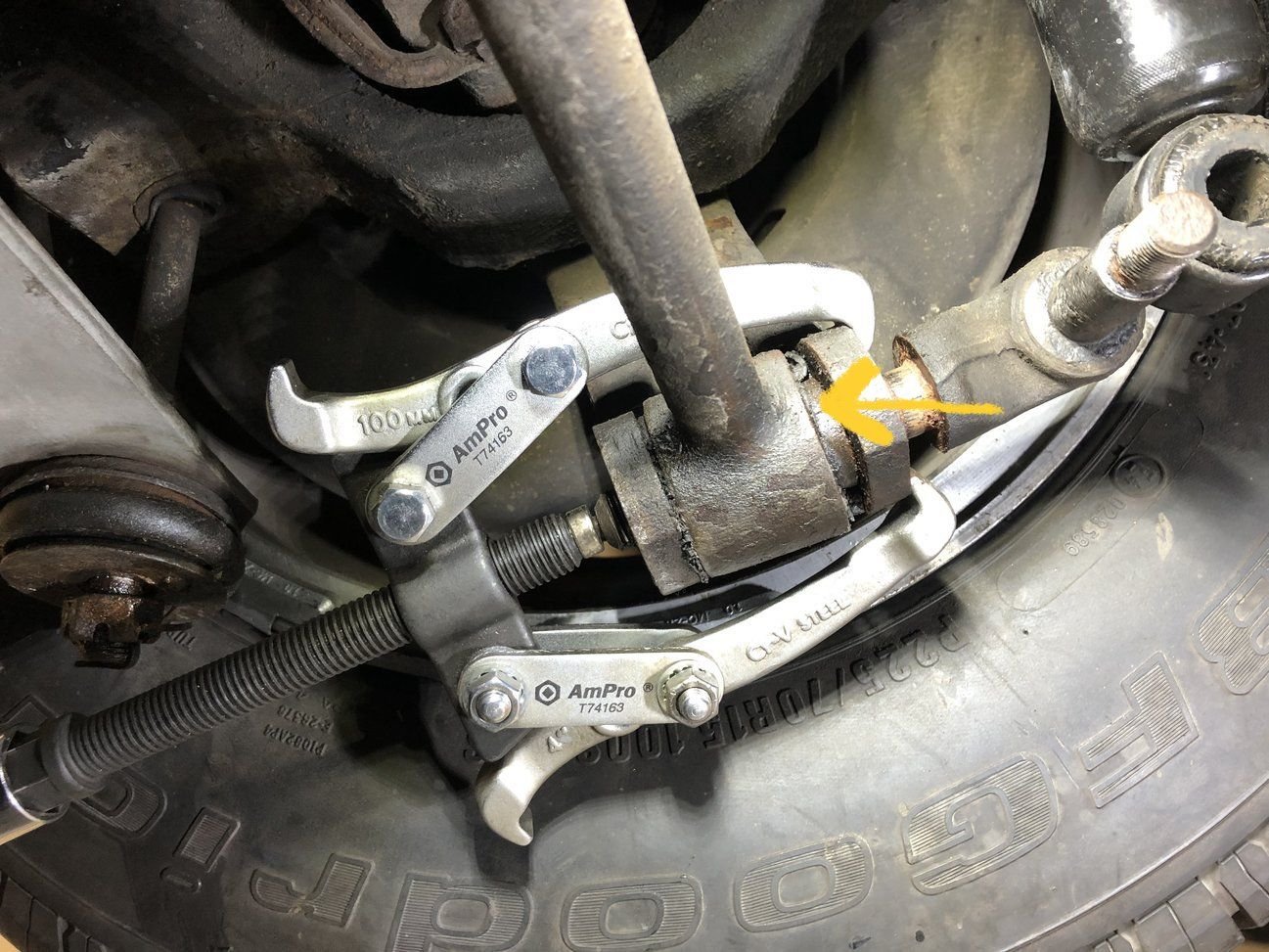

Trudging forward with disassembly, what are the odds the bottom strut rod pin/shock mount comes out? So far it's looking like I'm going to be cutting the strut rod. yay. Going to let it soak overnight. We'll give her another shot tomorrow.
move or cut away rubber to access that metal barrel under the rubber, that is the part holding it.
drill small hole into barrel but no further and put penetrating oil so it gets under barrel.

Unbolt the strut rods at the center bracket under the diff and take the rods out still attached to the shock mounts and trailing arms. Then use a press to push the shock mounts out. You'll need a helper to hold everything in position while pressing.

Don't cut rods ,, unless you already have new ones. They will come out the way others have said... Patience!!!

I didn't have to cut the rods, YAY!!!!!
