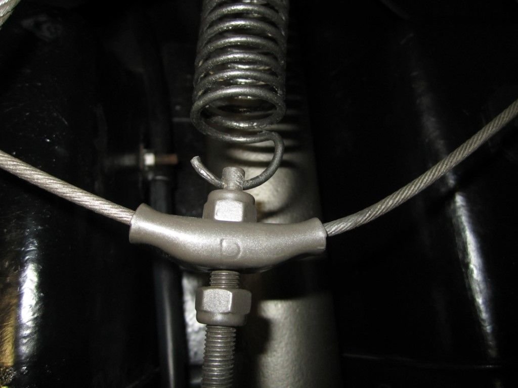

Ignore the wrong nuts, finish, etc but more or less this is what it would have looked like
M
Thank you. ill take a look at mine again in like an hour

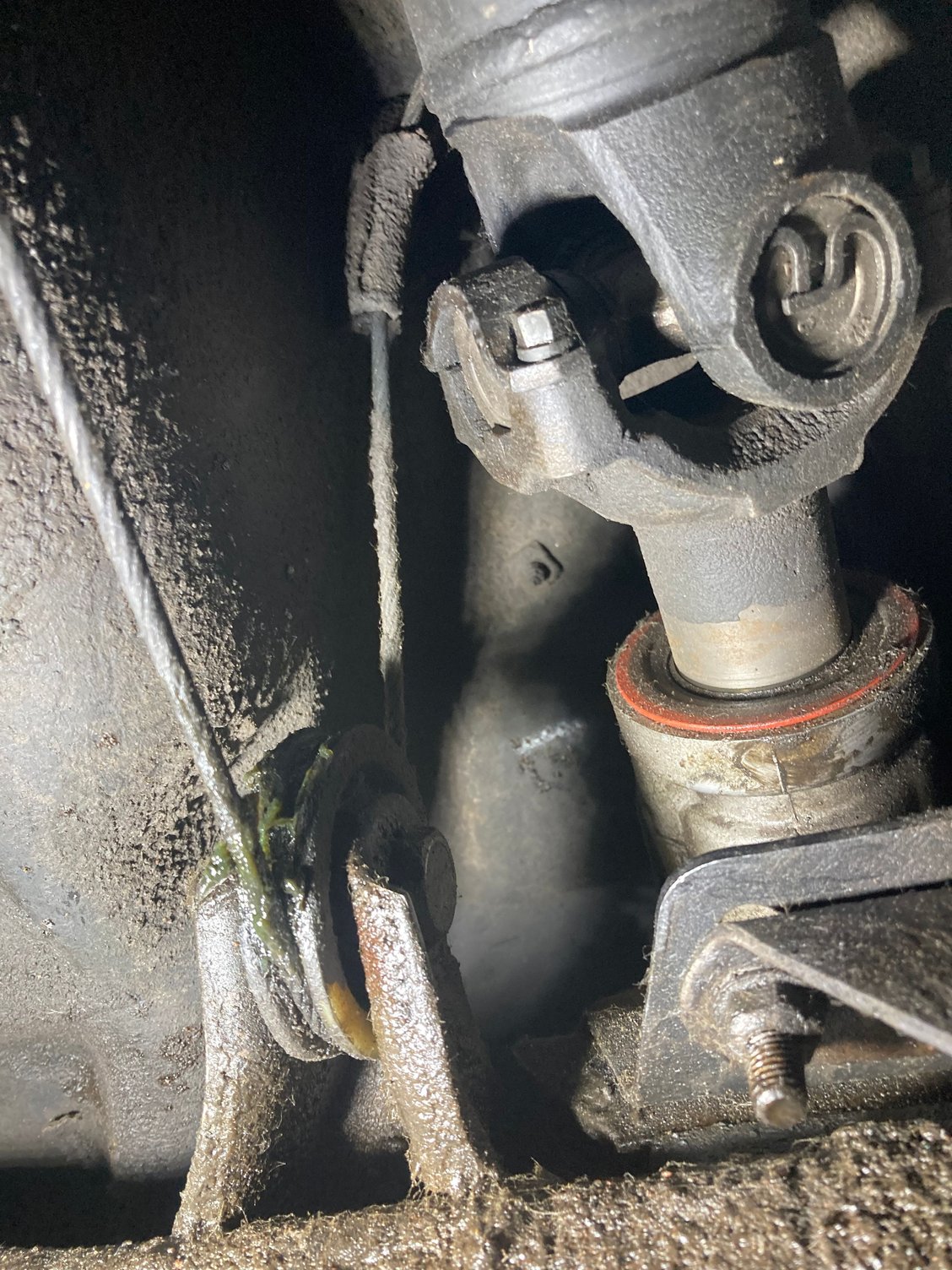

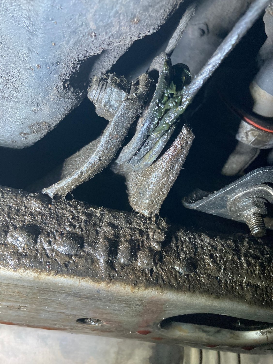

Are these pics good?

Those pics show an unmodified cross member.
Moving the joiner up is your only chance to get it working again .
