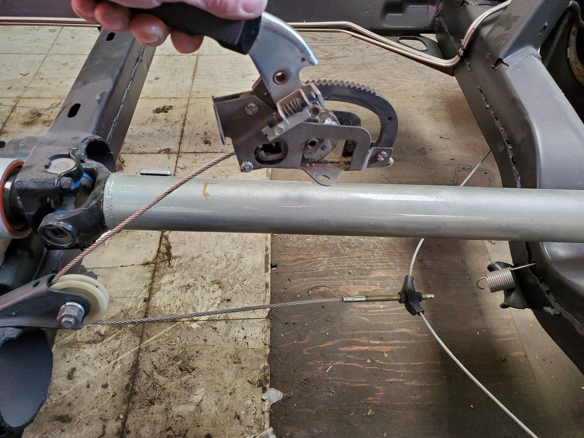

The problem is right now that the rod doesnt reach the cross-cable. Even when I use ratchet straps to pull the cross cable, the rod doesnt reach enough to even get the spring through. I feel like im at the point where the stock rod is too small, but the extended rod is too long/doesnt cut the slack for the cross cable. I don't wanna have to cut the cable with the hole, but I don't know how I can get around it.

It sounds like you have the wrong length cable, perhaps from an earlier year.

As above,
"At some time someone put that extender on so just try to figure out if it was needed due to wrong cables / setup / incompetence"
Once you know what's wrong then you can make the best choice to move forward, you can only cut then end of that cable off once.
Try to see if it's the cross cable or the main one, check the distance from the end of the cable tip where the hole is to the frame where the spring connects

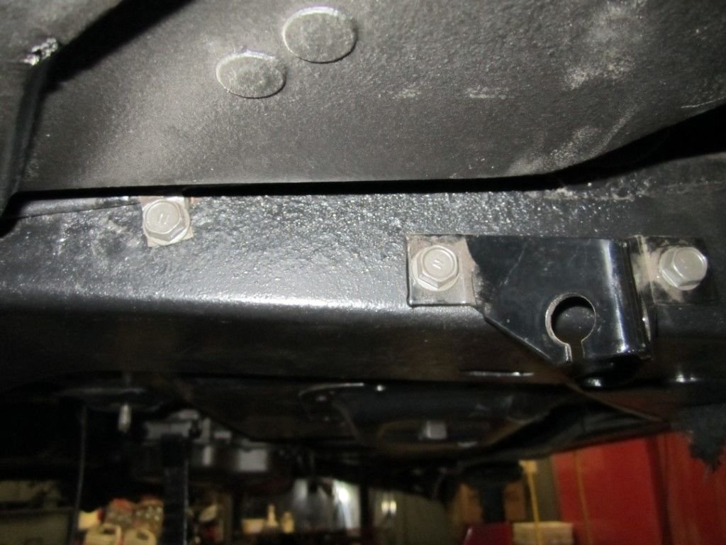

Ok so I lost my phone yesterday and I will post picture later where to loosen the cable but I will explain it again
follow the cross cable back on both sides and you will find the brackets that hold both sides of the cable if you loosen one side
of the bracket and flip it down it will give you more room on the cable usually you only have to do one side
once you get it back on flip it back up and secure the bolt

Ahhh, I think you're meaning these ones? (except there's no cable in this one yet)

Yes … you got it just swing it down on both sides as needed

Not yet, will work on it today. Yesterday was spent fixing my cars locks. I have a suspicion dropping brackets will not be enough though. I used 2 ratchet straps to try and pull the cross cable to the brake cable, but even at full strength it wasn't enough. If I do get it to hook up for some reason, then the brake will be engaged at rest. Il try though
