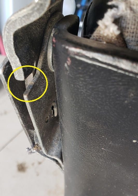

Originally Posted by LRVETTE
1980 Corvette issue with seat. I am not that comfortable with the seat reclined back so far and understand their are parts that can adjust the incline/decline of the seat? Anyone have experience?
I don't think there is an adjustment, but take a look at the hinges.
Photo is from an original seat from my 80. When "upright", the two bits of the hinge in the circle touch. Your hinges may be bent and not connecting. Or you may be able to add a shim to keep you a bit more upright.
