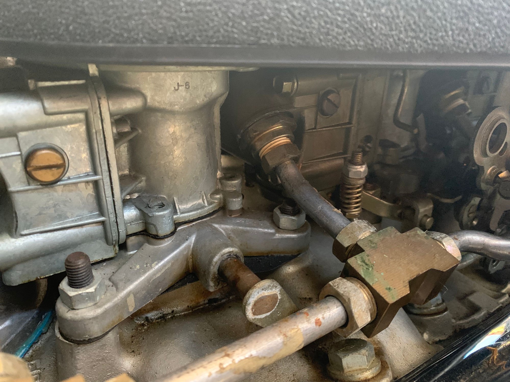

forgive my lack of knowledge… but which way do you turn the little screw on the middle carb to make it idle lower ?

Old Mar 1, 2022 | 12:56 PM
randy ransome's Avatar
randy ransome
Joined: Nov 2004
Posts: 3,220
Likes: 473
From: Olive Branch Mississippi
Winner 2020 C4 of the Year - Unmodified
2018 Corvette of Year
2017 C2 of Year Finalist
2015 C4 of Year
Turn it to the Left to slow idle.

Do you have the Idle solenoid on the center carb ? Tripower automatics & Tripower A/C cars had one.

yes there is. i just drove it around the block. died at every stop sign. backfired like Uncle Buck and huge cloud of black smoke out the back. Starting off well. it’s put away now. not driving it til a pro sees it.

there’s a pool of yellow/black fluid on top of the block
