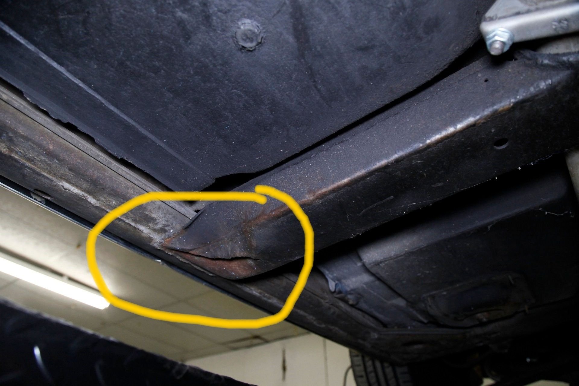

Biggest issue I see is the damage to the passenger side of the cross member shown in this pic:
I'd keep looking Jim. I generally find the best cars or the best deals can be found by dealing direct with an actual owner.
