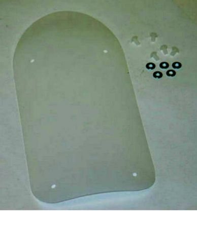

There is a plastic shield under the shield, held in by 4 plastic rivets
M
https://www.corvettecentral.com/c3-6...-rivets-473013

Thanks 4-Vette and Mooser that makes sense. I can see the benefit of the plastic shield (insulator) above the ignition wires and also where the grommet sits. Not sure I want to squeeze the wires together through that hole, but realise that's original.
I do have AIM and many other books so realised I was not looking at missing side shields like sbc. Thanks everyone for your help.
